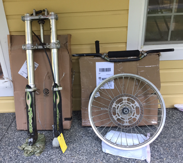

Donor parts have arrived. Time to get to work.

What year forks did you get?

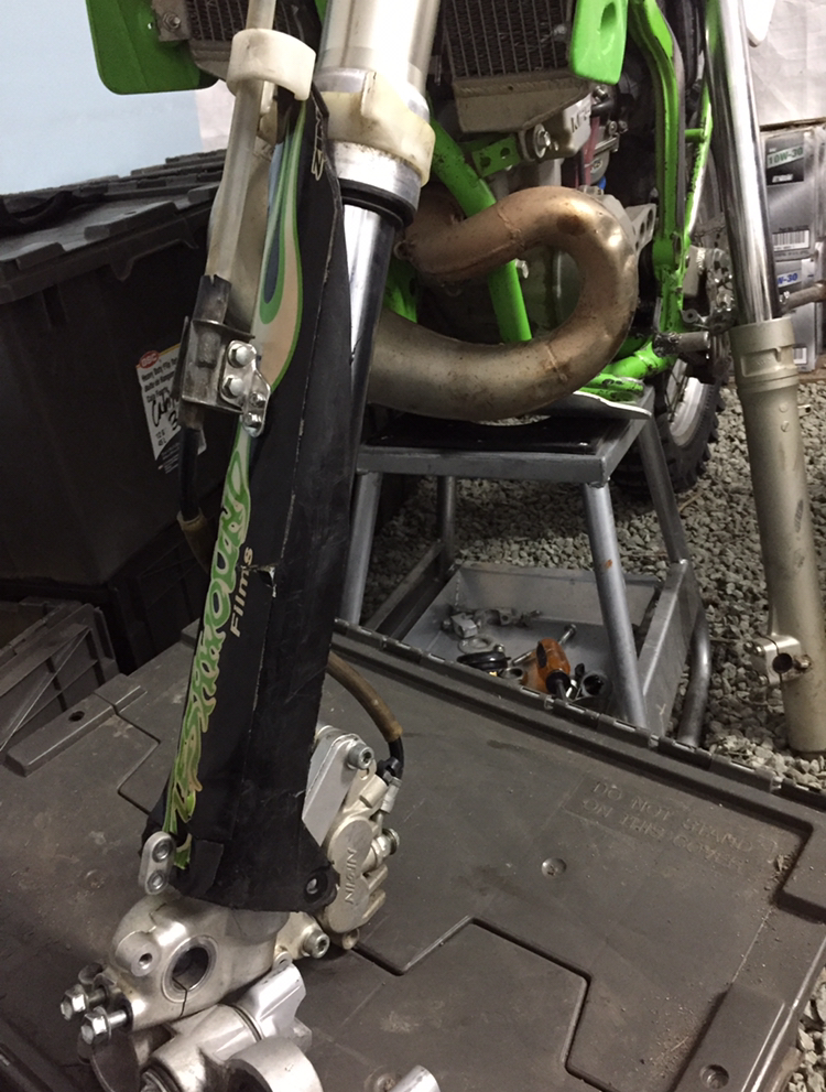

You're gonna' love them. One tip, your KDX front brake caliper will probably bolt right up allowing you to reroute the brake line so it no longer goes under the fork. You'll have to fabricate a mount for the KDX brake line clamp onto the fork guard. I tried a couple of different ideas but finally settled on a piece of aluminum "L" stock from Lowe's. Cut to length, drill holes and mount. Works perfectly. I rivited mine to the fork guard with aluminum rivets from the back side of the fork guard so it wouldn't scratch up the forks.

The forks are from 2000. The rim and wheel assy is 1997. I thought they’d be a married set. But oh well.
Plus you will note a fresh set of seemingly straight protaper handle bars.....that might take some getting used to.

Re: Joining the Club (KX125)
May not be the best photo but what I had. I bought a 3' piece of aluminum "L" stock at Lowe's. I forgot what size but I took the little Kawasaki brake line clamp with me to Lowe's to be sure I got the best size. I think it was 1" but not sure.
Then just cut off a piece long enough to fit the little Kawi clamp. Drill holes in the "L" stock piece to allow for rivets and to mount the Kawi brake line clamp. I rounded the edges of the "L" bracket piece on a bench grinder to eliminate sharpe corners and edges (for my hands when doing maintenance and washing the bike!)
Using a pop rivet tool and aluminum rivets (aren't they all?), rivet the bracket to the fork guard from the BACK side of the guard so no rivets scrape along your forks as they move.
This has lasted for about a year or so through the National Enduros and some local HS races.
Alternative is to find some fork guards that have the brake cable holder already molded in place and can be modified to fit the KX forks. I didn't find any.
Done!

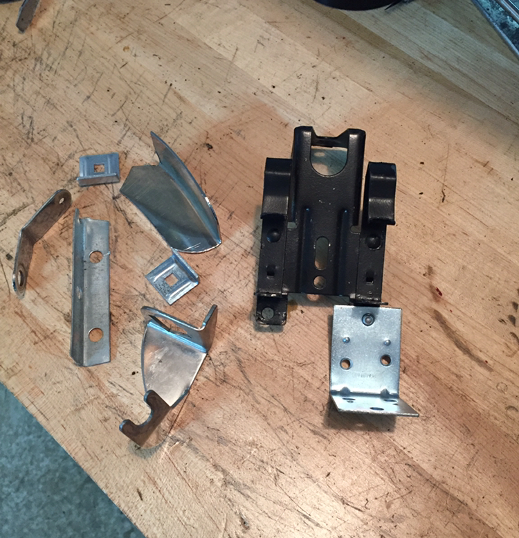

Now, I gotta dig through my spare metals bin to see if I have the makings for a fancy brake line bracket to match the Doakley clamp.

Plus I may not even need a trip to Lowe’s. I have found a fine selection of bracket candidates, and even looks like I have the one for direct copy of Doak. It has even been rivet tested for some reason I can’t recall. Probably just showing my kid how to use the pop gun.

There you go! You should be able to fabricate up something from all that.

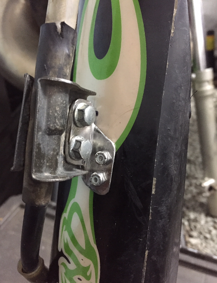

And the winner is kick down cable bracket from TH350.

Fitcheck looks like it should work.
