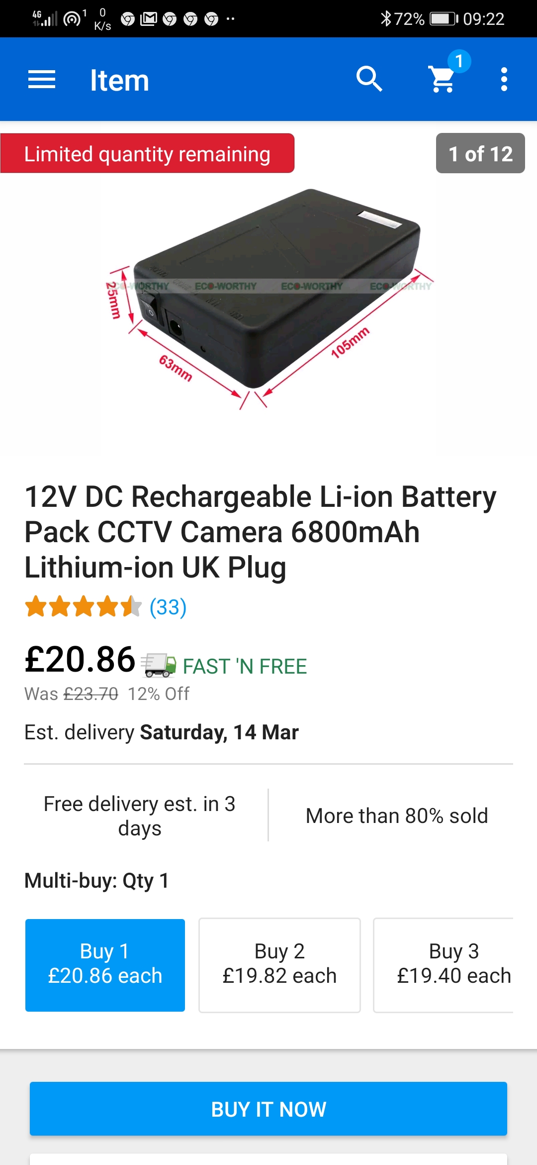

Hi all.
Been looking on here a bit now as going to do the DC electrical conversion. And the information is very helpful.
The last bit of my puzzle is where to put the battery?
Ideally it would go in the air box, but I am finding out that small 12volt 6ah batteries are hard to find.
I am still very new to all of this and this might seem like a idiot question, but can I use this battery with some adapted connections.??
I am going to run a nice set of led lights, indicators, and horn, brake light too.
Any help greatly appreciated

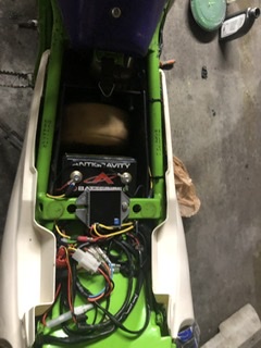

I have mine in the airbox but thinking of finding new spot.
- CFA464DE-D13B-41E0-B362-3BD0D66922EE.jpeg (31.2 KiB) Viewed 6079 times
