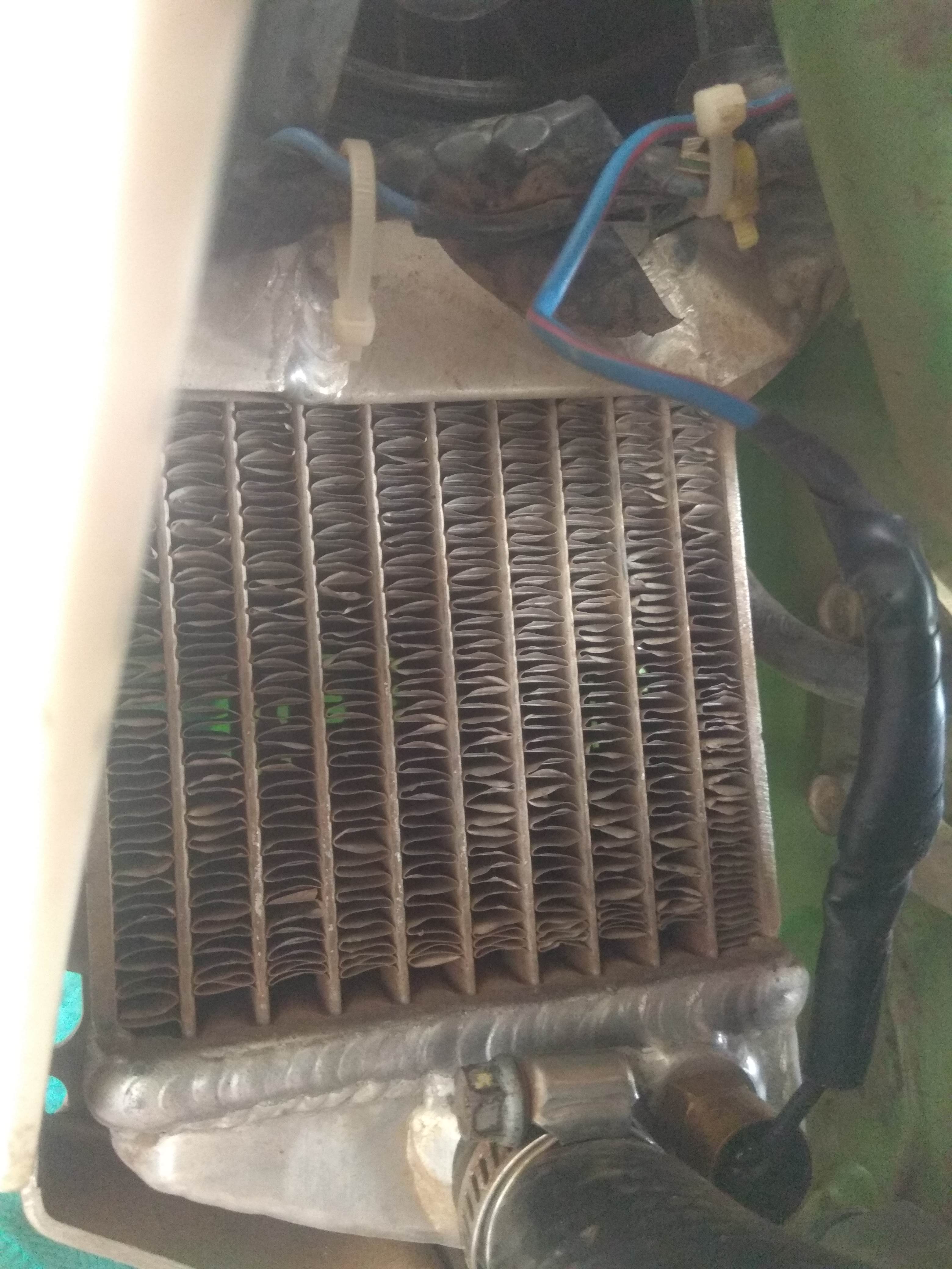

Water pump was rebuilt by me with a new impeller (not when I bought it). Won't run at all with the choke on but needs it to start. I'm running a snorkel from a kawasaki boss 175 which is about 10 percent bigger than standard. ( I WAS GOING TO DO A WRITE UP ON IT AS HUGE IMPROVEMENT OVER THE OPEN AIRBOX) Was running a 142 main jet but changed to a 135 a few days ago. No change in power but smokes less with the 135. It doesn't have a thermostat. I've been through the whole cooling system quite meticulously, I'm wondering if the Chinese radiators are not as efficient as the OEM ones. With mine having the High out put stator I might try running 3 or 4 fans.

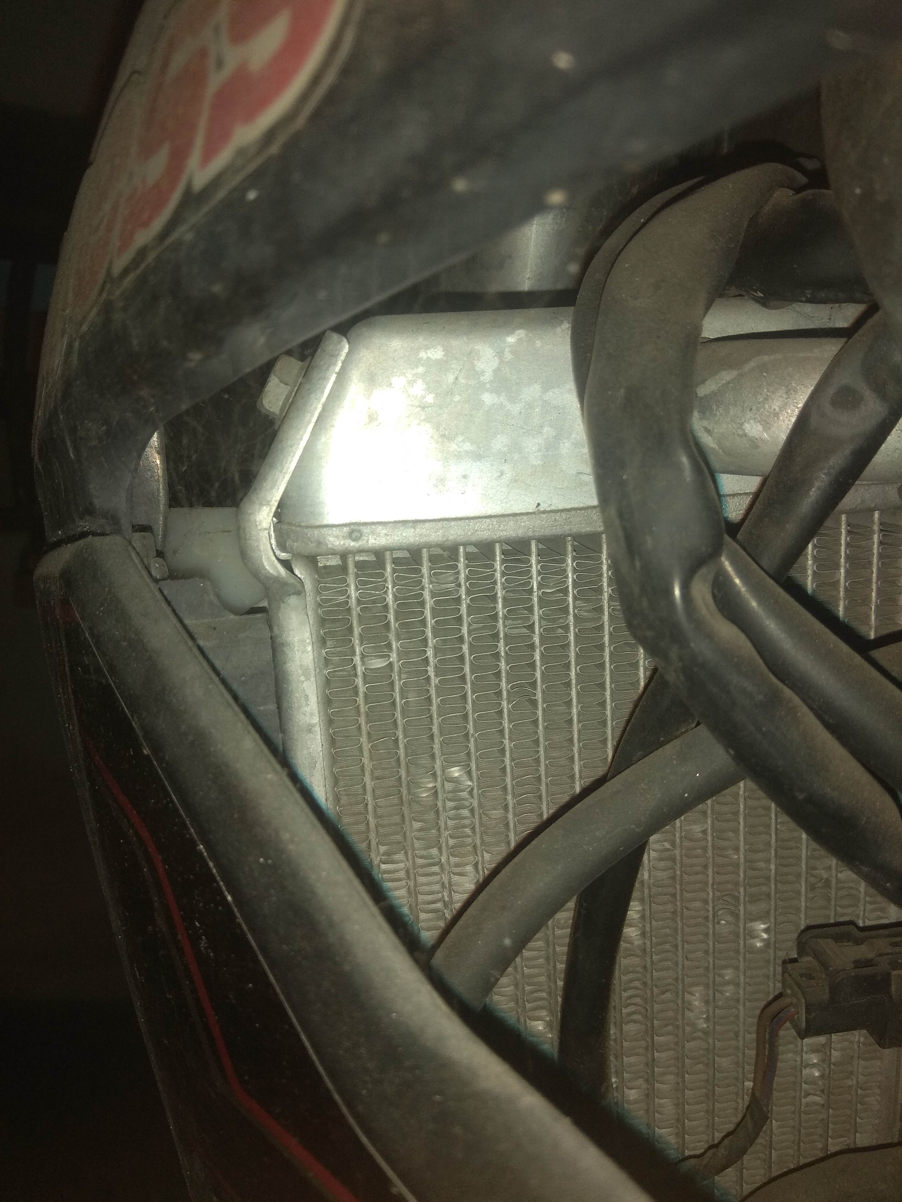

This is my Chinese radiator and the second photo is OEM radiator from a Klx250. Even though they are of very similar dimensions the Chinese radiator has 9 cores and the OEM has 17 cores. This would make a huge difference towards cooling efficiency. Can anybody confirm how many cores the OEM Kdx220 has
- IMG_20200312_172545.jpg (993.26 KiB) Viewed 4290 times
- IMG_20200312_151038.jpg (984.2 KiB) Viewed 4290 times
