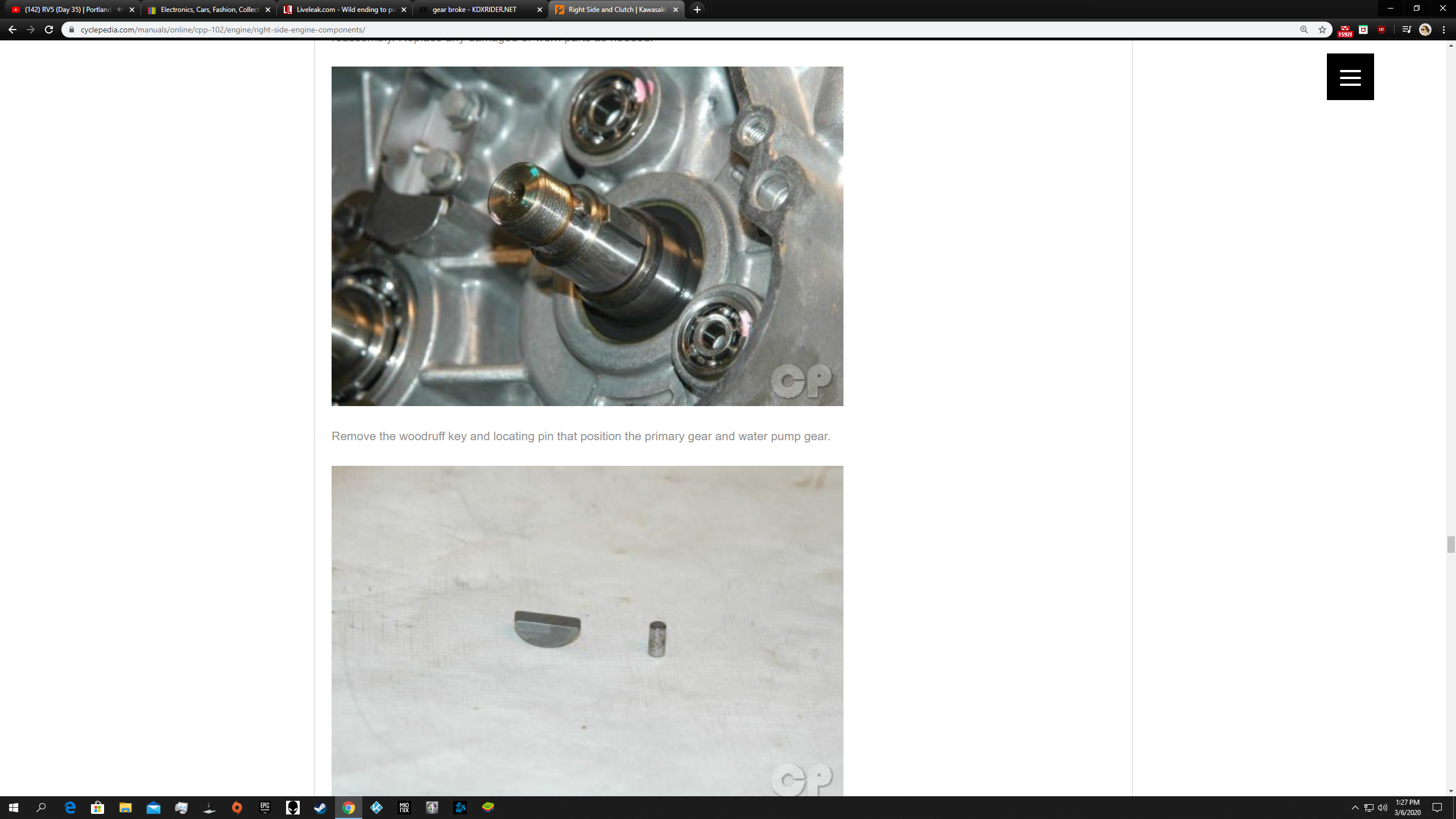

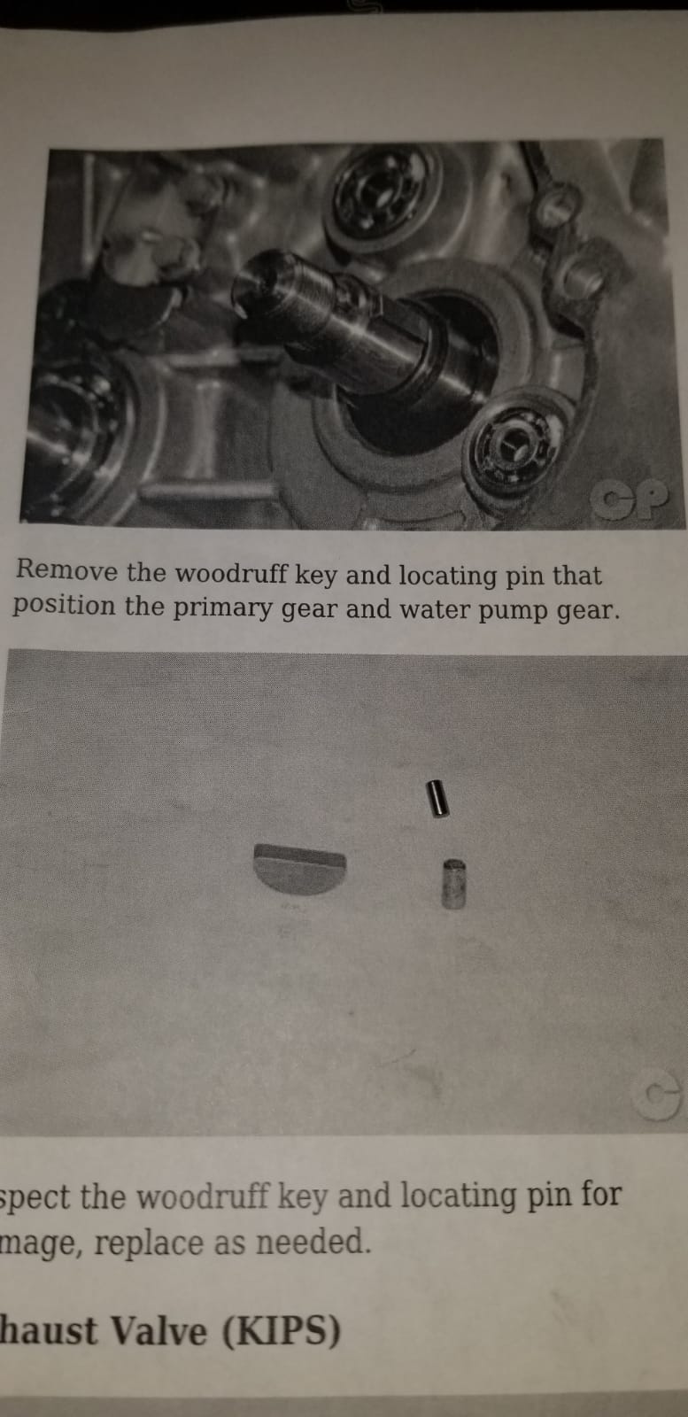

i found it thanks god here a picture and the pin i was takin about
Screenshot (168).png (1.06 MiB) Viewed 6987 times
Posts: 739
Joined: 08:28 am Apr 21 2019
Location: North Cackalack
Re: need some help pls not sure where locating pin go
Post by kdxsully »
Ohhhhhhh the key for the primary gear. And the pin.
He is saying he found the water pump pin. He didn't have the woodruff key missing.

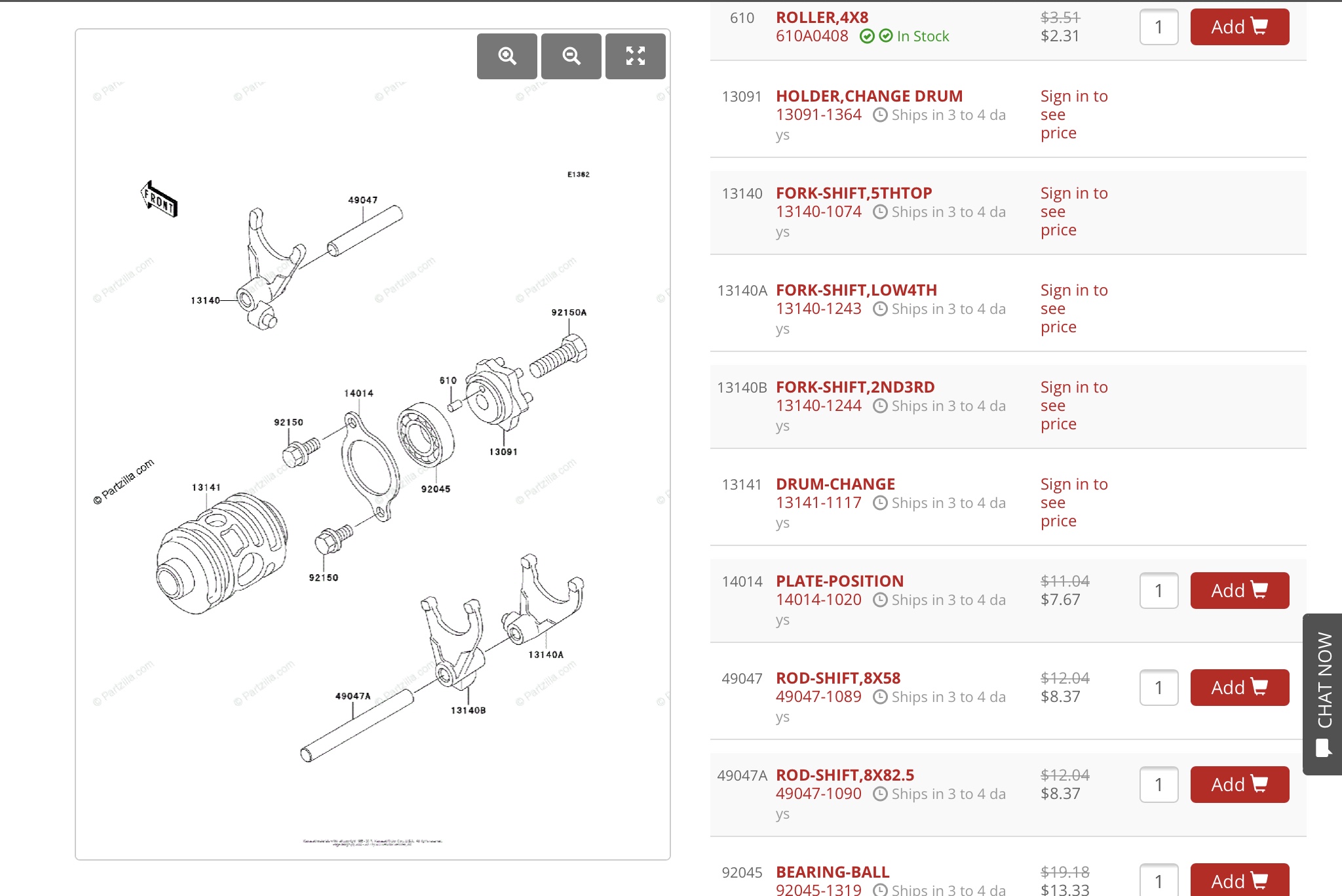

this is the pin im talking about i change my oil 4days ago and saw that little pin
Are you certain it is not a portion of the pin on the KIPS advancer lever? They usually break off when improper technique is used on removing the lever and left hand threaded nut.
0ops_sorry
Posts: 49
Joined: 12:10 am Feb 08 2020
Post by 0ops_sorry »
KDXGarage wrote: 03:00 am Mar 07 2020 Are you certain it is not a portion of the pin on the KIPS advancer lever? They usually break off when improper technique is used on removing the lever and left hand threaded nut.
are you talkin about this one ?? it also broke so i order one yesterday
I am not seeing a picture.
EDIT: I am now. Yes, that one.
