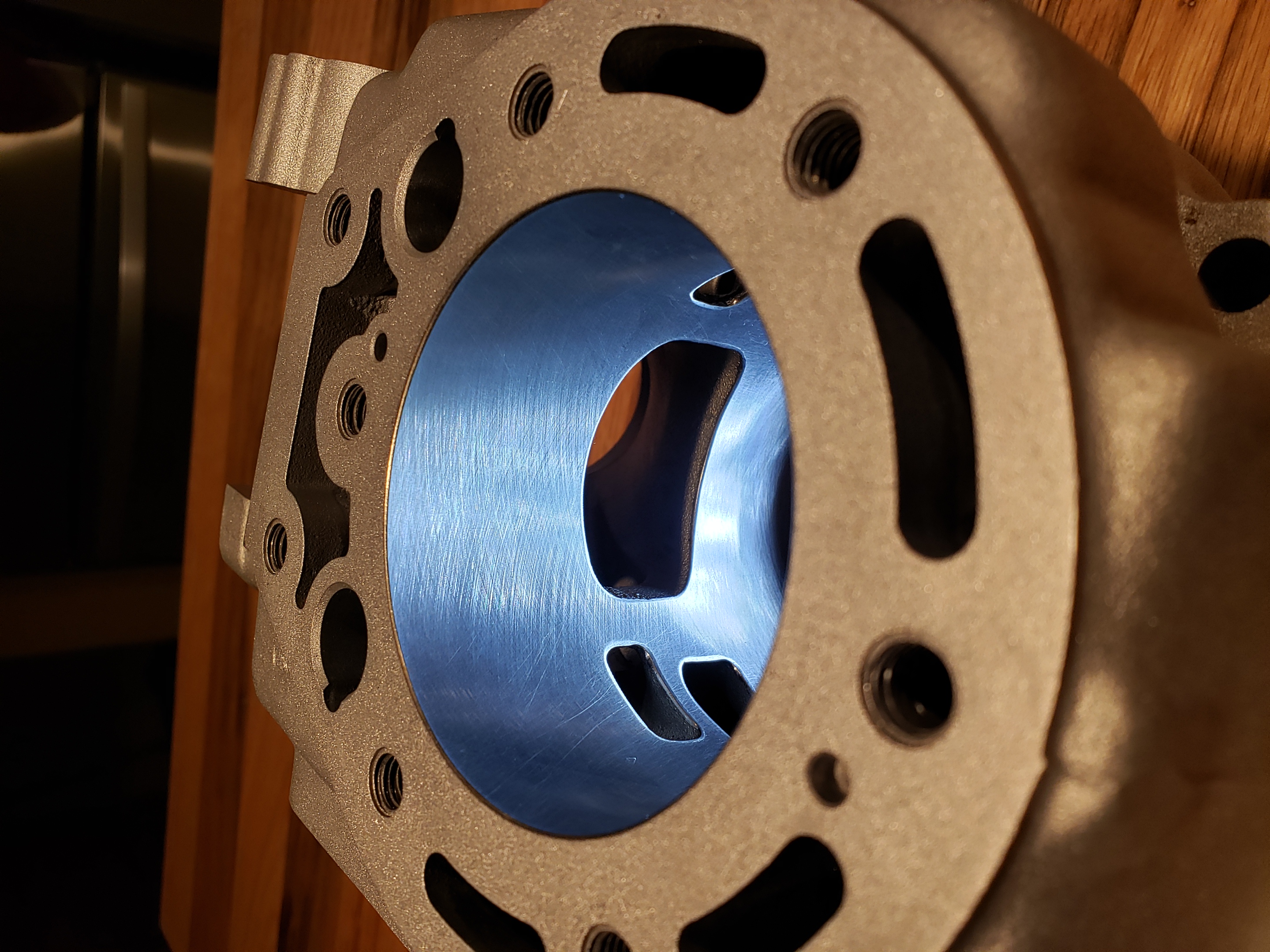

Here's some eye candy for ya.
Re: KDX Cylinder Repair?
Posted: 10:48 am Mar 08 2020
twinsig
post a before and after pics

by Goat
Twinsig , that is some pretty work. Is that your KDX cylinder? Why is it copper colored on the exterior?
Posted: 02:17 pm Mar 11 2020
by Twinsig
Optical illusion I guess prob from the counter top reflection.
