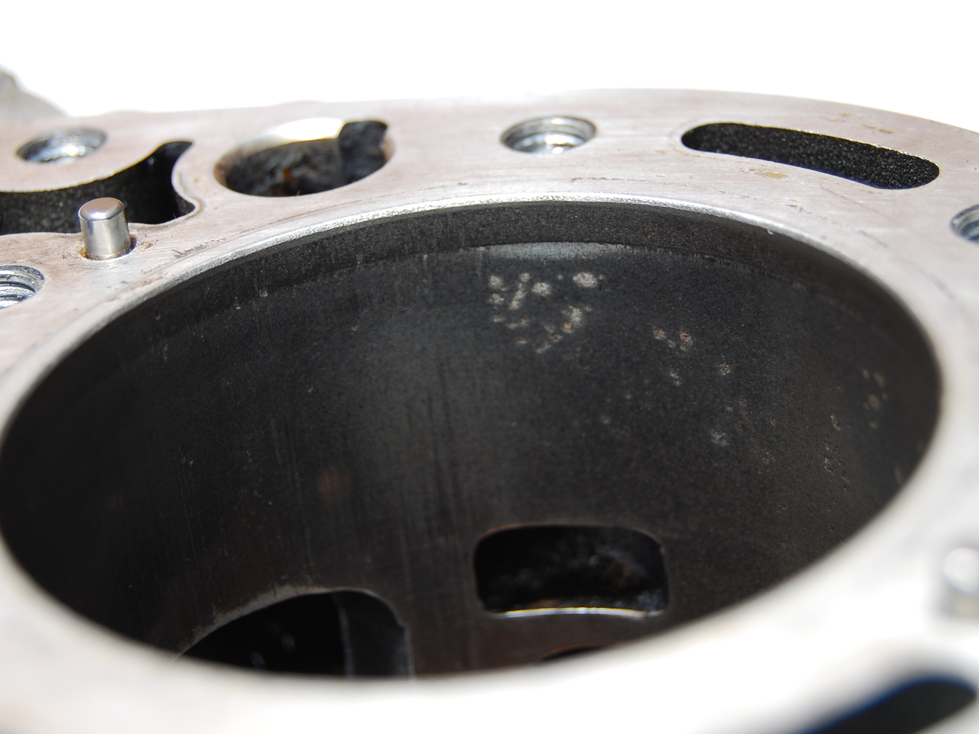

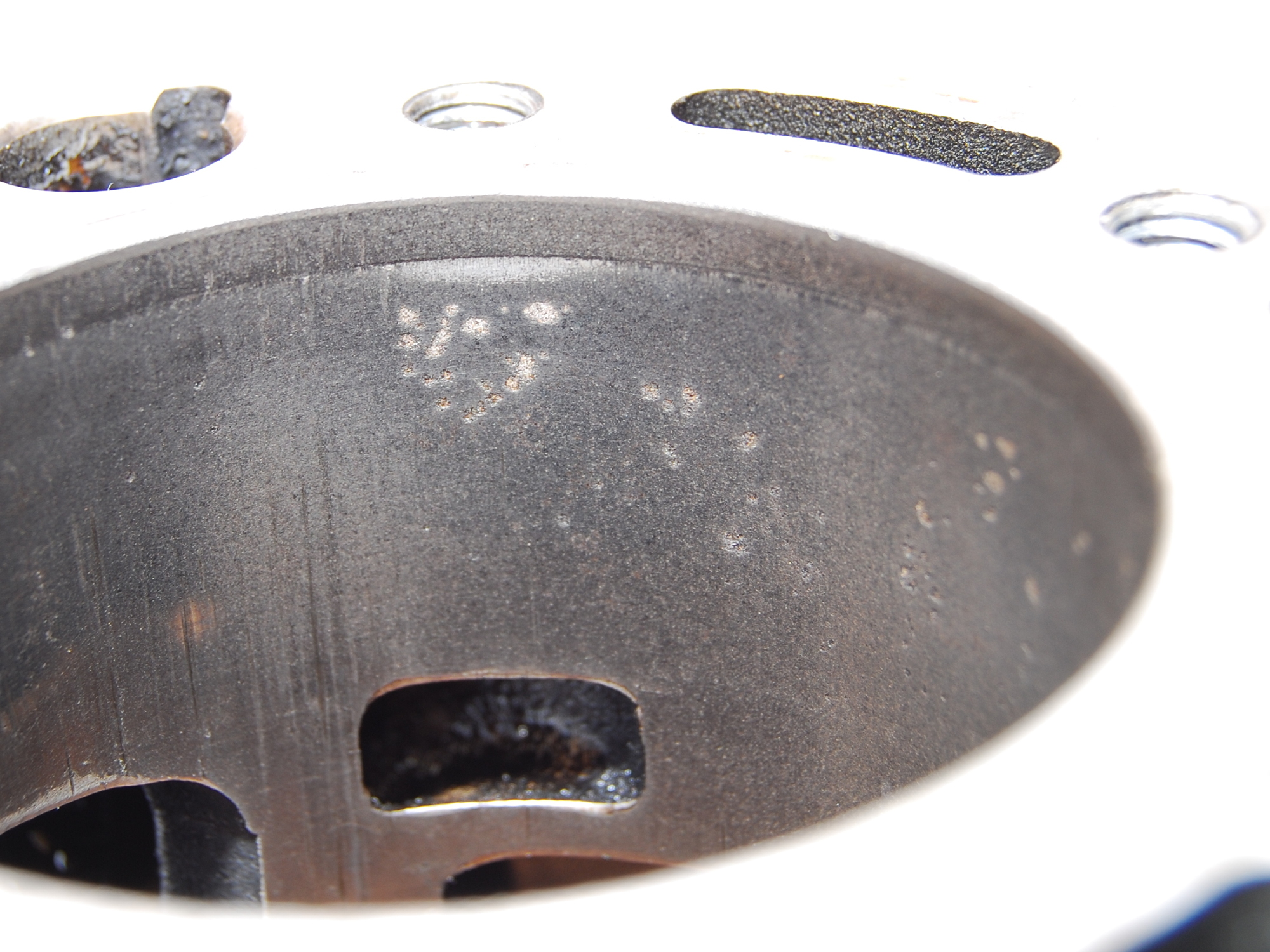

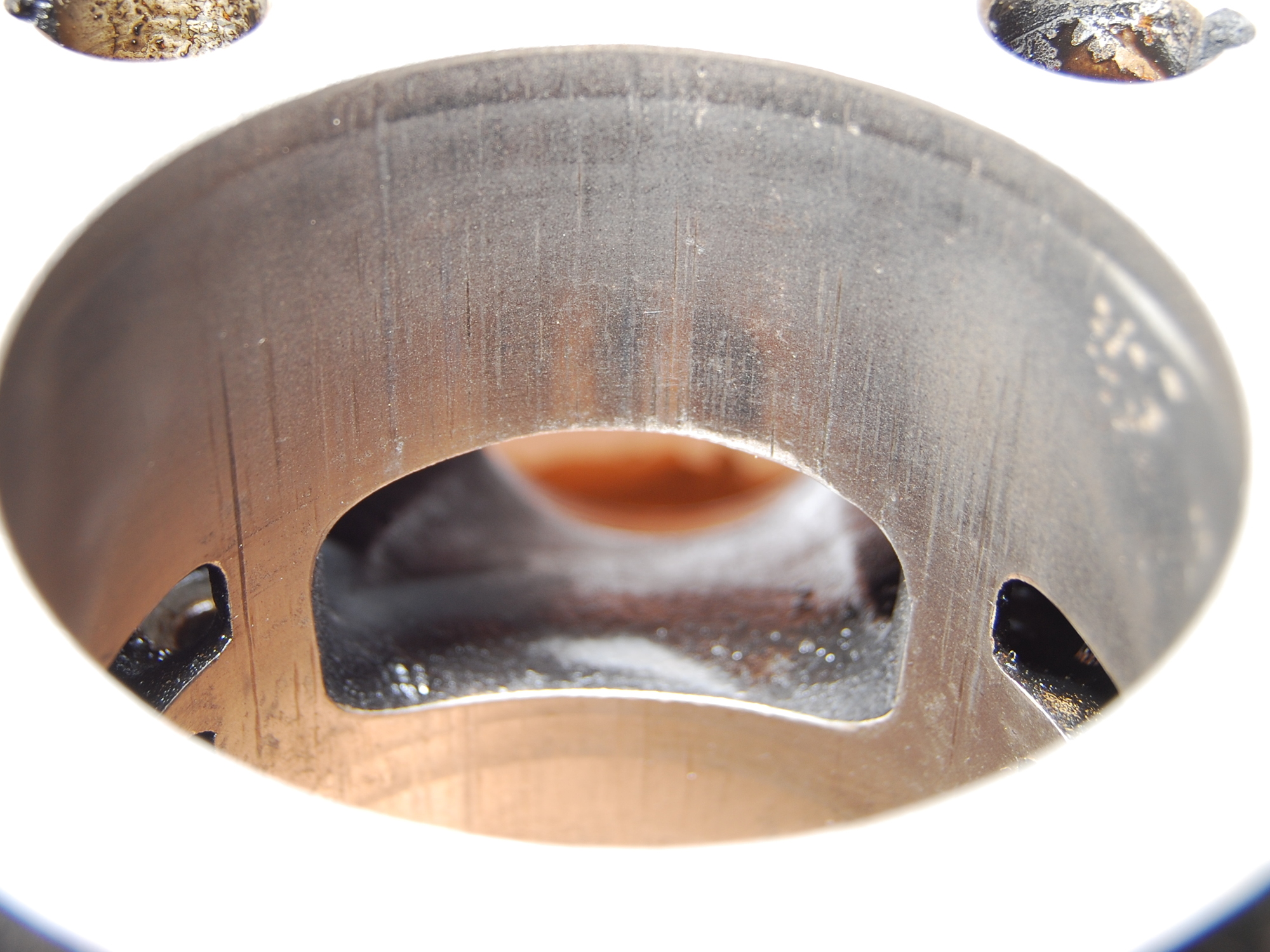

So... Is this salvageable? This is the inside of a cylinder from a 2001 KDX 220. I think I'll email millennium technologies, but was going to see if anyone here had any thoughts as well....
Re: KDX Cylinder Repair?
Yes.
If it turns out to need a repair and replate, you might want to consider the Eric Gorr 223cc upgrade.

- Posts: 6056
Easily salvageable. Eric Gorr, Millennium, or Powerseal can all get that cylinder back in to shape rather quickly.

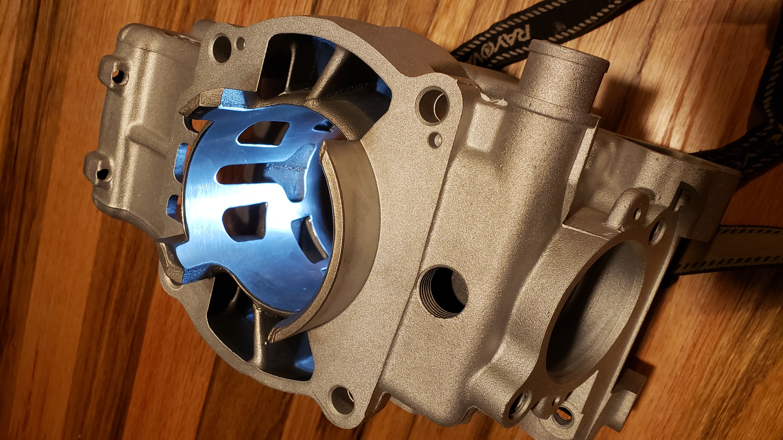

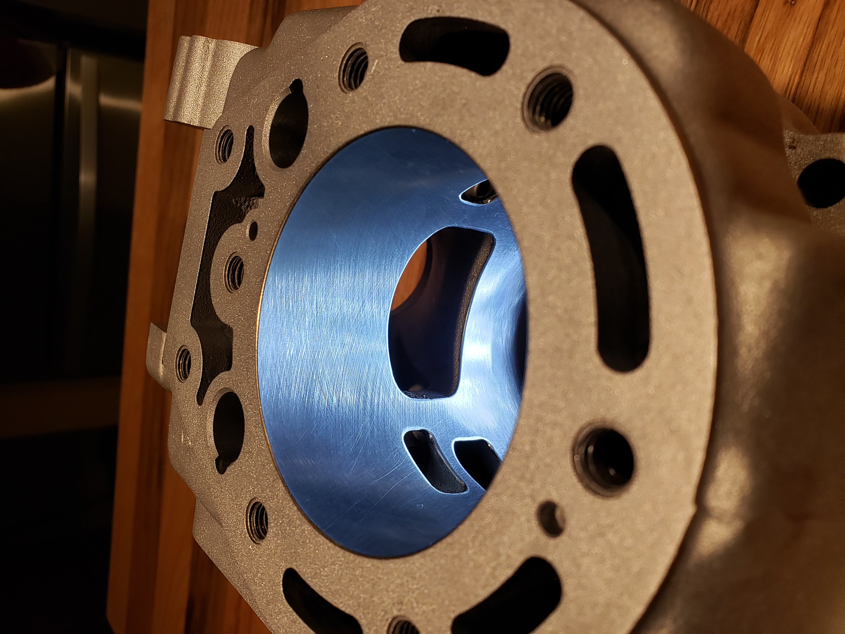

Here's some eye candy for ya.
- 15832885548147255490845597006042.jpg (1.61 MiB) Viewed 8579 times
2003 220R
twinsig
post a before and after pics

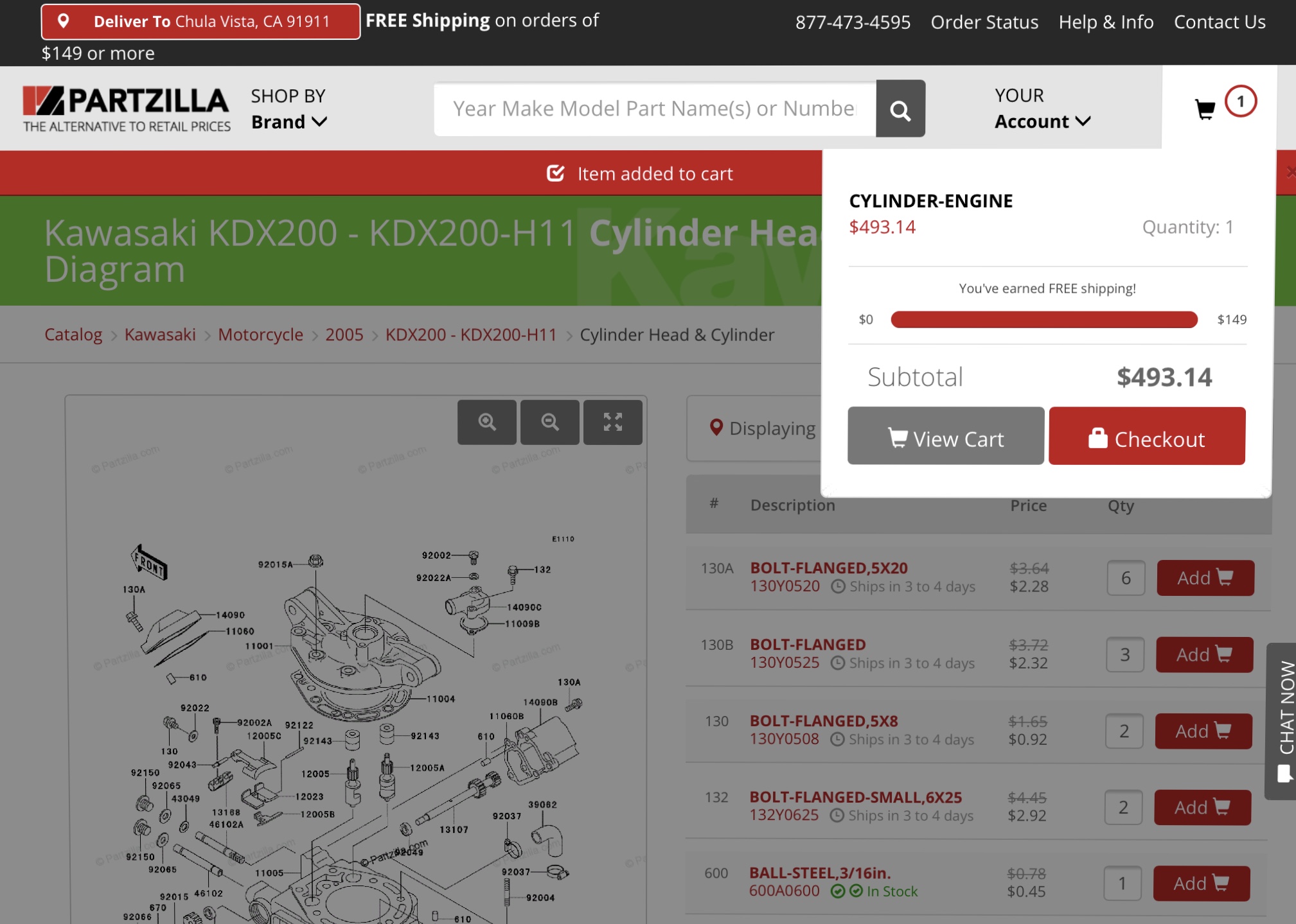

A new ‘95+ 200 cylinder is $493 from partzilla.
Can someone give an idea of the cost to replate a damaged cylinder from millennium? Power seal? Eric Gorr?

If a stock cylinder is not out of round or some major damage, NO WAY would I buy a new one vs. a replate from either place. The aftermarket plating is better than the stock Electrofusion coating.

When I had my cylinder replated Millennium found a crack in the exhaust bridge that needed welding to repair. That $295.95 price is what I paid.

Millennium is by far the best. The Eric Gorr 225 would be nice but I would worry about piston availability years from now.
Like mentioned above there are very few cylinders that can't be repaired. Millennium can fix about anything even if its bad enough most people would think its trash.
Twinsig , that is some pretty work. Is that your KDX cylinder? Why is it copper colored on the exterior?
- Posts: 89
- Joined: 12:02 pm Aug 26 2019
- Country: USA Mid Bama
Optical illusion I guess prob from the counter top reflection.

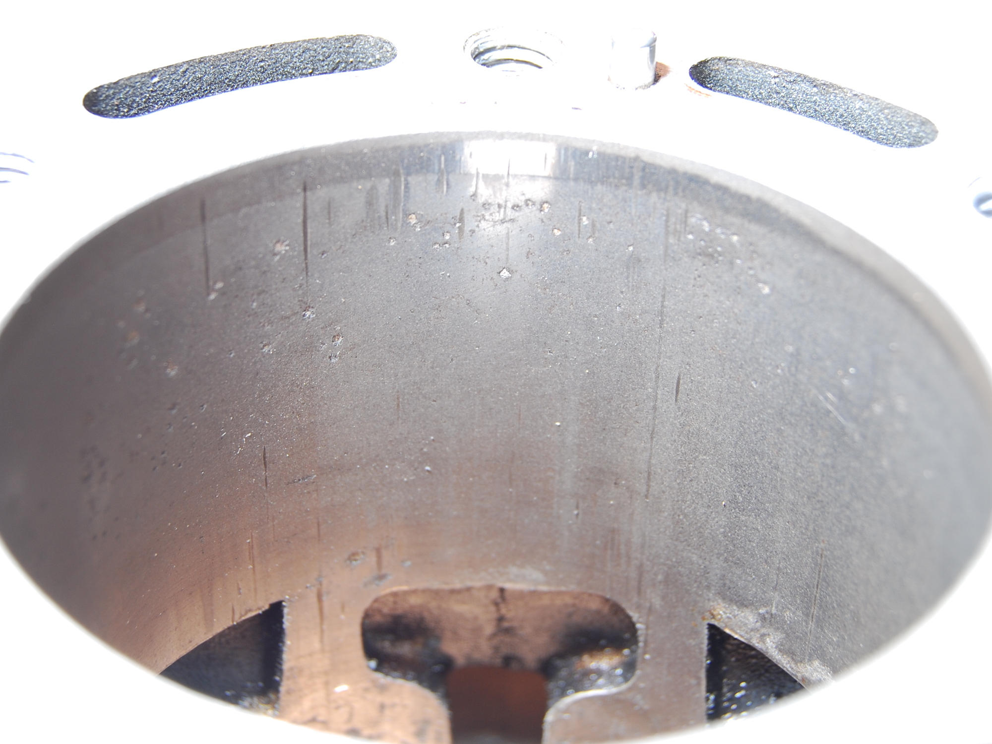

- Posts: 124
I just had Millinium replate my cylinder mine was pretty much like yours there, Kawasaki uses machined slag for their plating Ive had to replate every one ive had. It will come back much better than new even a little bit beautiful i might say I hated to use it it was so pretty!!! They charged me 290 for a little welding and replating yors looks pretty much the same as mine, On the brighter side it should last many years to come.
