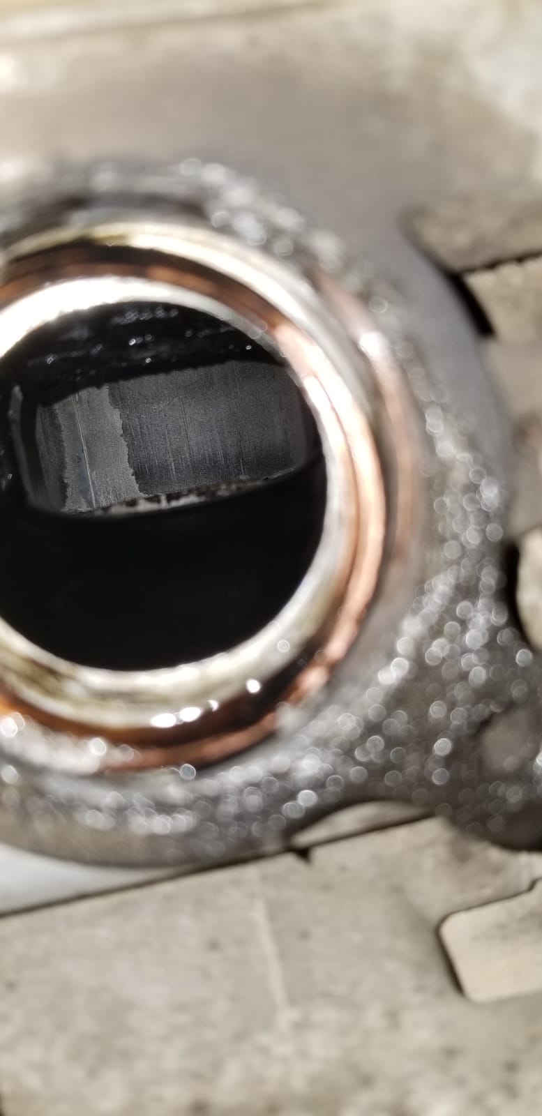

look like it need to get it repair or no ?? psi was 150
Re: my cylinder wall need repair or no ??
If it were mine, I would be assuming it needs to be repaired. I would pull it apart and further investigate.

I’d pull it for sure.

IMO that looks really nasty. That would definitely warrant pulling the top end to see what it needs.

Yes, Plating is worn through with visible scoring.

Should be able to get it repaired/replated by any of the services that specialize in cylinder plating

That cylinder is trash btw.

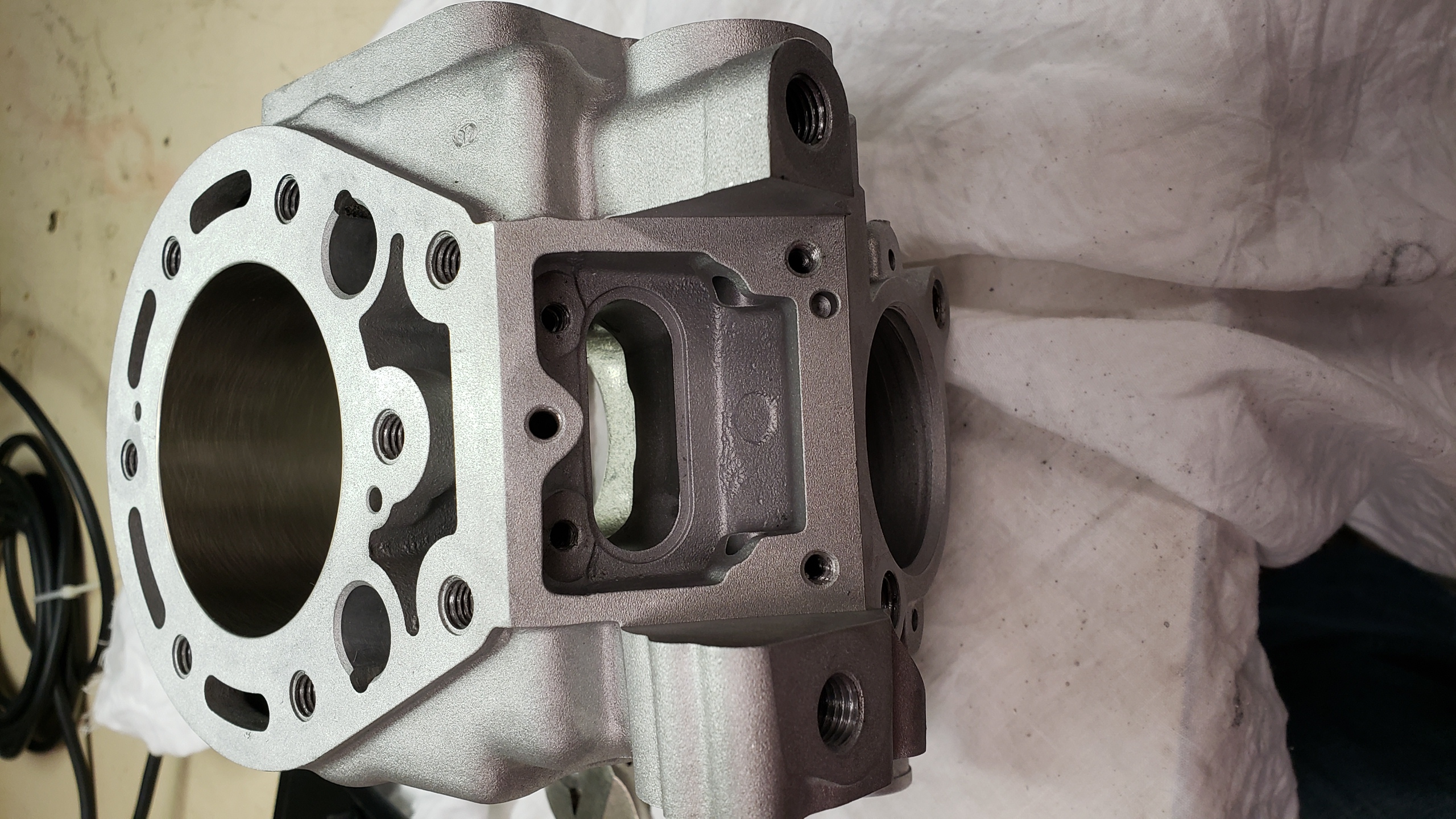

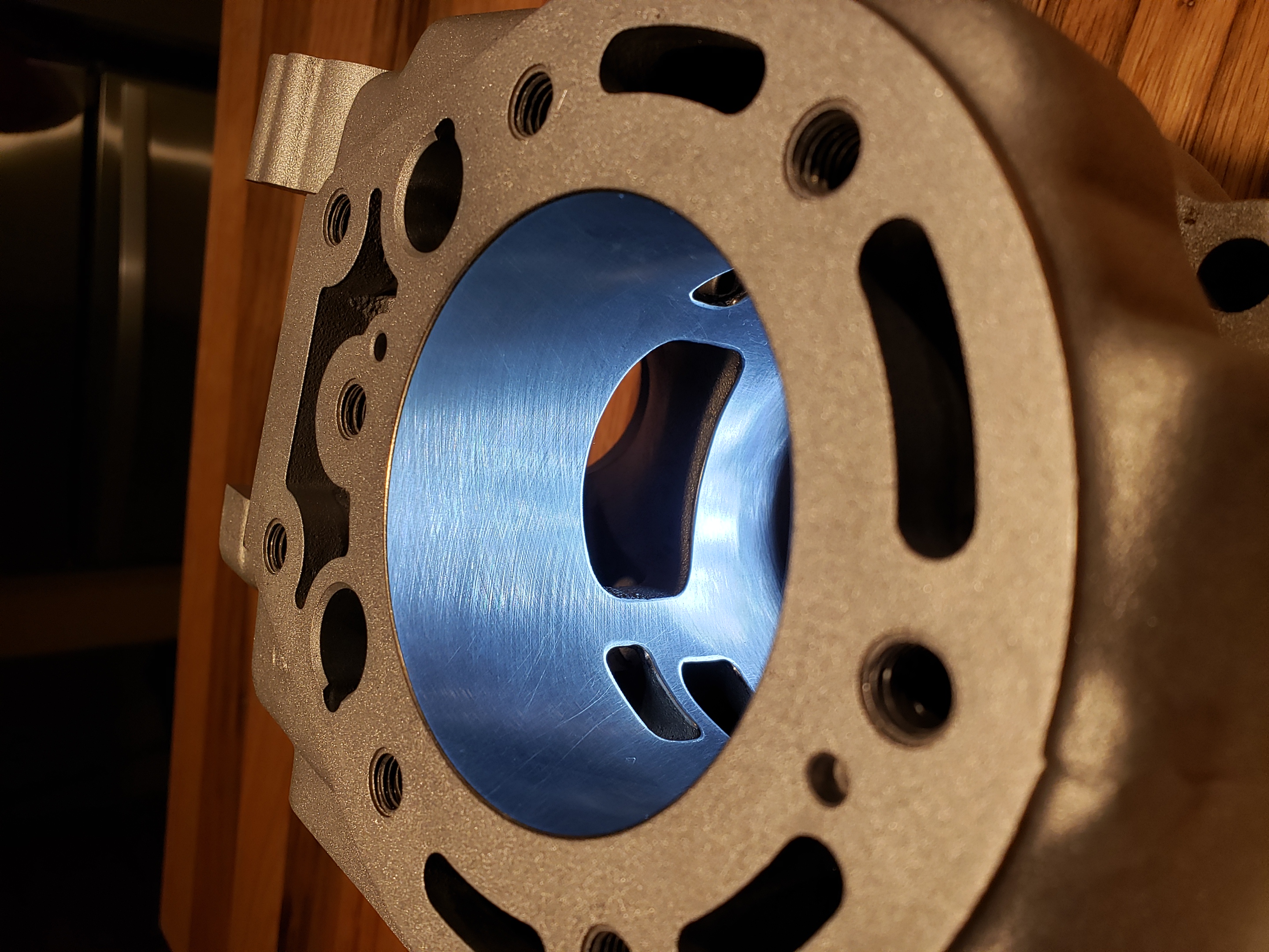

Received my jug from millineum today. Looks awesome! Port chamfering looks great!
And I did send the piston, it was returned in the same condition. Not a scratch, no indication it was even handled at all.
My compression was 150 also.

Twinsig wrote: 09:11 pm Mar 03 2020 Received my jug from millineum today. Looks awesome! Port chamfering looks great!

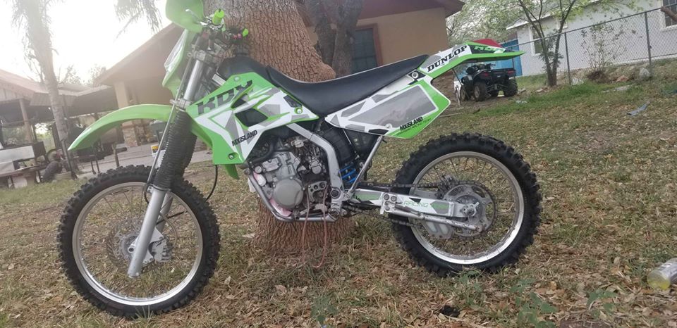

omg look super nice getting mine fix soon! here a picture of my dirtbike

Twinsig, check it for grit! Wash and rinse over and over, then white glove treatment.

update : my cylinder look super ugly from inside. i traded it for a yamaha blaster kdx didnt had a air filter im guessing that why is worn out from inside... how can i remove the kips ?? or do i pay them to remove it for me im gonna send it to Millennium soon!

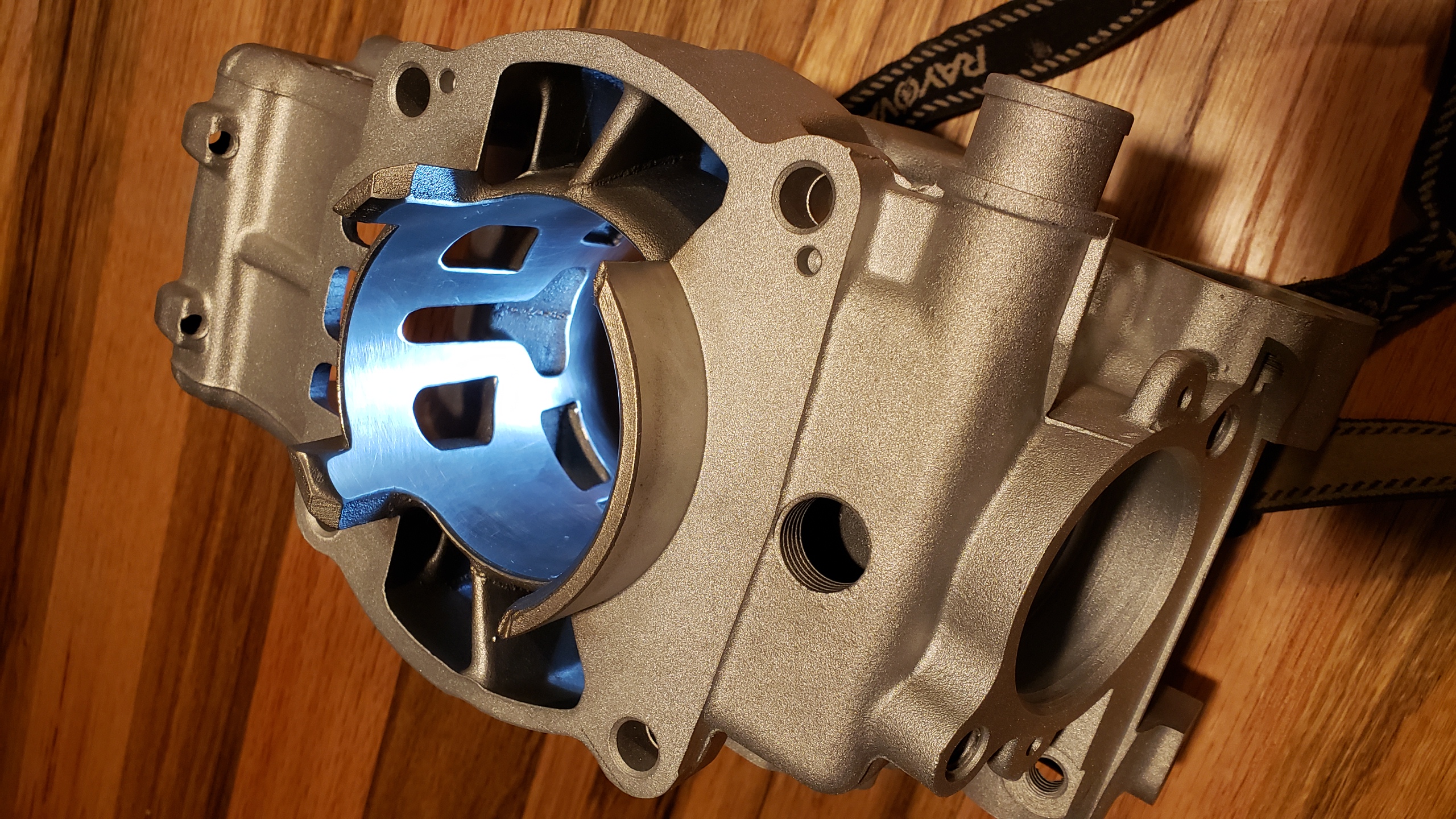

Ready for assembly..Clean and cleared the funk in the threads.
