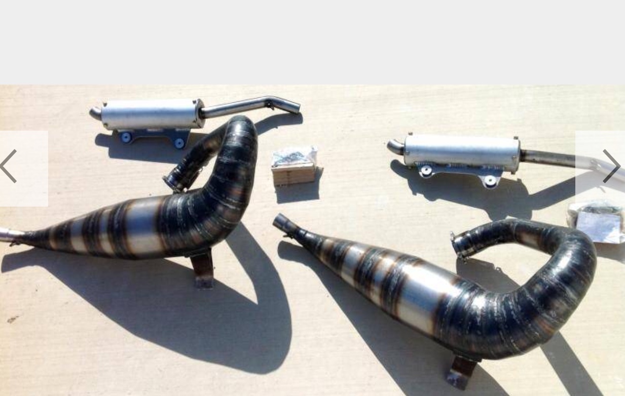

A tap & die set would clean up help you to remove the corrosion and rust off the threads. For the threaded bosses, use a thread tap preferably a bottoming tap. But that doesn’t get the rust off the rest of the bolt. My dad has a tumbler with walnut shells to polish his brass shell casings for reloading ammo. That does a nice job making it shine right up. You could mix a mild solution of Muratic acid and water to remove the rust but mild so as to not remove the zinc coating which would make it even more rust prone in the future, that worked great on some used Buchanan spoke nipples i had. I have purchased a bolt kit replacing the old hardware, and you have the used bolts in case you lose one on the trail. I don’t use loctite on every fastener, some I have to remove occasionally for maintenance also I don’t use a rust preventing oils on every bolt. Retorqing non loctited nuts & bolts is part of prepping.
As far as rust prevention, I’ve had good luck with acf50 I got from work. Wd40, liquid wrench, pb blaster, kroil will do also. I bought a couple raw unfinished hpr19 expansion chambers and it keeps those from rusting & looking unprepped. Nothing is uglier than a rusted raw pipe
