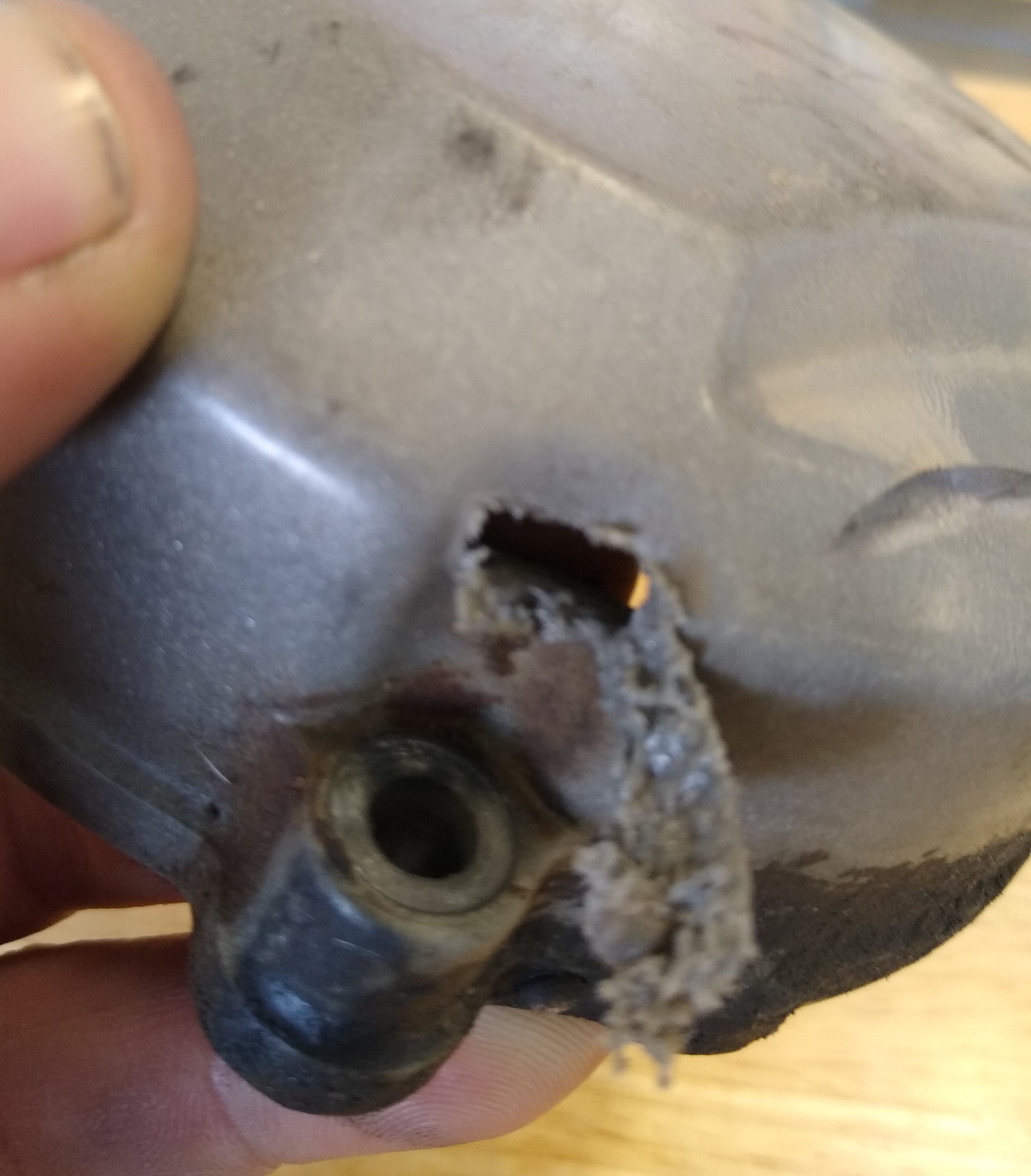

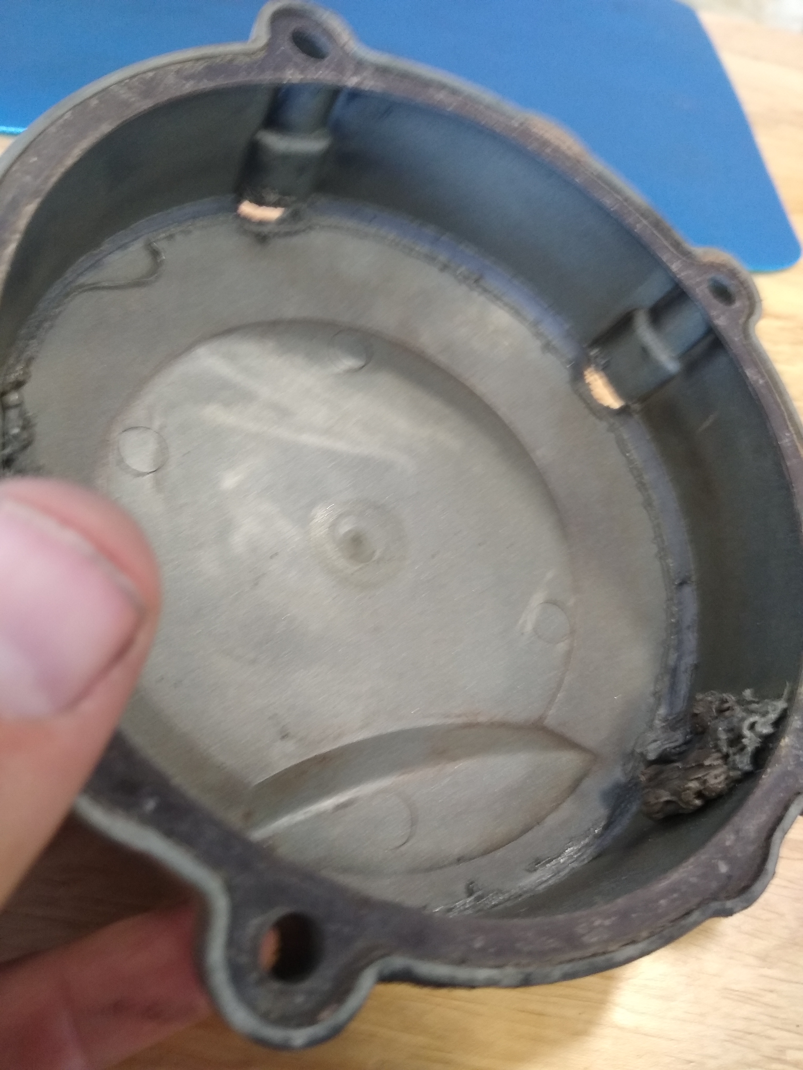

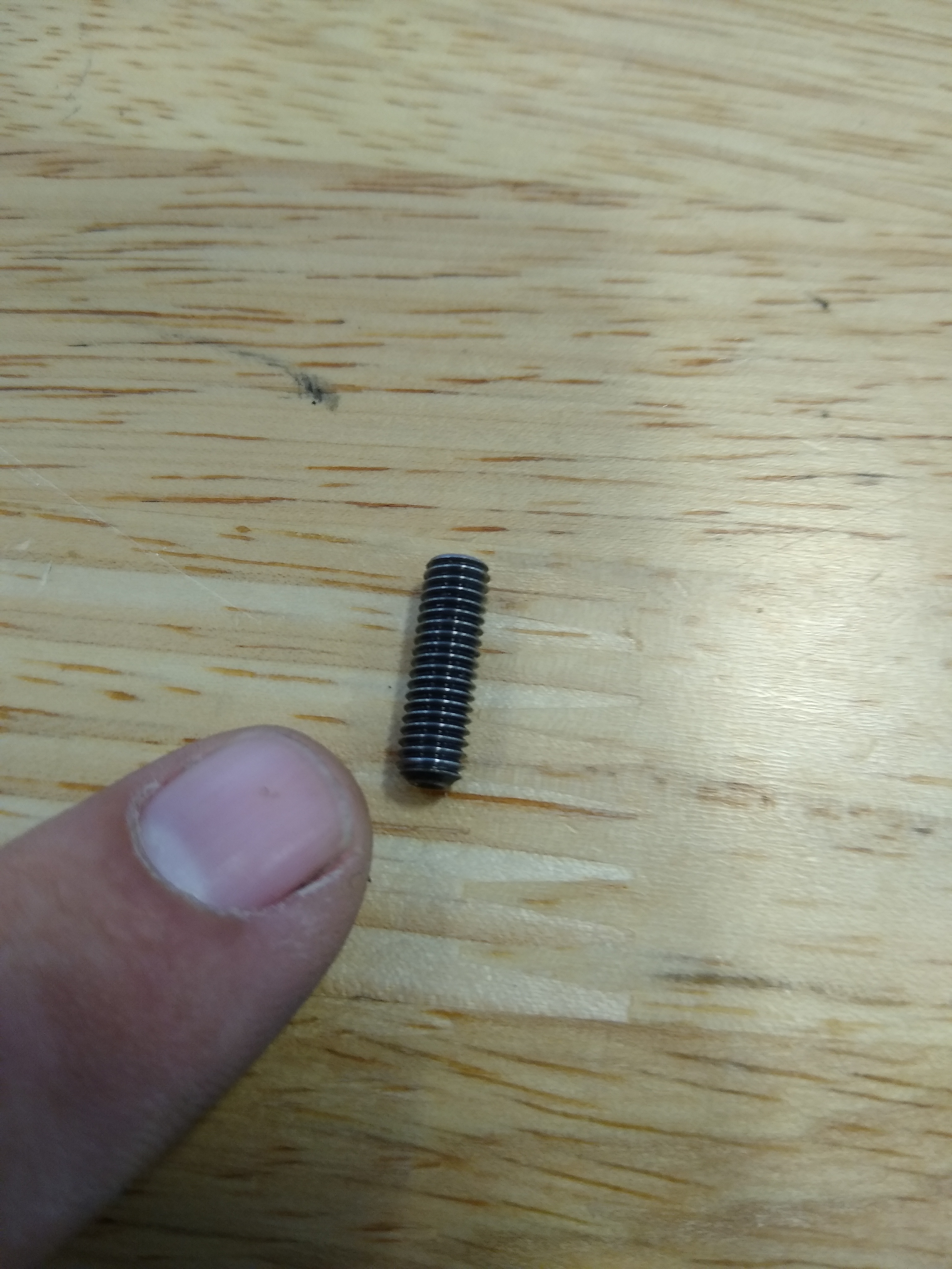

I had a problem though. One of the set screws on the side backed out, and wrecked the cover! Luckily no other damage. I found a new cover on E bay. Put the screw back with thread locker and peened it in. no problems since. So look out for that.
