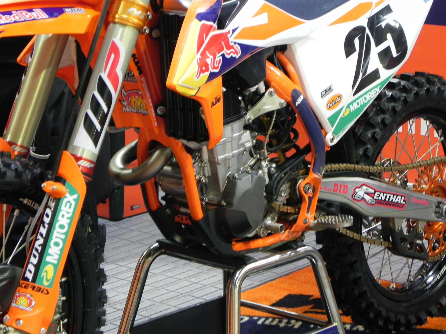

Re: Air vs liquid cooled
USD forks are more rigid. For example, 2018 Team KTM's Marvin Musquin's 52 mm forks.
