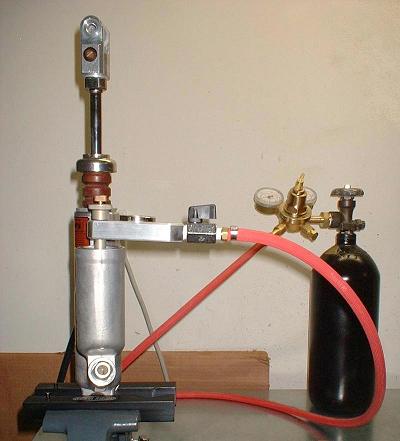

The tough part with doing it yourself is sourcing a nitrogen charge!
Re: Rear Shock Rebuild time?
kdxsully wrote: 12:47 am Feb 17 2020 The tough part with doing it yourself is sourcing a nitrogen charge!
I struggled for a while before I bought mine. (pic from 2005, some member's shock I was working on)

How much did you invest into that?
kdxsully, $325 back then... Race Tech chuck, locally sourced parts otherwise
