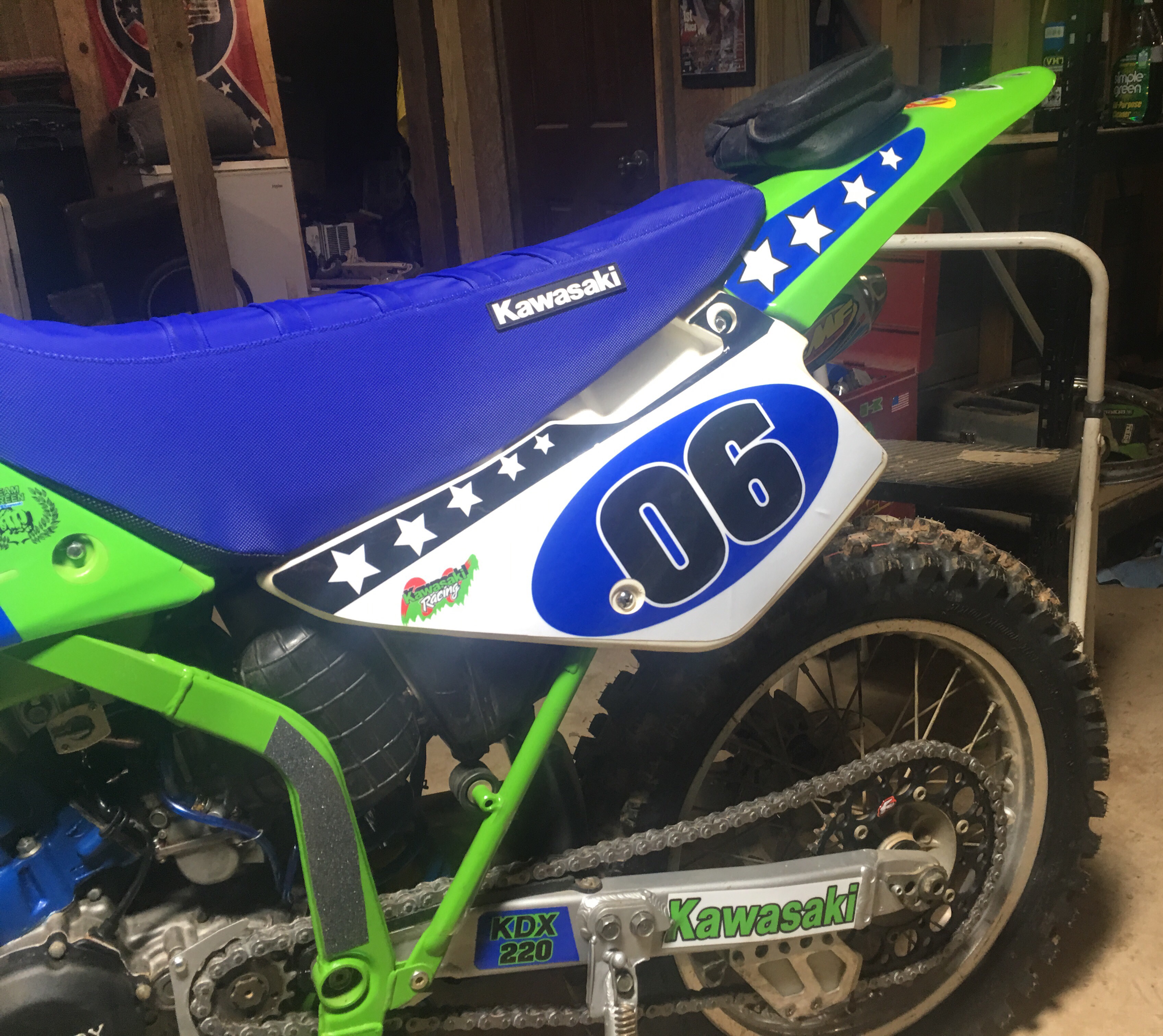

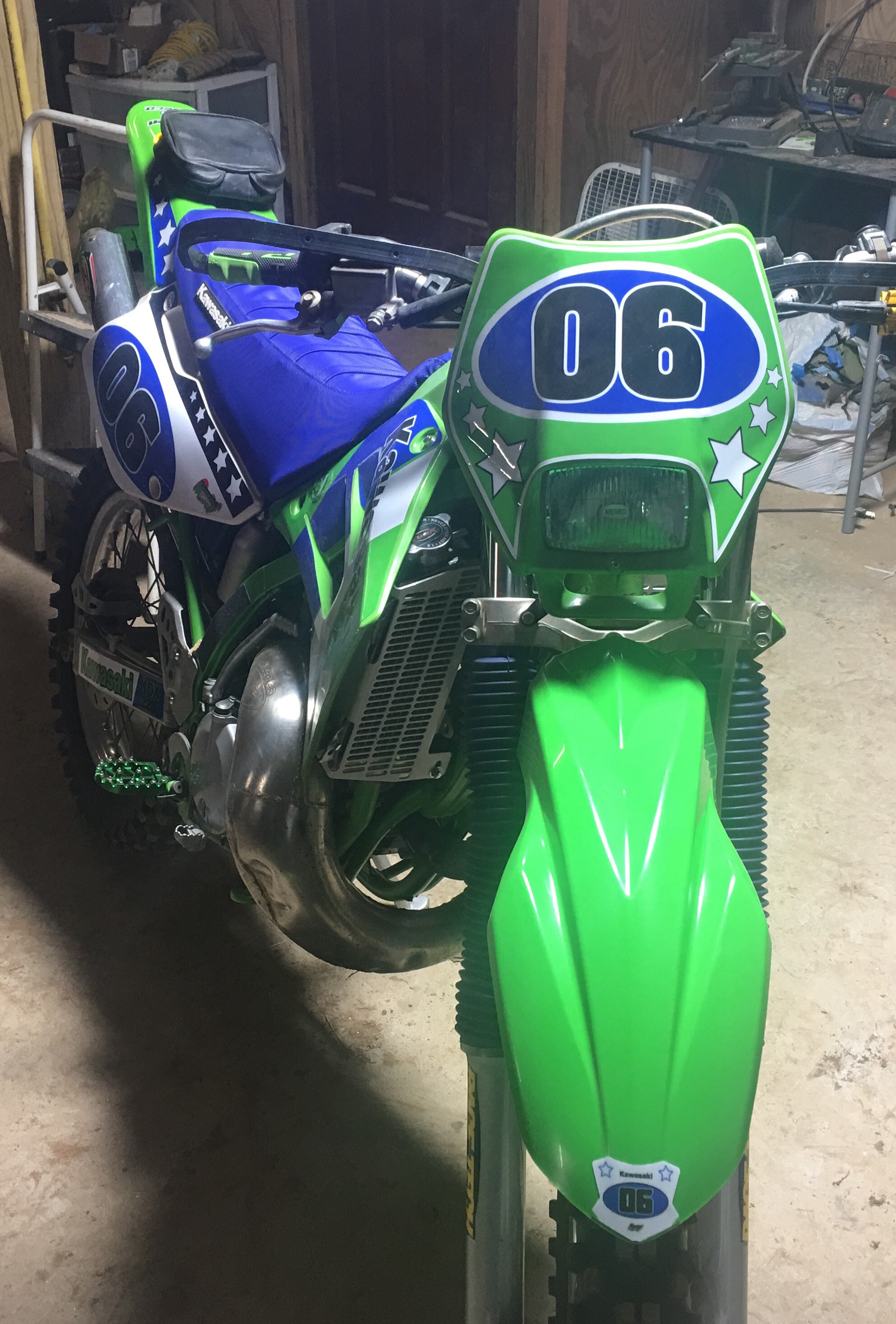

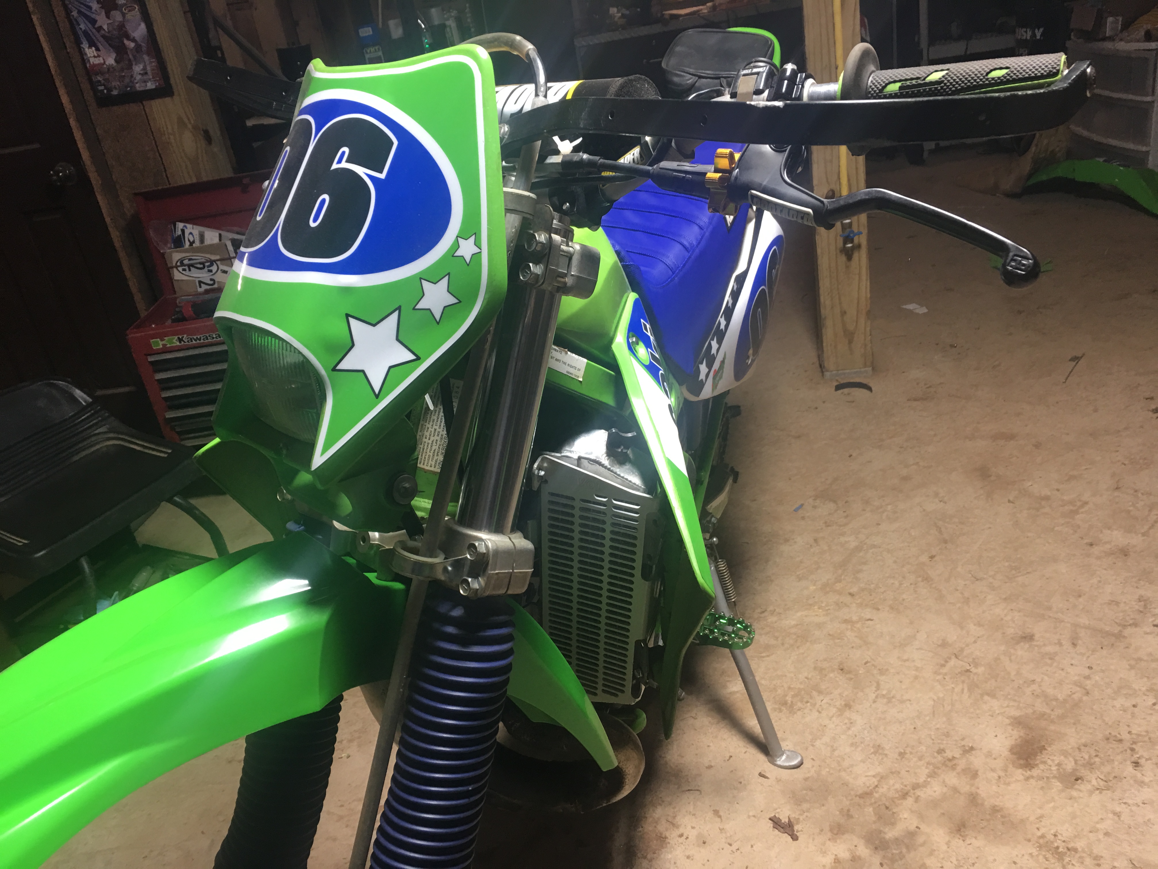

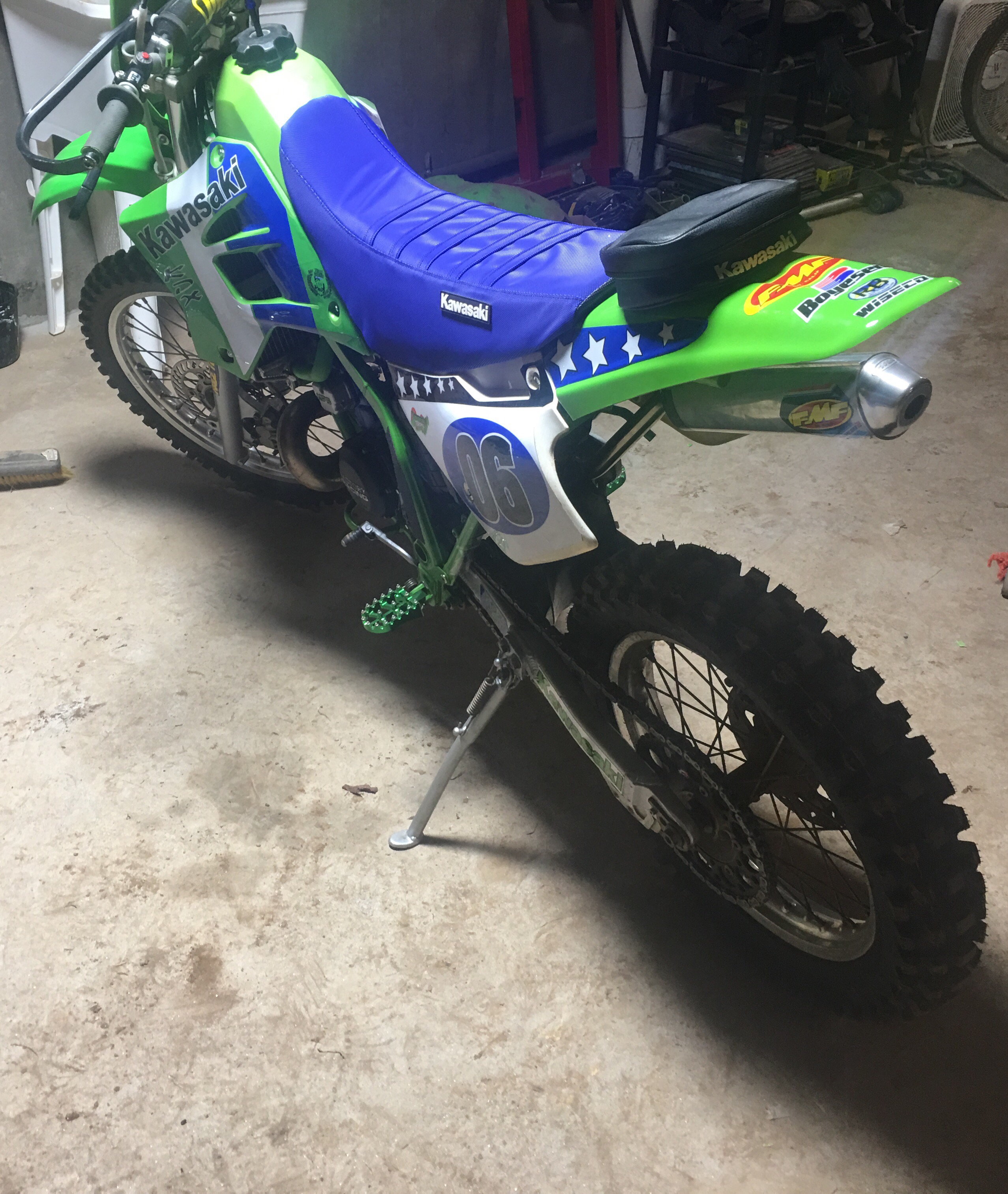

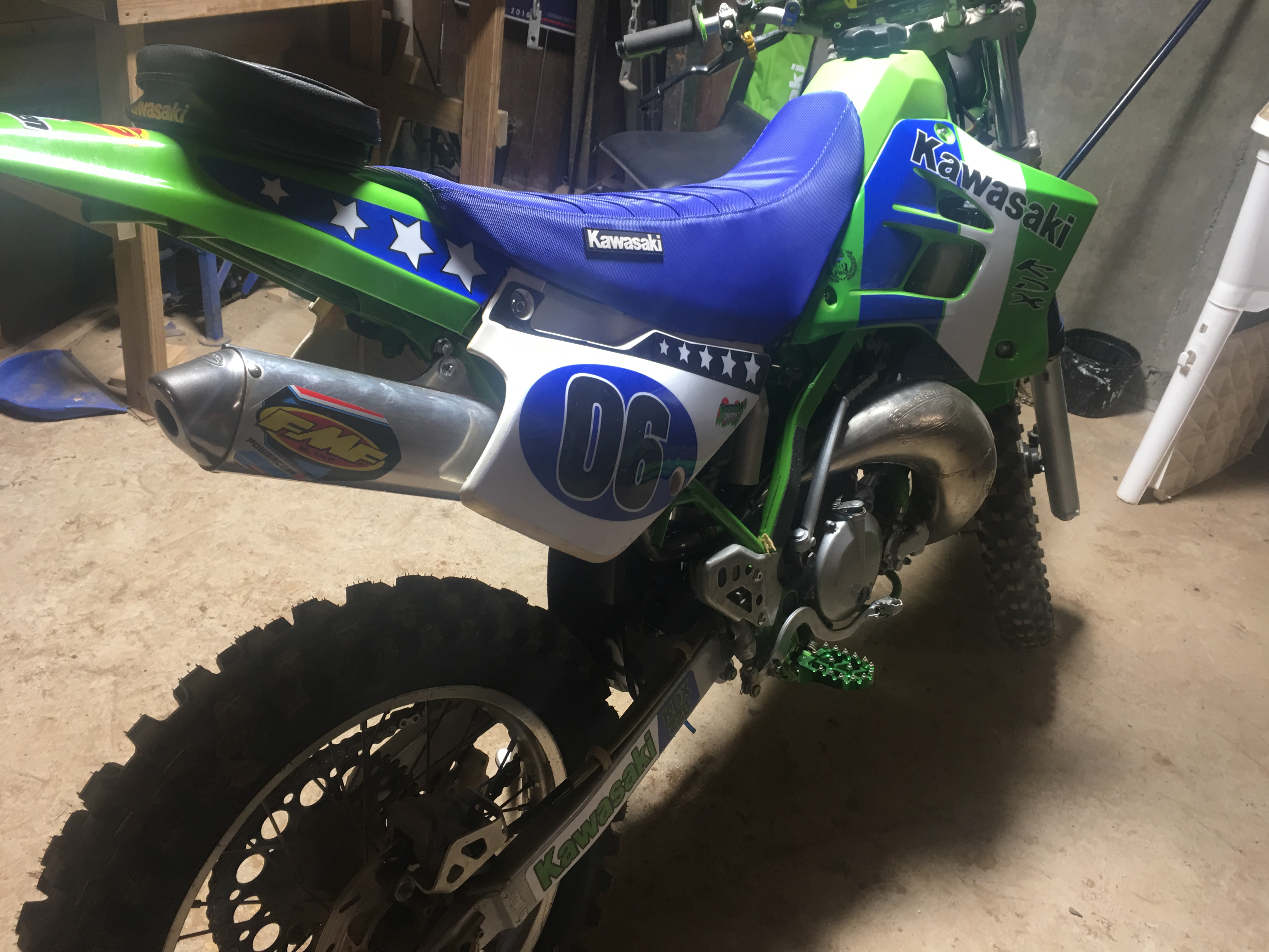

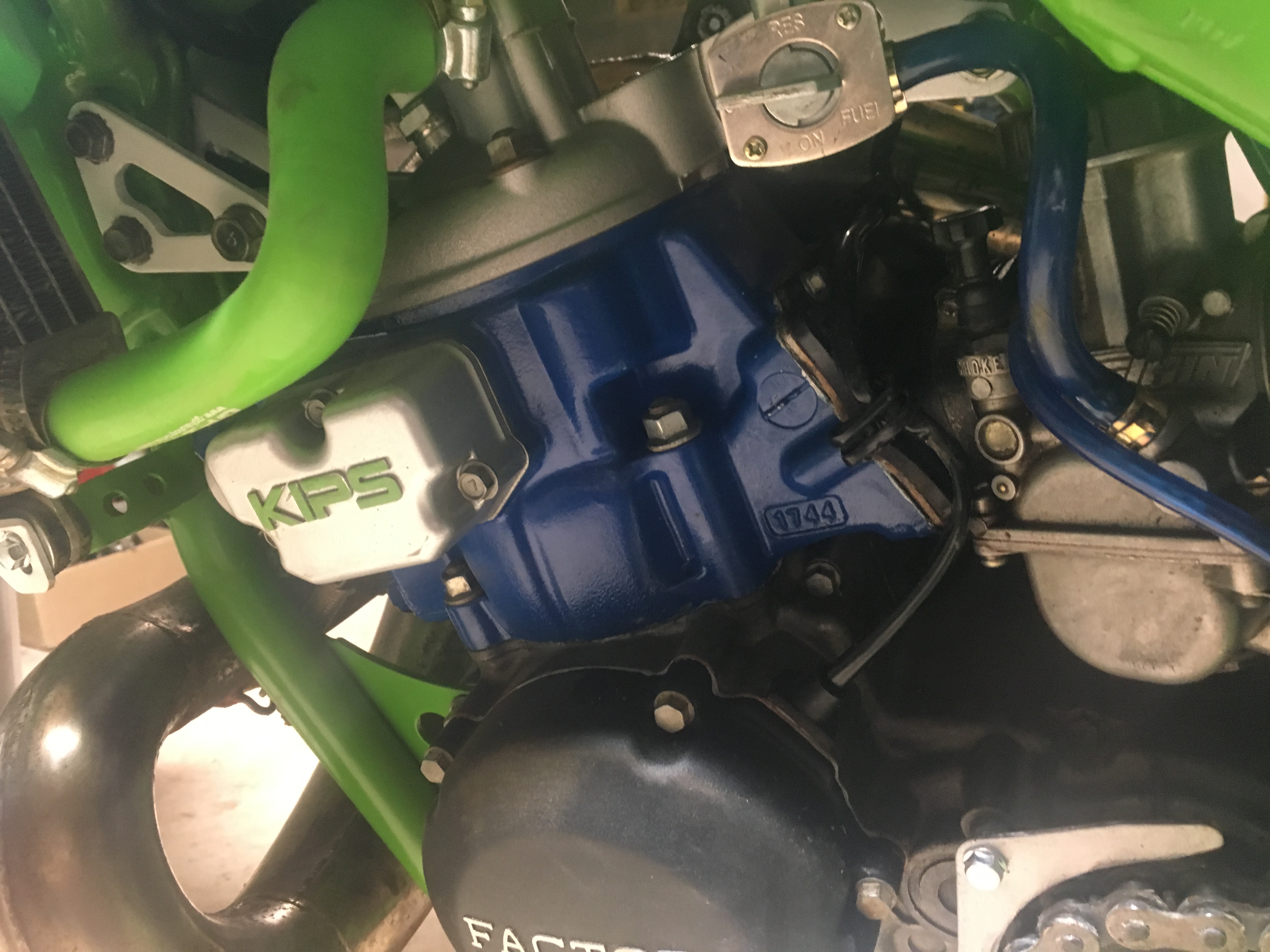

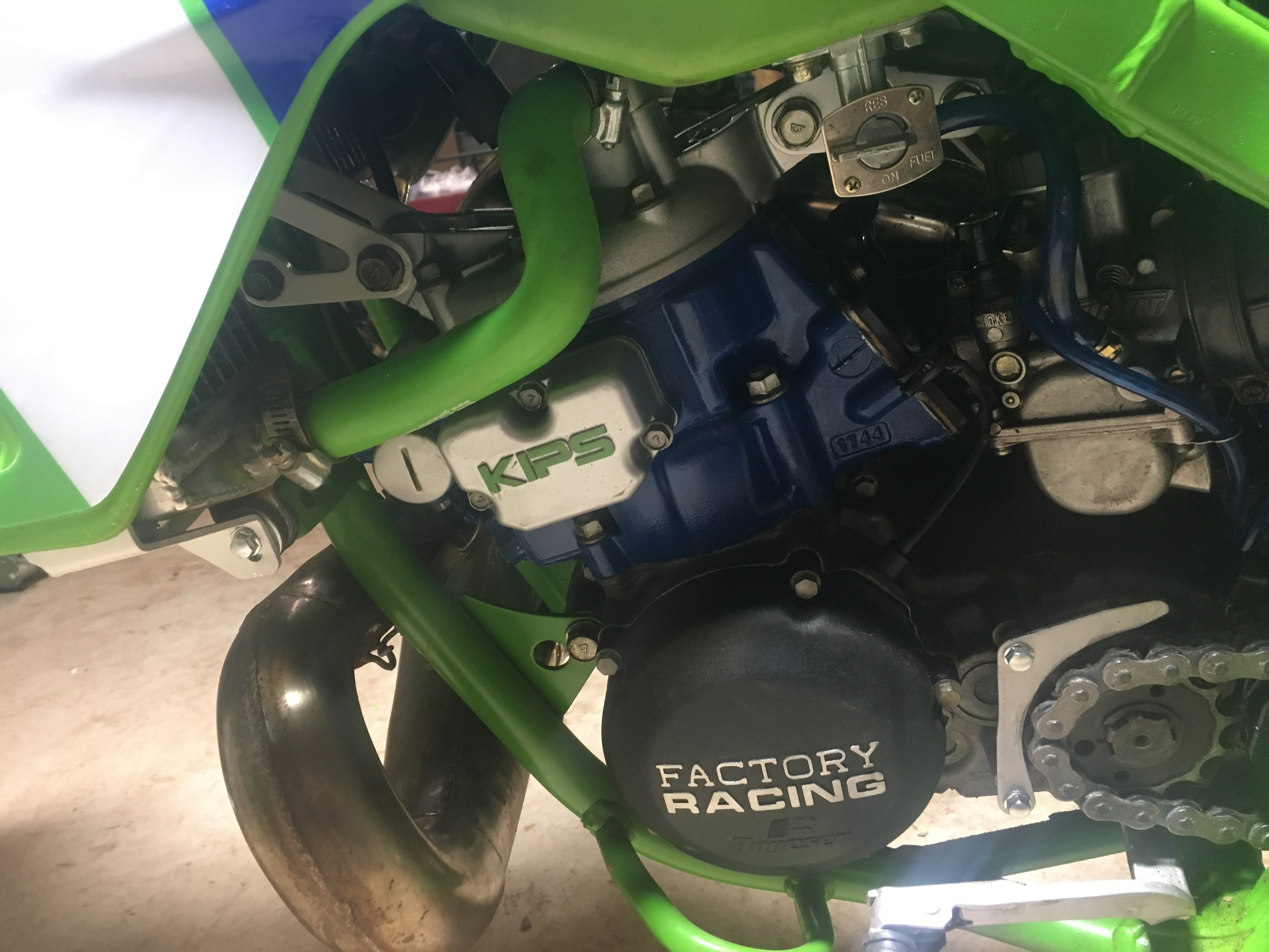

Hey all. I just finished up my winter long refresh on my 03 KDX 220R and wanted to share the results. A bit of a story on this ole bike... I bought it in 2011 in nearly new condition off a guy that only put 30 miles total on it. I was going through a personal rough spell, and this bike in 2011 was my medicine.
You can see my old post for first time build, but basically all(most) of the fun stuff a 220 likes.
Fast forward. I rode the hell out of it for about 3 years and parked it. It sat. Then.. my 14 year old son... who out grew his kx85.. took an interest in my old girl. He started riding, then every day riding. His personal skills were climbing faster than on any bike he’s ever had.
Then.. he started racing it! He did more than a handful of southern series hair scrambles and such. He finished every race, which given the wet conditions is kind of amazing. Even got a few top 5 in his class on the old KDX.
Well, as it turns out.. old bikes, racing and teenagers isn’t a good mix from a machines point of view. As my bob said, “this bike is clapped out”. What ever the hell that means. He even said “no way that bike will ever ride like new again”. That part I understood and took as a personal challenge.
Enter 2020 KDX 220r redo...
Here is the buy list best I can recall. I took the old girl down to frame and built back up, replacing one “clapped” part at a time.
I want to give a shout out to Kawasaki parts warehouse. Seriously. E-V-E-R-Y single part on this old bike is for sale. Old rubber side plate rubber stopper? No problem. And so on.
Motor——
-fresh wiseco top end
-new water pump
-new clutch
-refreshed clutch basket
-new water hoses
-new air filter
-new carb cable/misc carb rebuild stuff
-new fuel and over flow tubes/blue
-new plug/ignition wires and boot
-heat/header paint the jug blue
-sand/paint all mounts/brackets/misc parts
-sandblasted bolts
Suspension-
-local race tech, tech rebuild. F/R
-new springs F/R several sizes up on both
Chassis—-
-sand/paint frame, swing arm, everything
-new swing arm bearings
-new suspension pivot bearings
-new wheel bearings
-new suspension triangle arm replace (out of tolerance)
-new brakes, caliper rebuilt
-new fork boots
-new handle bar rubber mounts
-new head light
-new pegs
-new pipe hanger brackets.
-new front rim
-new f/r tires
-new pet cock
-new renthal sprocket
-new rk chain
-bunch of misc frame rubber mounts and such.
-new grips
-replace tree guards
-new mud flap
Bling—-
-new rear plastic mx straight
-new front plastic from 2019 kx250f
-new pro taper clutch levers
-new motocal custom graphics (I personally designed those in their app)
-new seat foam
-new seat cover
-boyseen ignition cover (it just looks too nice not to buy)
-new clear sticker for forks/frame
-skate board deck tape.. for heavy rub area on frame
-gas cap vent thingie
-devol radiator guards
-devol rear caliper guard
I’m sure I’m forgetting something.
My kid, and all his riding buddies have given the project a thumbs up— and my biggest reward was when my kid said “well, I guess you can make an old bike new again”.
The real question is if I let him ride it again!!
One before pic —the rest after the restore

Re: 2020 KDX 220 project restore
WOW! Wonderful job! I like your color choices. Congratulations and even THANKS! on getting it back to a wonderful state.

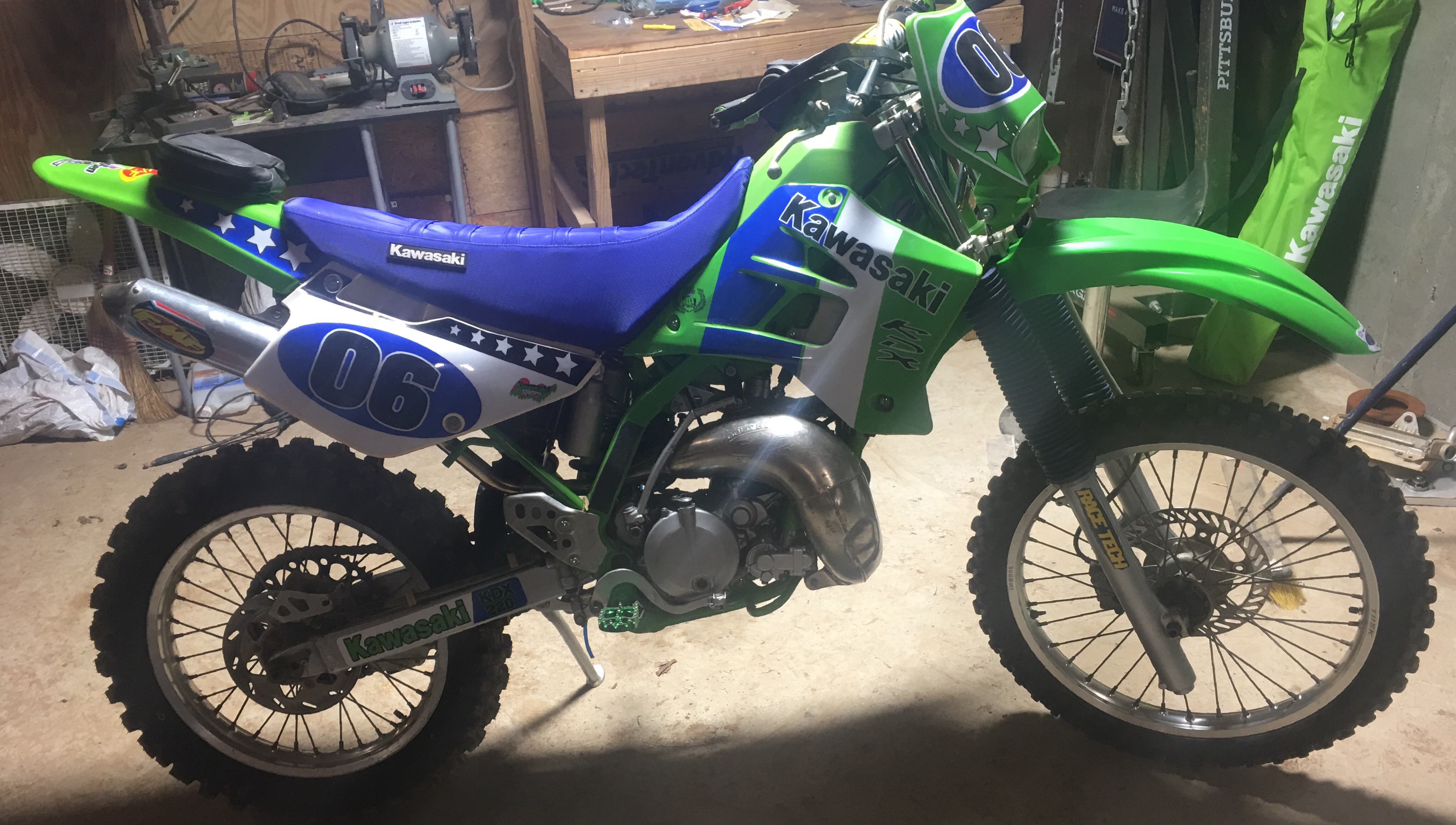

A few more pics
