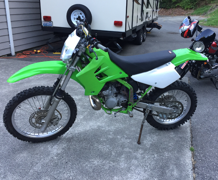

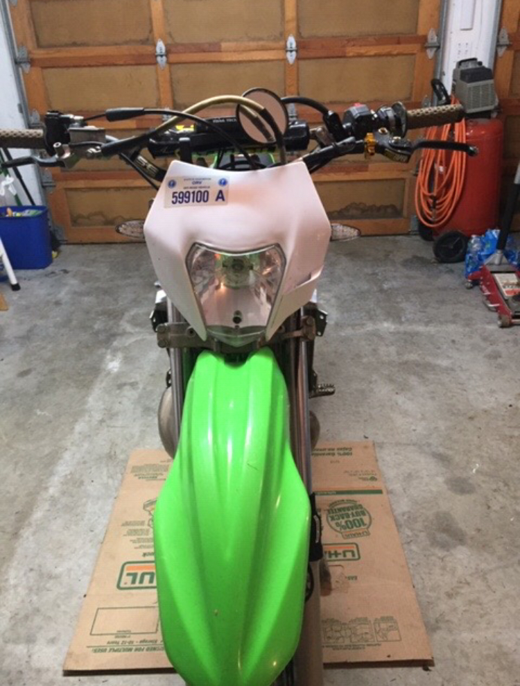

I have this no-brand wired directly. Plus added extra grounds thru the tusk kit for street legal hi/lo.

I’d suspect no diode needed. But haven’t used one of the higher end lights. You’re right I don’t think it is LED. I think it’s is this amazon one (came with bike so not for sure). It says it’s an S2 12V bulb. Sorry not a good comparison for your idea.

I am surprised that it seems great. It seems comparable to the headlight on my street bike. I ride it on our woods for perimeter checks and for $20 think it is great.

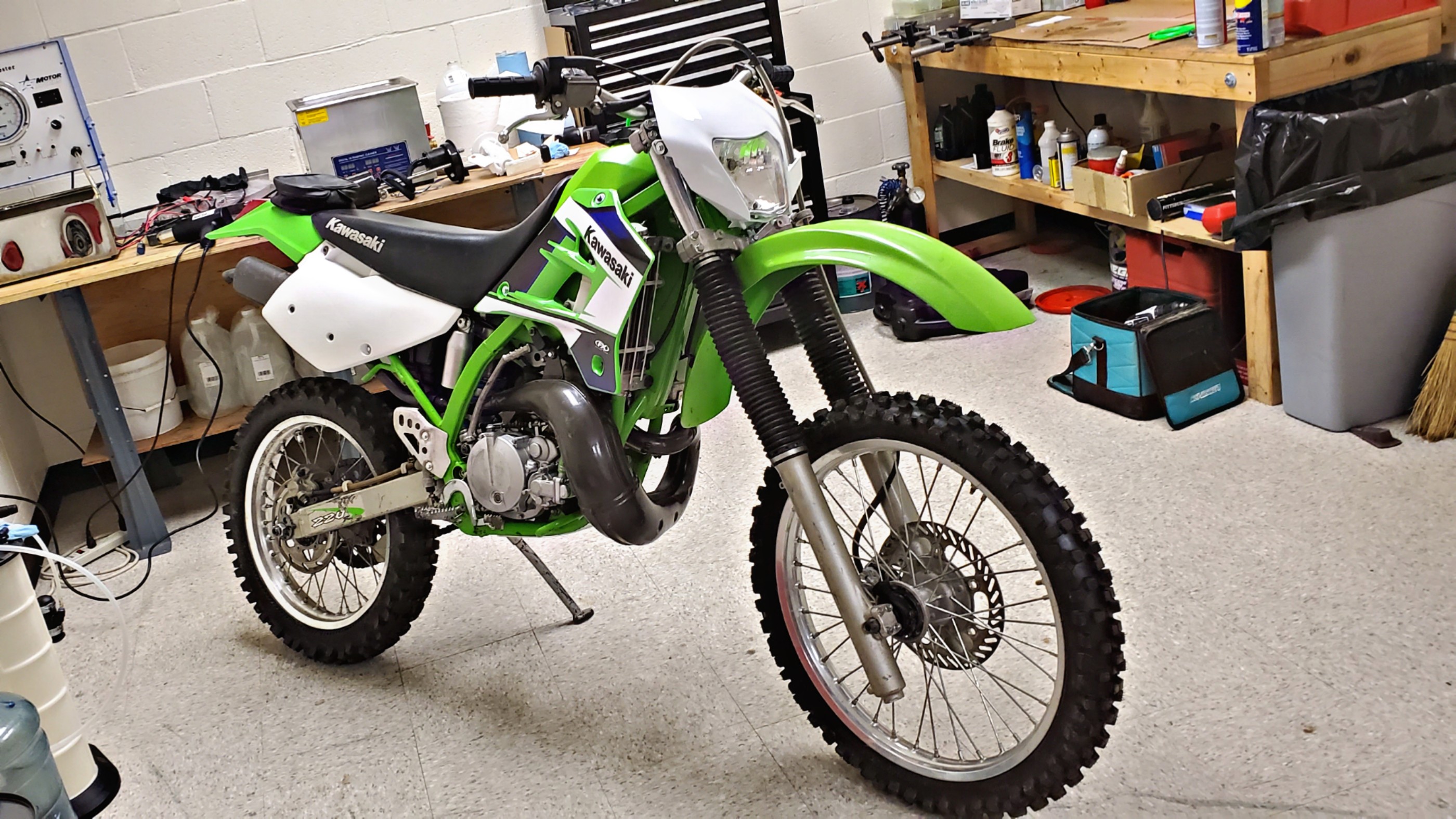

Re: New guy with an old led/headlight question
Well, I followed Goats advice and went with this setup. It works well and was reasonably easy to install. Thanks brother!
