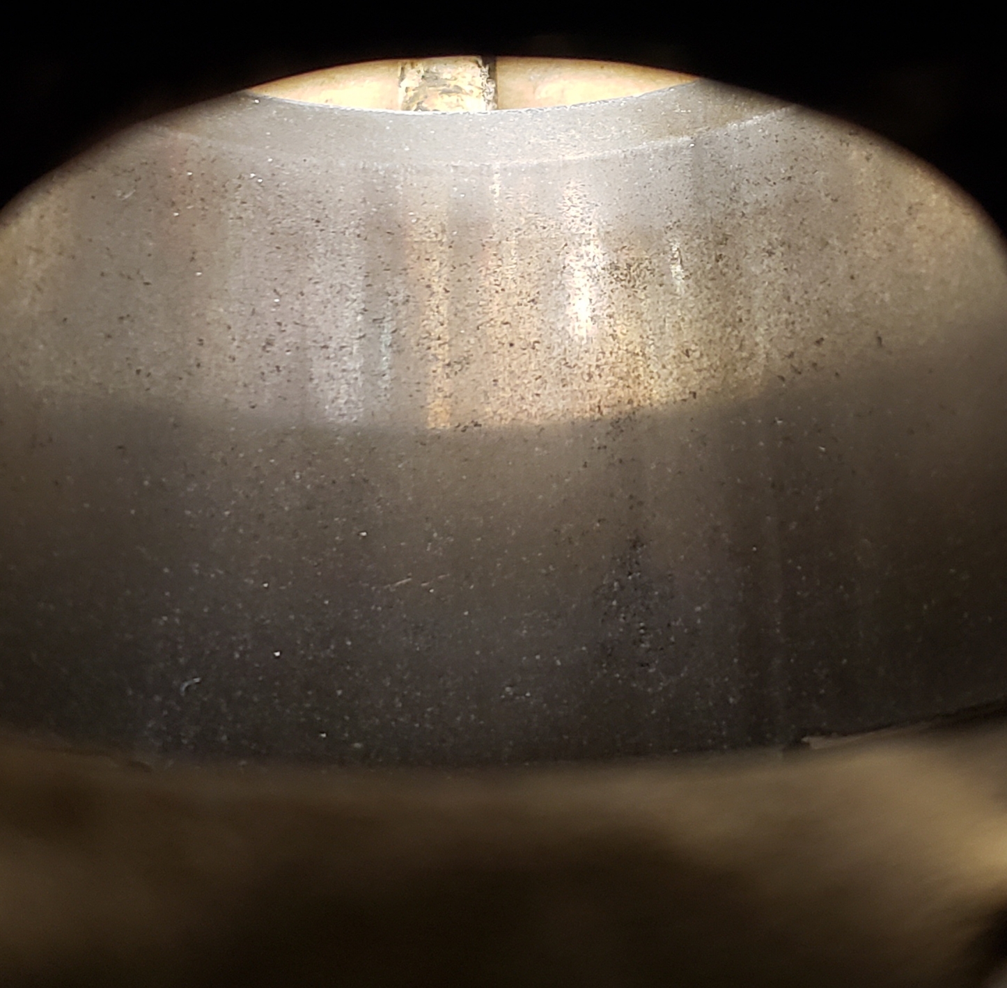

Intake side photo. Looks pitted, but I don't know if that's acceptable or not for this electrofusion deal. I know it had 150 psi, and bone stock. All indications are this is first time the cyl had been removed..

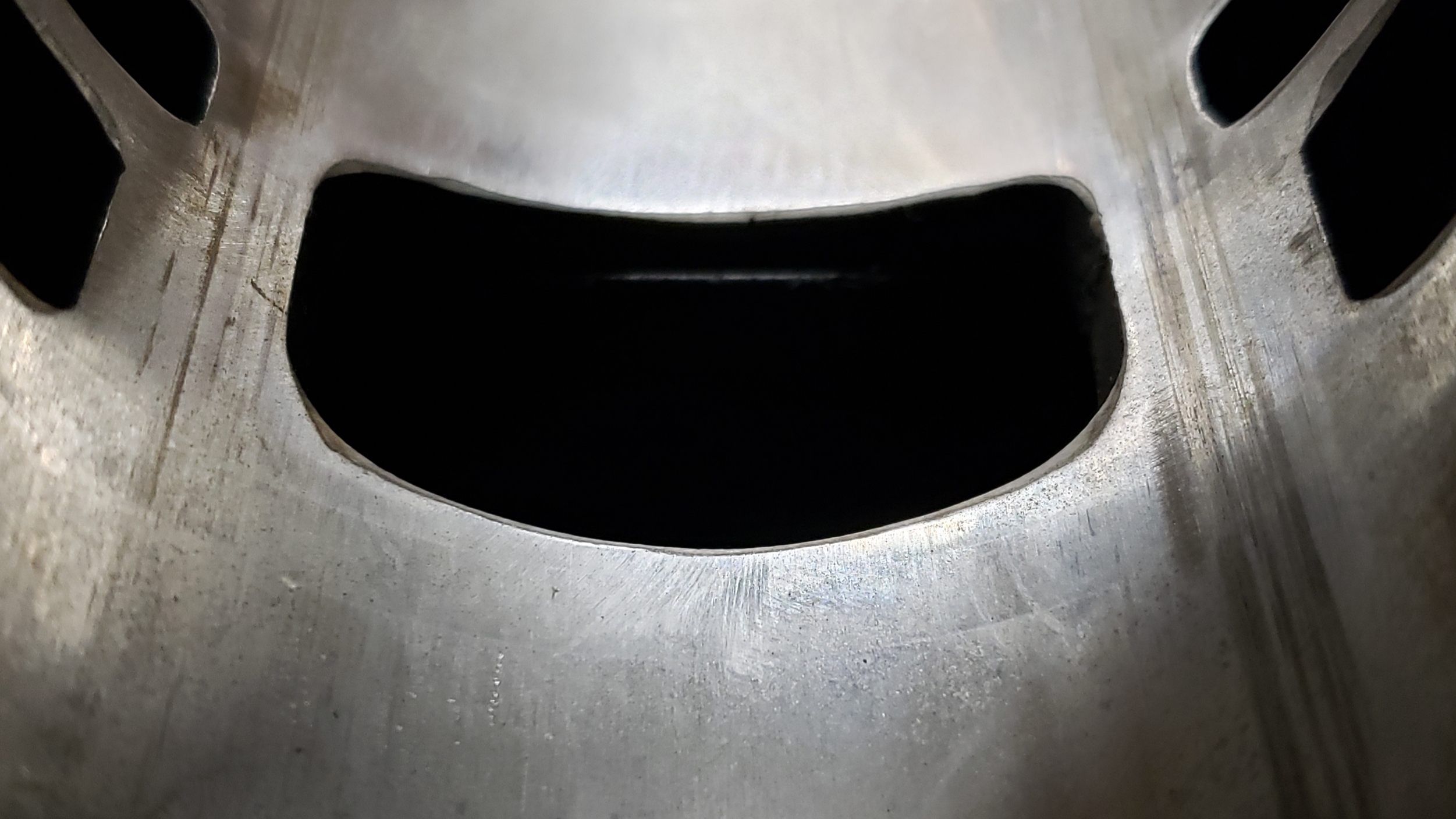

Thoughts? (Little trouble with file size and limited editing on the s9 android)

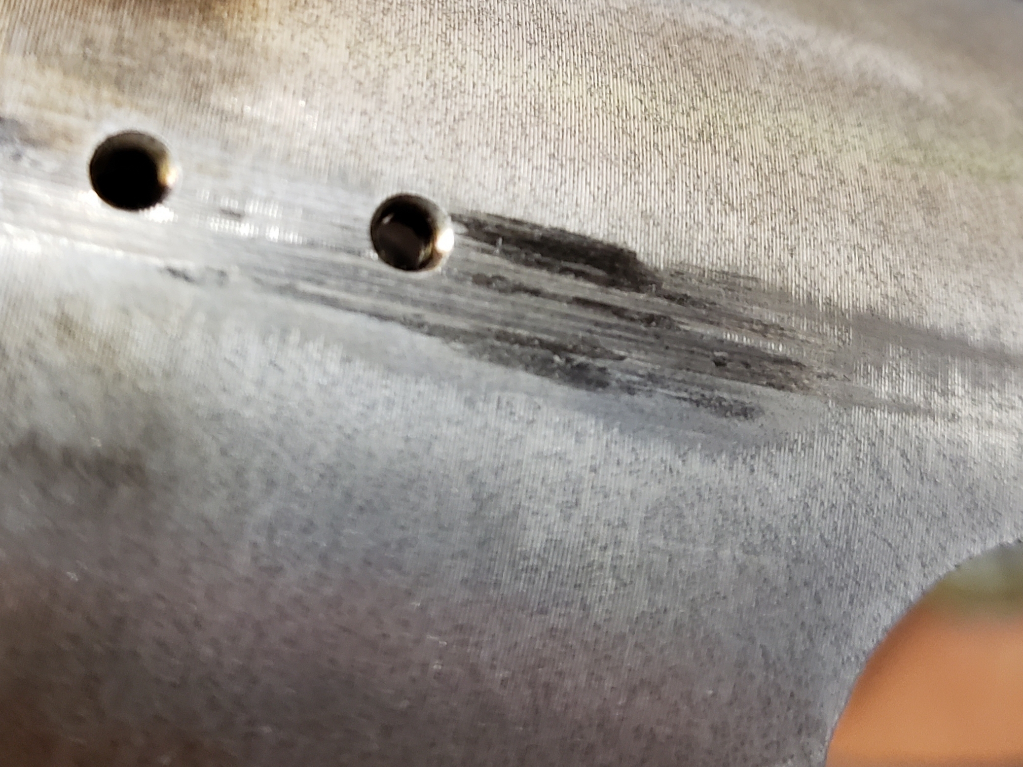

Haven't experienced this before, or don't remember any spotted, faded look from the old days...

Last pic looks like an upside down ashtray. Smeared aluminum is not a great sign. :-|
Can you catch a nail on anything on the cylinder?
Electrofusion DOES NOT have standard cross-hatching that many are used to in other non-Electrofusion cylinders. I have had two new OEM cylinders with Electrofusion. They just don't have it.

Would certainly rather not re plate if I can get break in a piston&rings for the same performance as it was.

Going to scrub & clean w, scotch pad tmrw ..hope I'm gonna be ok. Can it be de-glazed??
Haven't tried hanging a nail yet..
2003 220R
Re: The new guy, kips shaft remove question?
That looks odd. What year is this KDX / model??
It looks old and worn. Worn out? Not sure from pics.

See the solid gray around the exhaust port in the last pic? That’s aluminum. I’d replate for sure.

Good eye..the shop guy said the same thing..
He's betting the PO did bunch of dry start ups after storage all these years and prob rarely ever serviced the air filter.
Everything is cleaned up..
He recommended millineum.

Millenium is good, so is US Chrome. Looks to be worn as mentioned by others.
