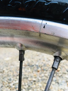

Took a ride in the desert today. Power washing the bike I noticed a crack in the front rim. It goes about 1/3 the way across. Anyone have experience having a cracked rim repaired or do I just replace it? My son is a welder, but hasn't ever fixed a rim before.

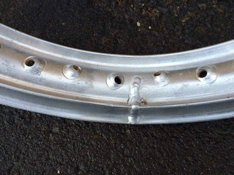

Yes like everyone says, it can be welded.
Bass Bros Welding did my '73 SC500 wheel. He asked me if I wanted strong or pretty, I chose strong.
IMG_2872 - Copy.JPG (244.37 KiB) Viewed 1526 times
