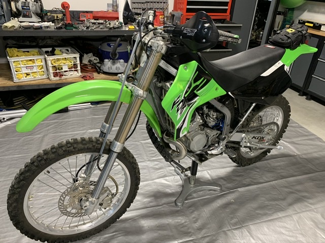

Re: KLX forks and KX Upper Clamp?
As far as going to the trouble, it’s also because I have fat bars I’m fond of. I fall as well, but so far don’t remember tweaking the bars, but I have wondered if I should just buy smaller bars and not worry about it. I wasn’t sure If I would notice more vibration or not.
So far...
So far...
Then why not just use the regular solid mount fat bar adapters?Owyhee1 wrote: 12:16 am Jan 04 2020 As far as going to the trouble, it’s also because I have fat bars I’m fond of. I fall as well, but so far don’t remember tweaking the bars, but I have wondered if I should just buy smaller bars and not worry about it. I wasn’t sure If I would notice more vibration or not.
https://www.revzilla.com/motorcycle/pro ... lsrc=aw.ds
What I did, and the adaptors raise the bars slightly, which I like.
