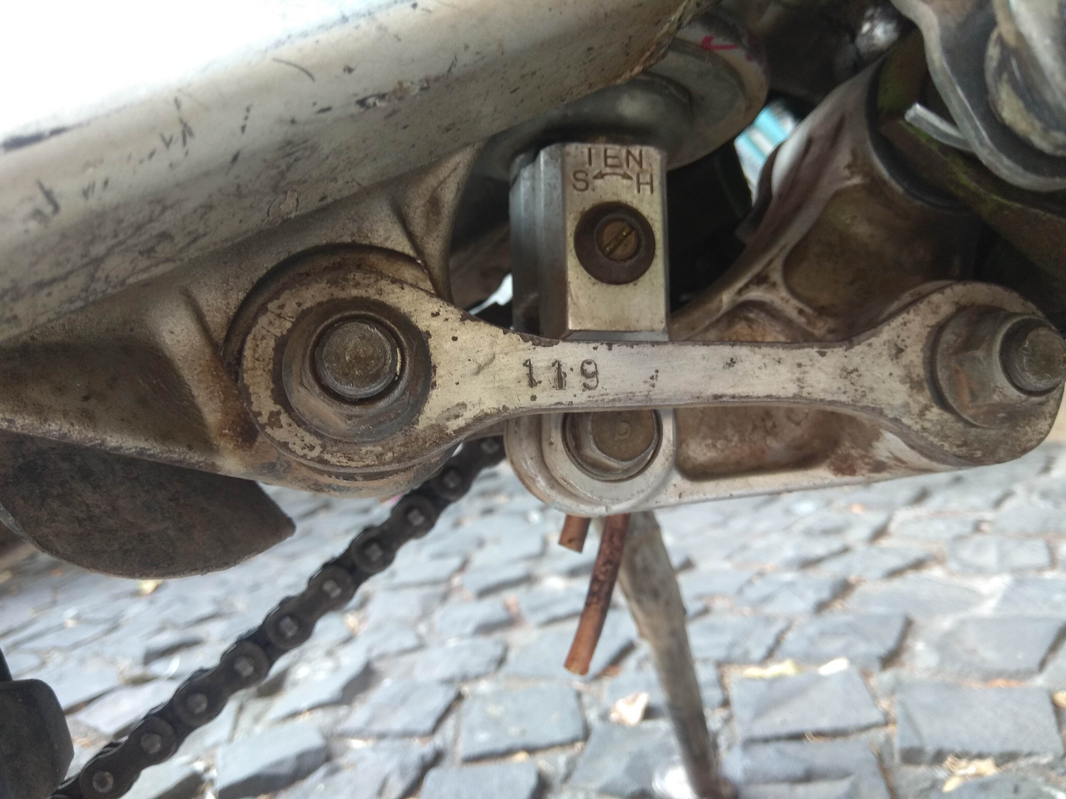

Are you sure? My Kdx220sr is stamped 119mm. Would that make it taller or shorter than the 112 links
Oh, you got me!
For USA sold 1995+ model KDX's, it is 112.5 mm. The original poster is from the USA. I assumed his KDX is a USA sold model. The thread title mentioned "H" model, not "B", "F" or "G". I replied as as such.

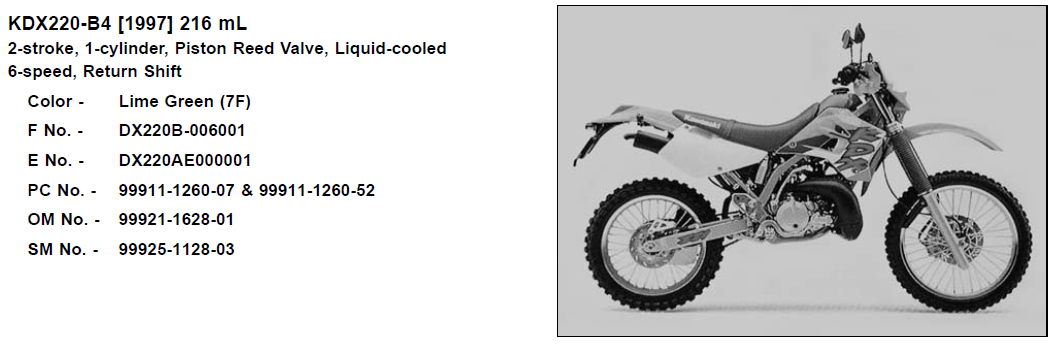

Is this your KDX?kdxdazz wrote: 12:05 am Mar 03 2020 I'm still confused. The Kdx220 is a H model isn't it? My bike is already very high. I can't imagine that there is a kdx model that is even higher
The USA market had:
KDX200-C, E and H
KDX200-D is similar to C, but not sold in the USA. KDX200-E and KDX200-F are similar to E, but not sold in the USA. KDX200-J is similar to the H, but not sold in the USA. KDX220-A was sold in the USA. KDX220-B was not. I hope this helps.
Also, no KDX125 in the USA. NO "street legal" KDX's sold off a dealer floor in the USA.

Re: dog bone lengths e vs h ?
Without meaning to hijack a thread. Yes that is my model. The previous owner changed the forks to the later cartridge style. I'm wondering if these are longer than the SR model which would mean the original dog bones would be low and might through my geometry out. I've been feeling my front end doesn't track so well. Might try dropping the forks through the tubes and see how it feels

Are you able to post a pic?
- Posts: 583
- Country: thailand
- Location: Thailand
- Been thanked: 4 times
119mm
