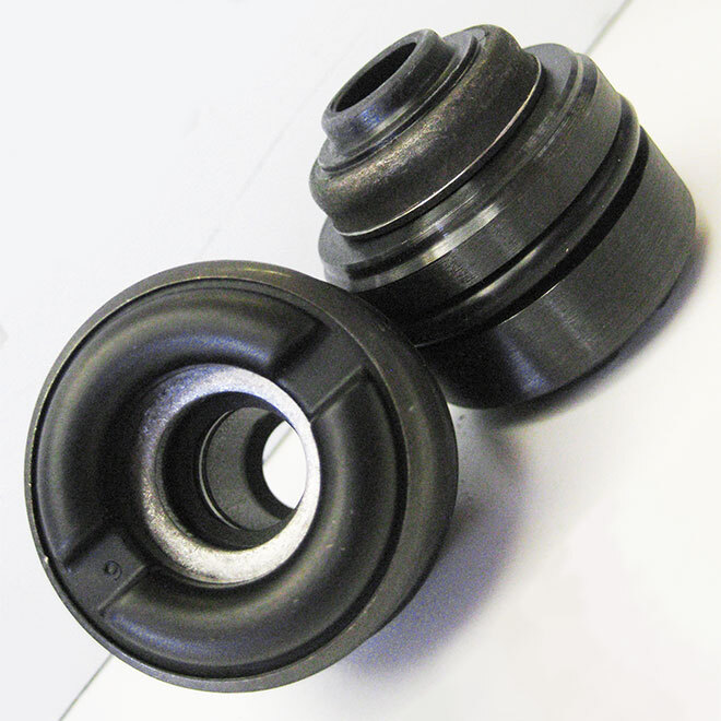

cheers guys. just out of interest do you have any photos of this peened over edge
Re: Kdx220 shock seal head
took ten minutes

Yep. Looks like way too much trouble to unpeen. Will order it.
