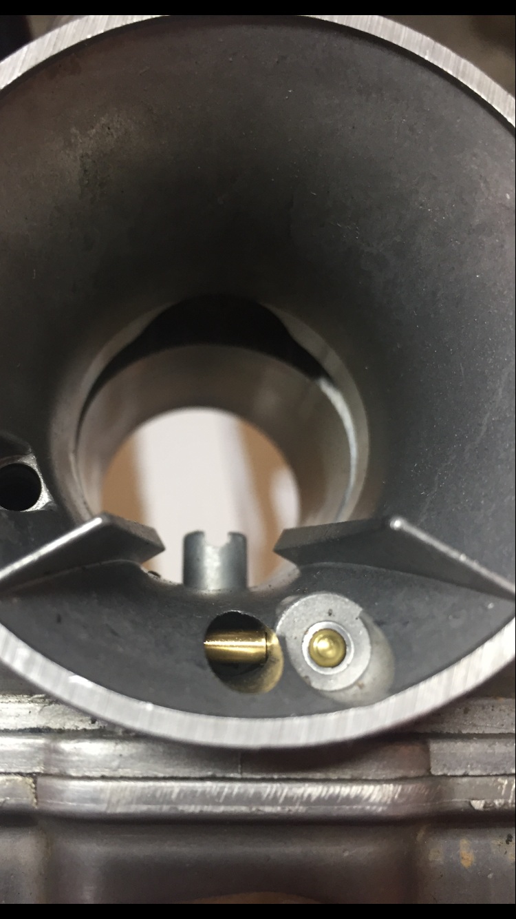

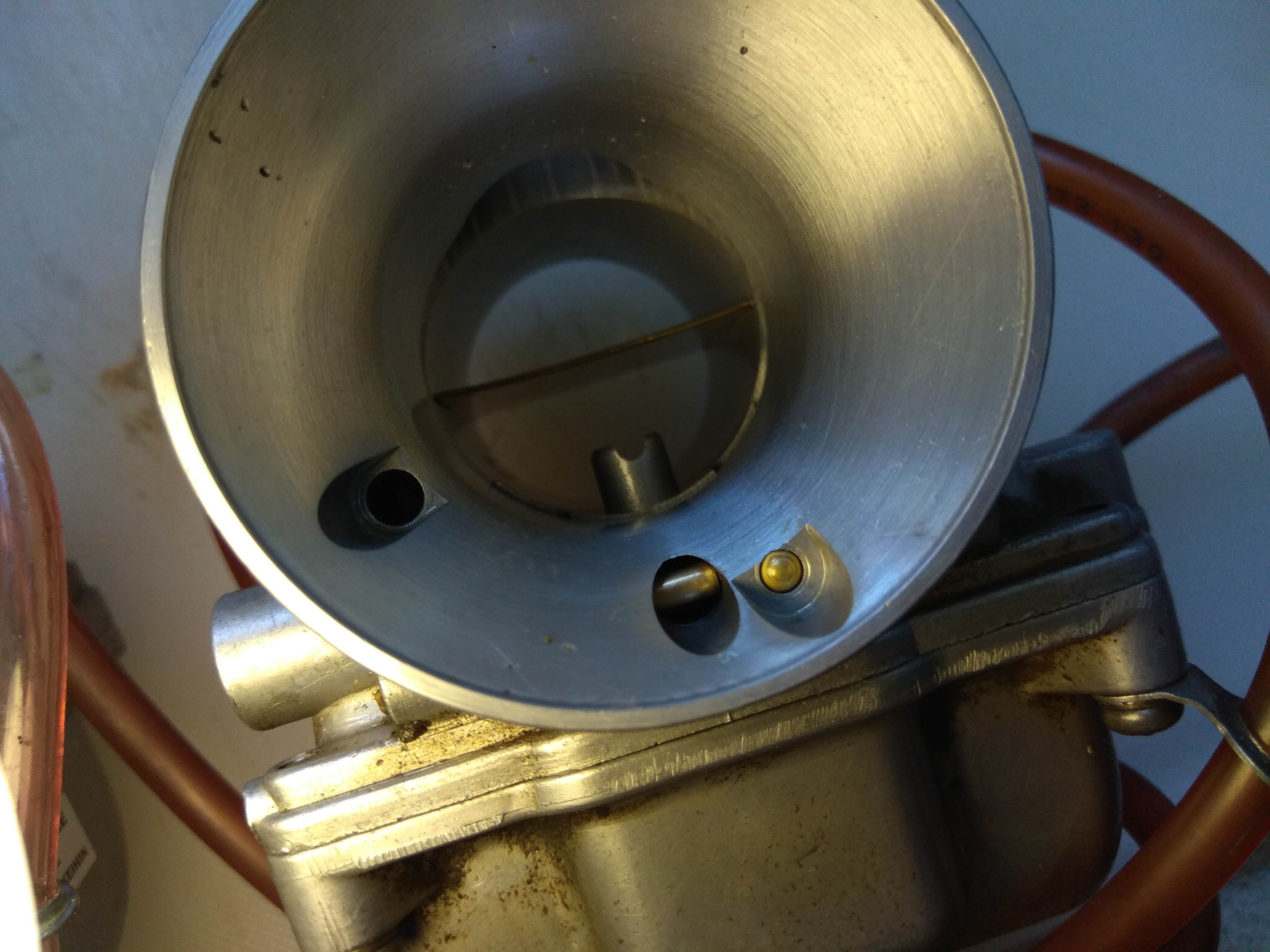

i recently installed a chinese copy 33mm pwk and although it runs not perfect but not bad it is way better than the rb modded carb that i have been struggling to tune for 2 years now. the chinese copy carb actually idles where as i could never get the rb carb to idle. on closer inspection the mixture screws although identical sit completely differently when in the carb ,shown in the photos is exactly 1.5 turns out on the mixture screw. i have a feeling that the rb carb mixture system is worn out and really 1.5 turns out is starting from zero. would anybody be able to post a photo of their mixture screw at exactly 1.5 turns out so i can compare and prove my theory. cheers guys
- rb carb
- IMG_20191118_155554.jpg (812.62 KiB) Viewed 2895 times
- chinese copy
- IMG_20191118_155641.jpg (663.46 KiB) Viewed 2895 times

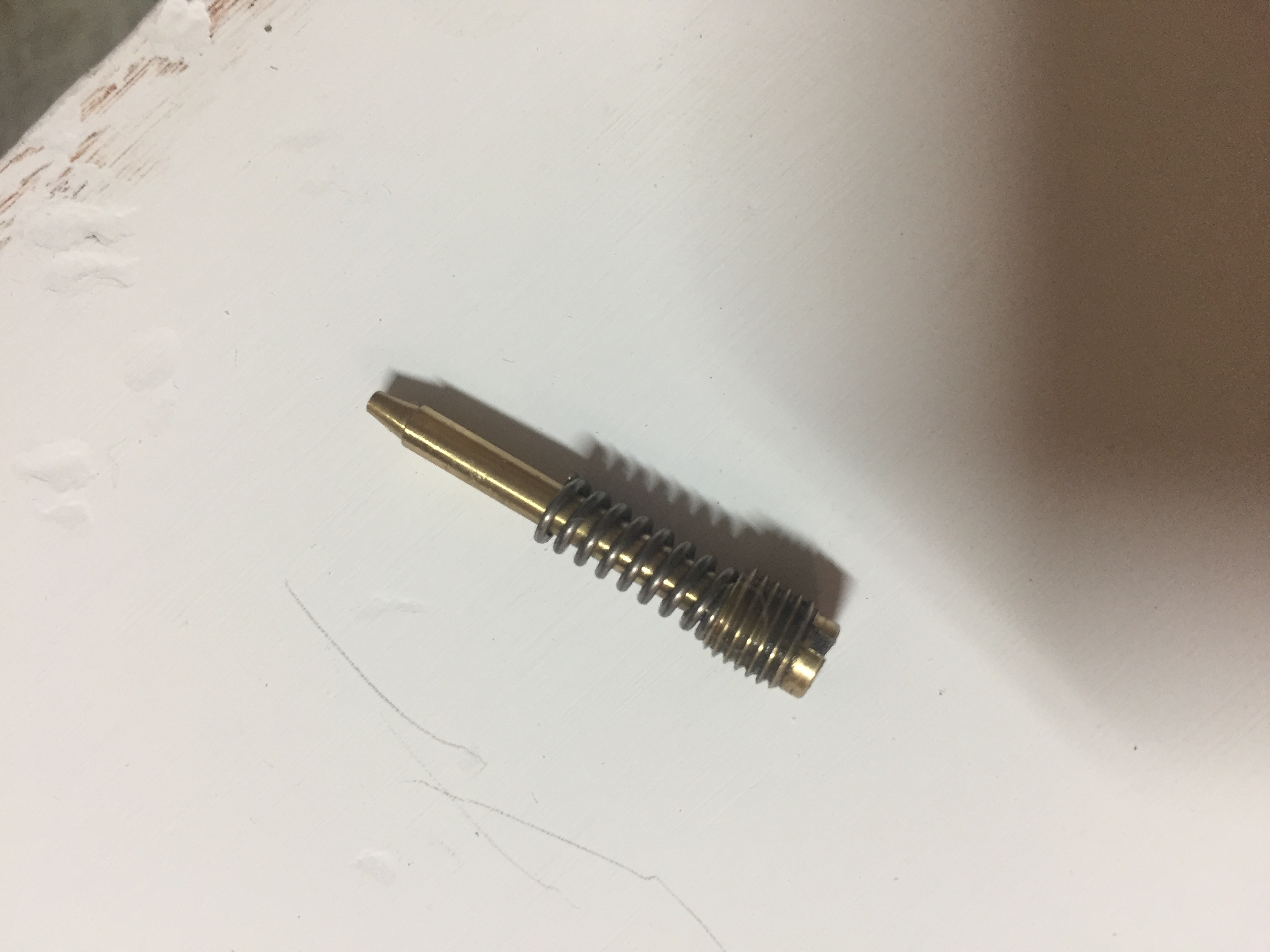

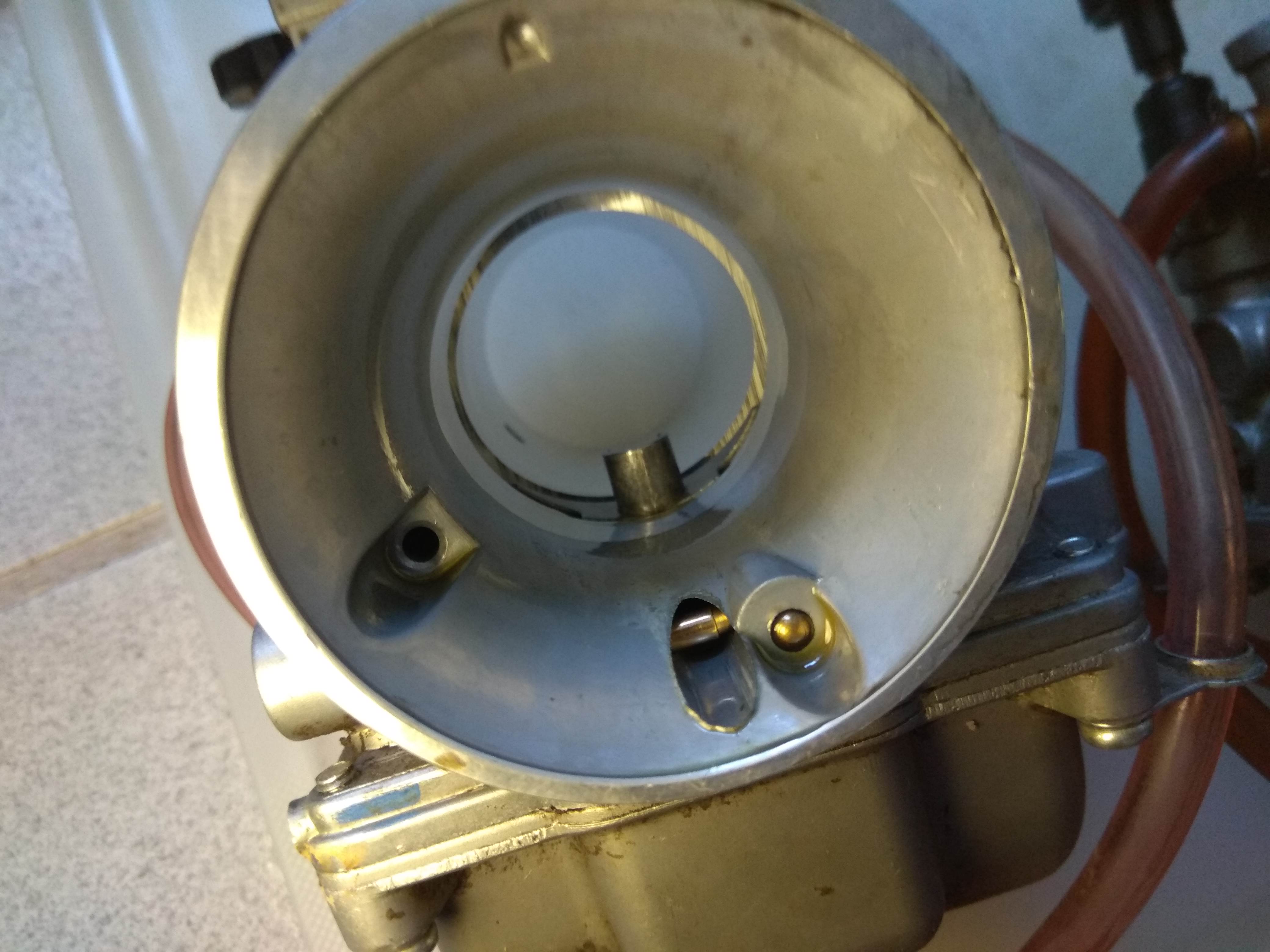

Try again on pic.
- 1035CCD0-021B-4945-A315-4D4559790E5D.png (1.74 MiB) Viewed 2846 times

Maybe same screw. I can measure if it helps test your theory.
- DCB48854-C810-4DEC-BB7C-A087676A0DD2.jpeg (1.26 MiB) Viewed 2846 times

thankyou goat that helps alot although it looks like my theory is completely wrong, yours is almost the same as my rb carb. i noticed your carb also has the notch cut out where the needle is, is yours an RB carb or is that standard on airstrykers
