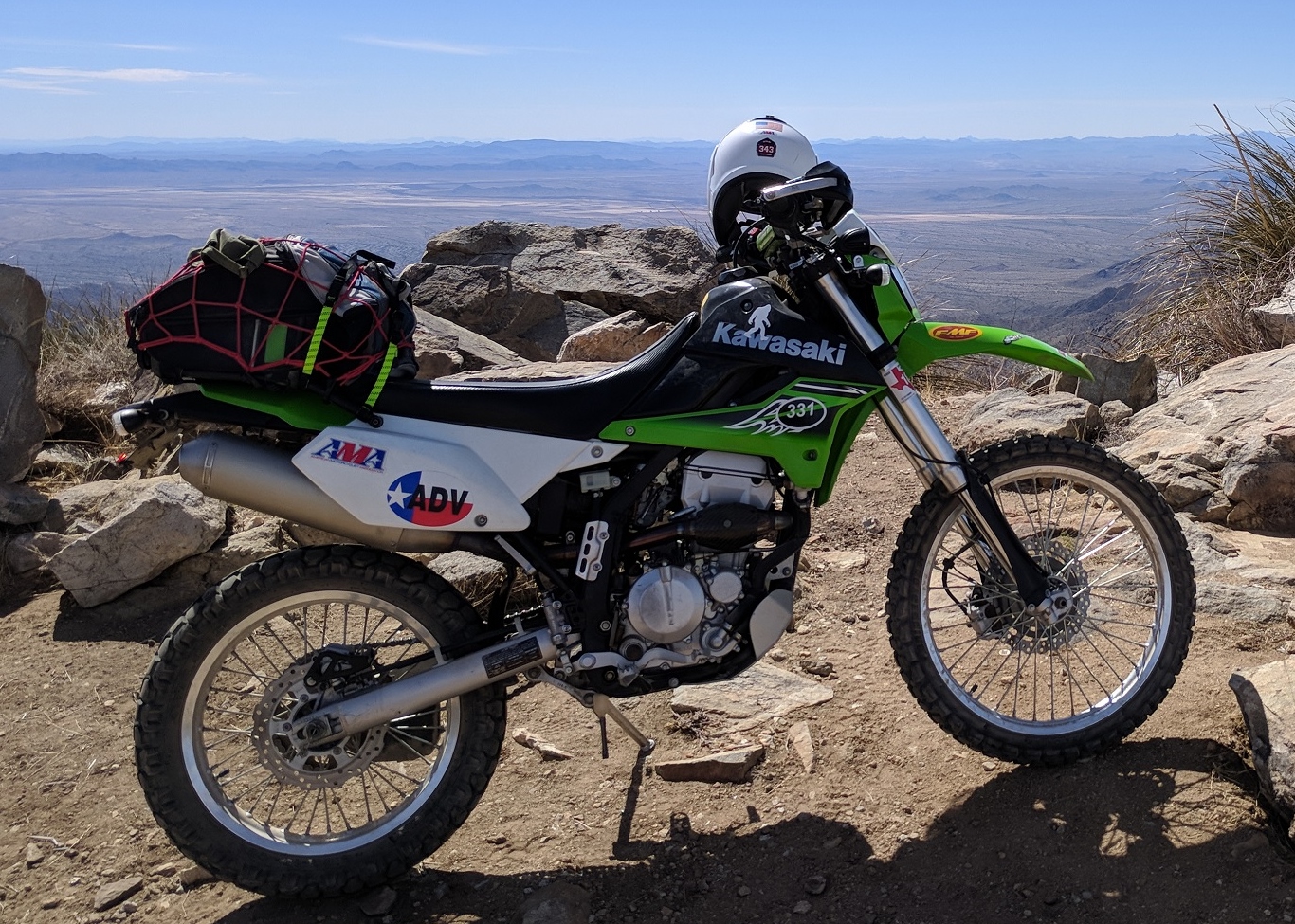

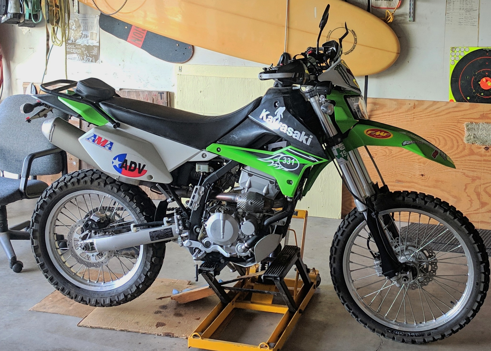

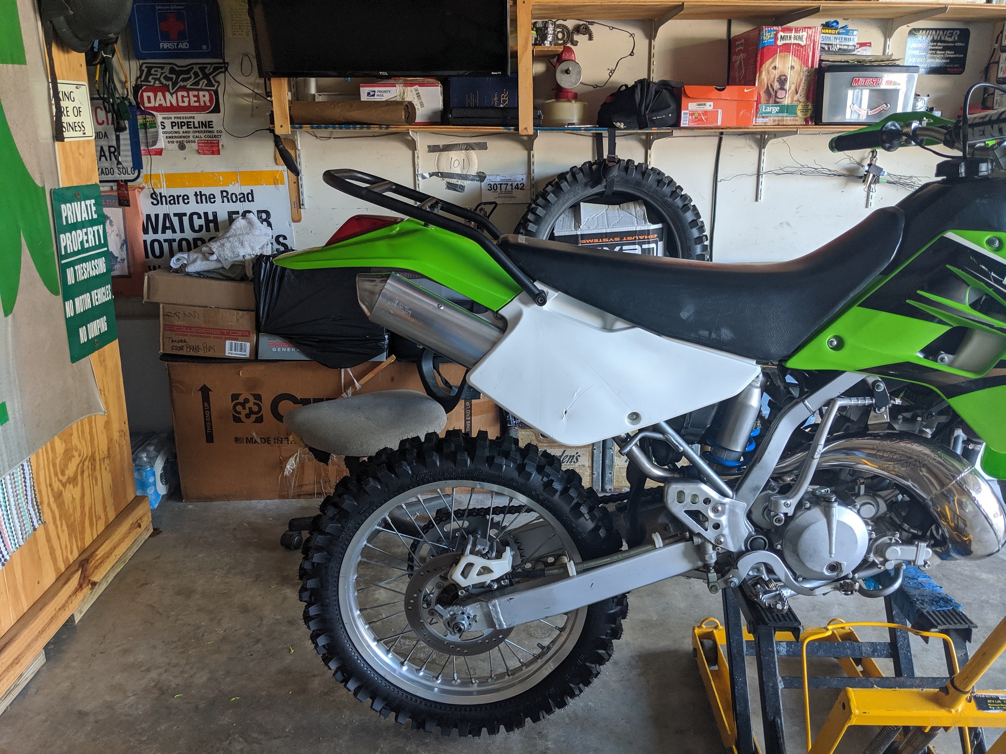

Had some time to see if the Nomadic Rack I have on my 2010 KLX 250 would fit on my 2004 KDX. To my suprise, it wasn't off that bad. The only mod I had to do was drill a couple of holes in the fender just behind the holes for the tool bag. With a couple of long bolts, a couple of fender washers and nylon lock nuts, the rack is now a fixture on the KDX. I've attached some pictures first showing the rack on the KLX (no load and loaded)and then on the KDX after the install.

I agree, as you can see a tool bag in picture of the KLX with the rack unloaded. It's still there in the loaded picture, just can't see because it's under that tail bag.

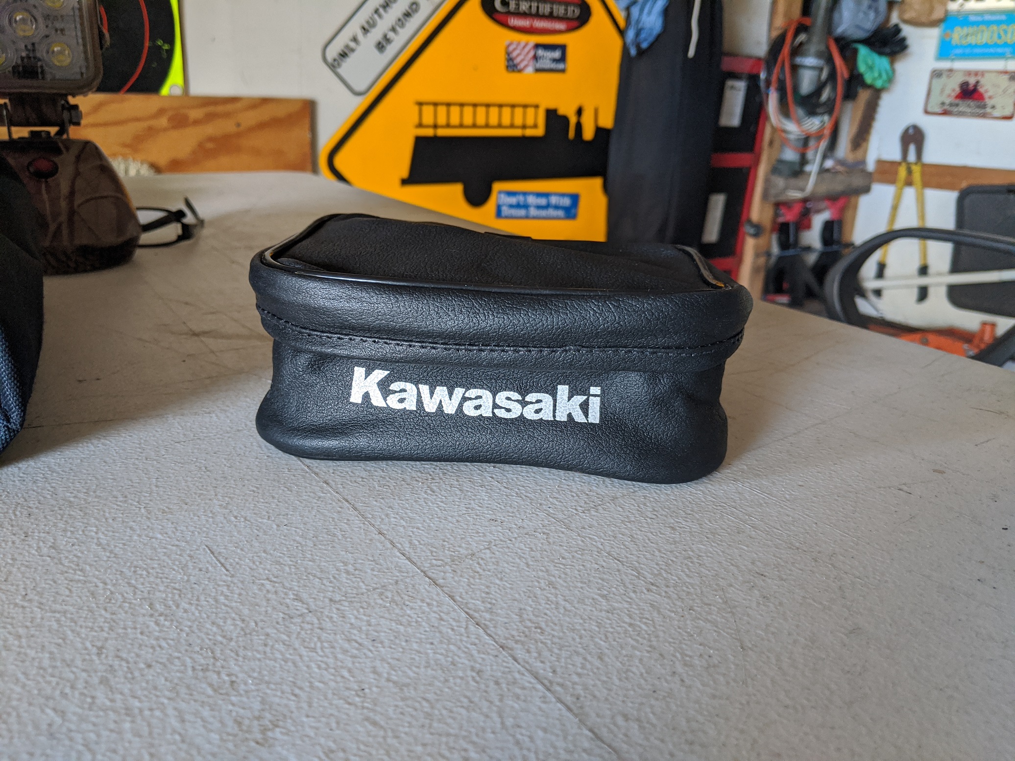

I did use the tool bag from my KLX to get an idea how well it would mount on the KDX between the rear of the seat and the newly installed rack. It fits, but won't line up with the existing holes. Not a big dea, just drill some new holes in the fender. I didn't want to use the OEM bag from my KLX (because it's going back on the KLX) so I ordered an aftermarket one that is the same size as the OEM. I'll post a picture or two when it's on the KDX. Hoping it gets here soon. The wife and I are going to some relatives for Thanksgiving and there's a huge OHV park about 40 minutes away. Play time for Dave!

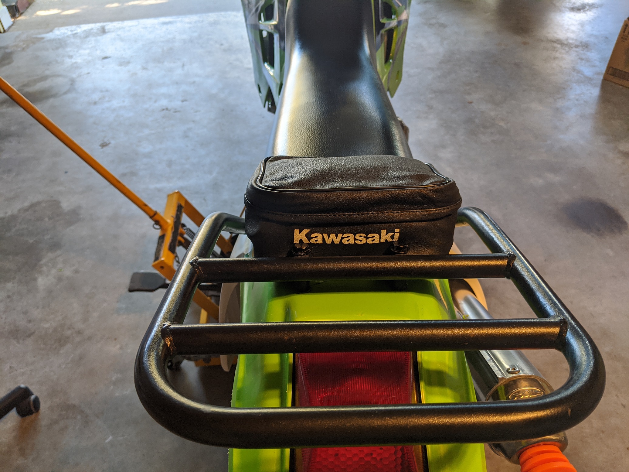

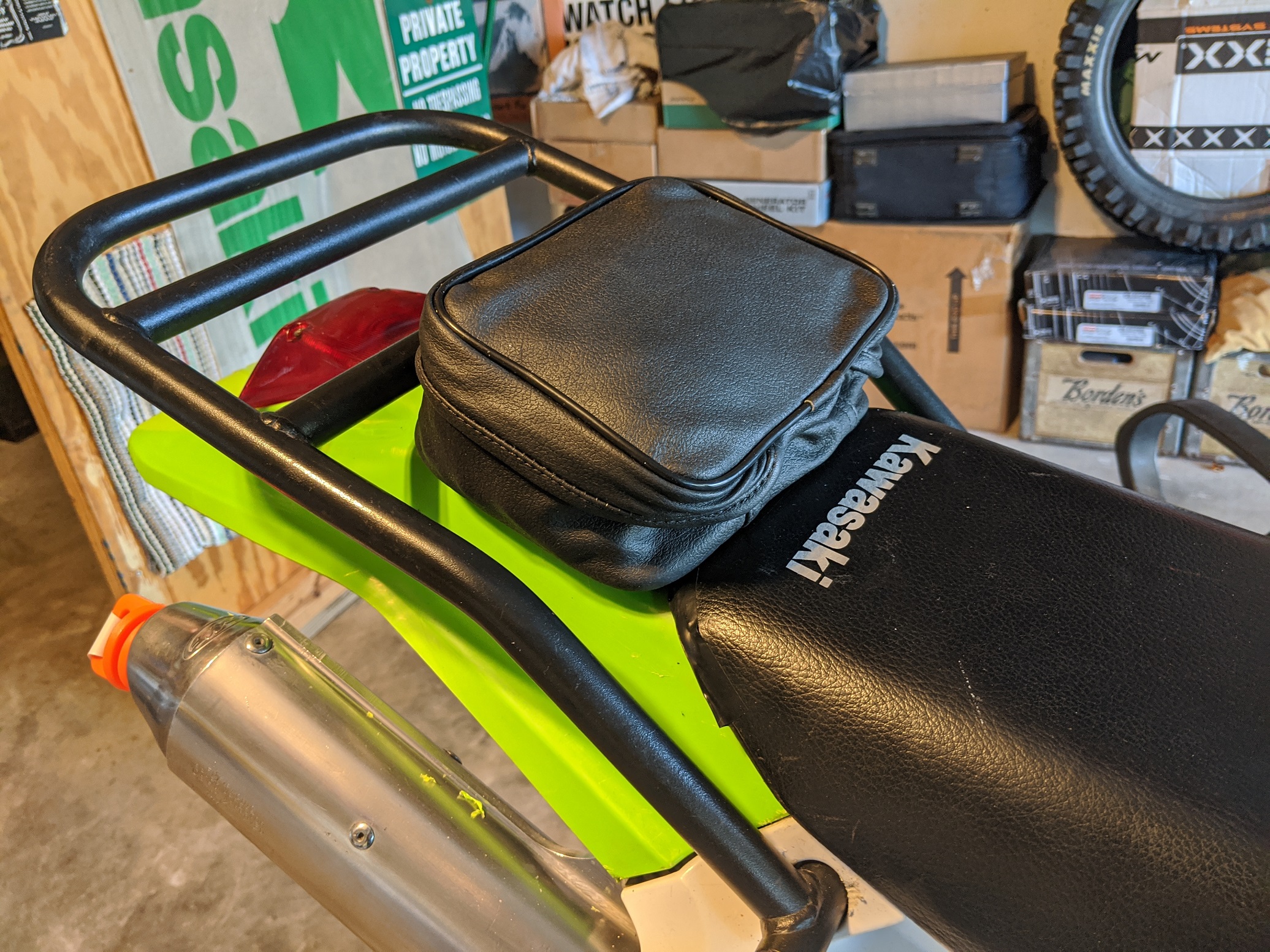

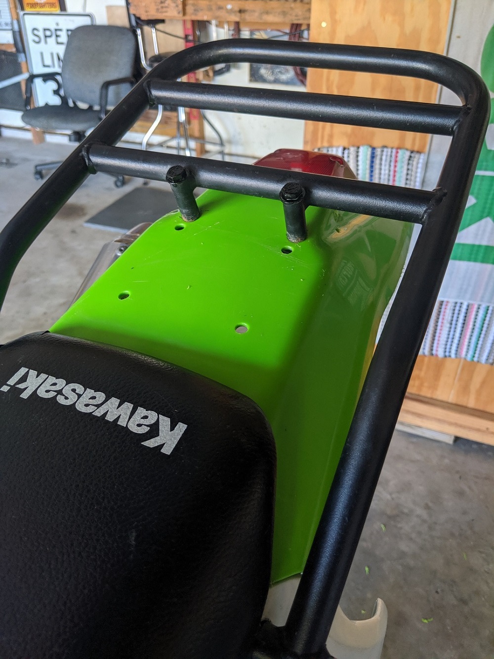

The tool bag that I ordered showed today, which was an unexpected, but pleasant suprise. The company I ordered it from (Bolivaxport) was supposed to notify me when it shipped along with a tracking number. All told it took 10 working days from the time ordered to delivery. I'm just glad it's here and it came as I'm preparing to visit relatives for Thanksgiving. Which, once the wife heads back home, I'm off to the nearby OHV park for a couple of days of camping and riding. So of course I went right to work getting it mounted. If I say so myself, it filled that space between the rack and the seat pretty well.
KDX Bag - Copy.jpg (1.16 MiB) Viewed 4157 times
KDX bag rear.jpg (962.05 KiB) Viewed 4157 times
KDX bag R.jpg (1.18 MiB) Viewed 4157 times
The total pacakge
KDX wbag.jpg (1.4 MiB) Viewed 4157 times
