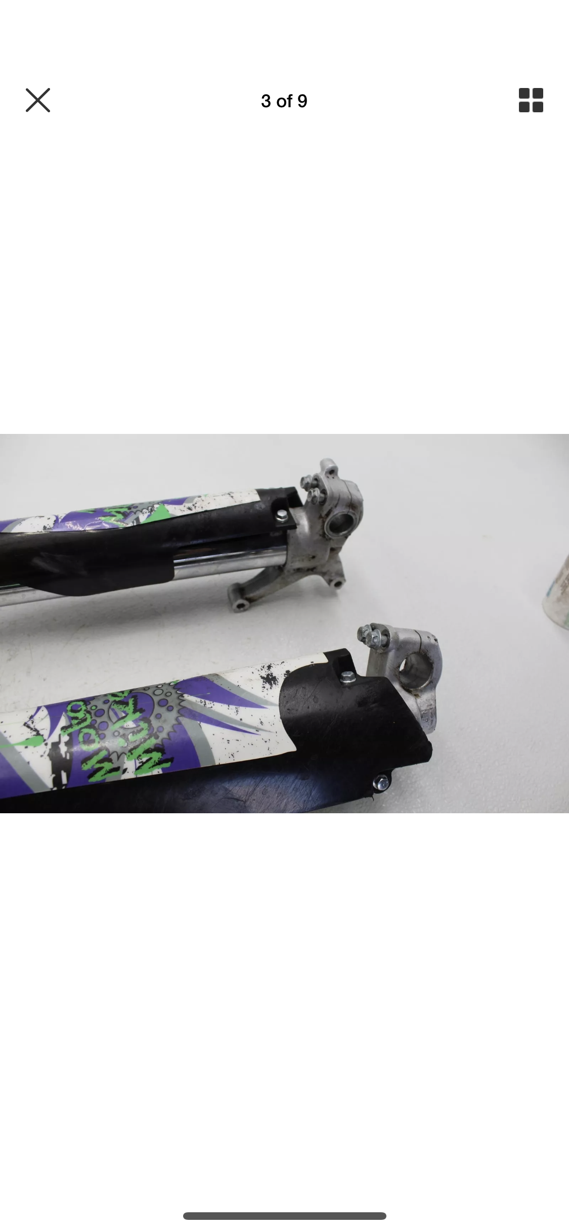

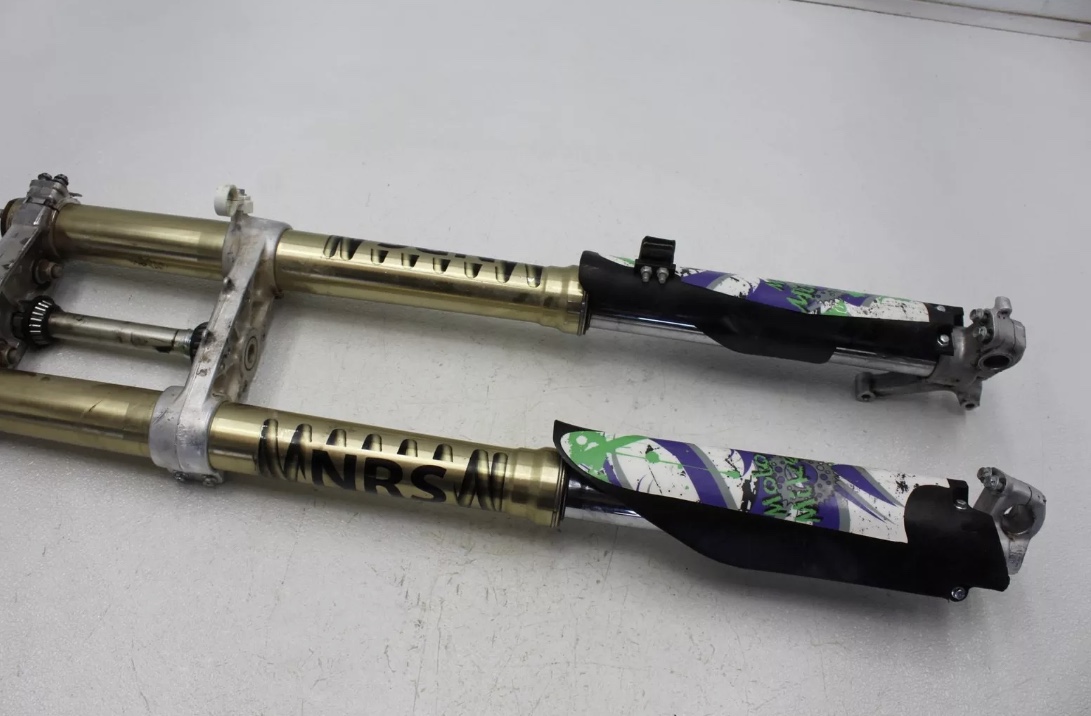

I picked up so forks that I thought came off a 1993 kx500 but after bolting them onto the KDX the KX axle isn’t tight. I’ve posted some pictures to see if someone can help me identify them.

Those are not Kawasaki KX 1990 - 1998 fork lugs. It kind of looks like 1999 or so, but the little ring portion makes me wonder.
Do you have any pictures besides that one?

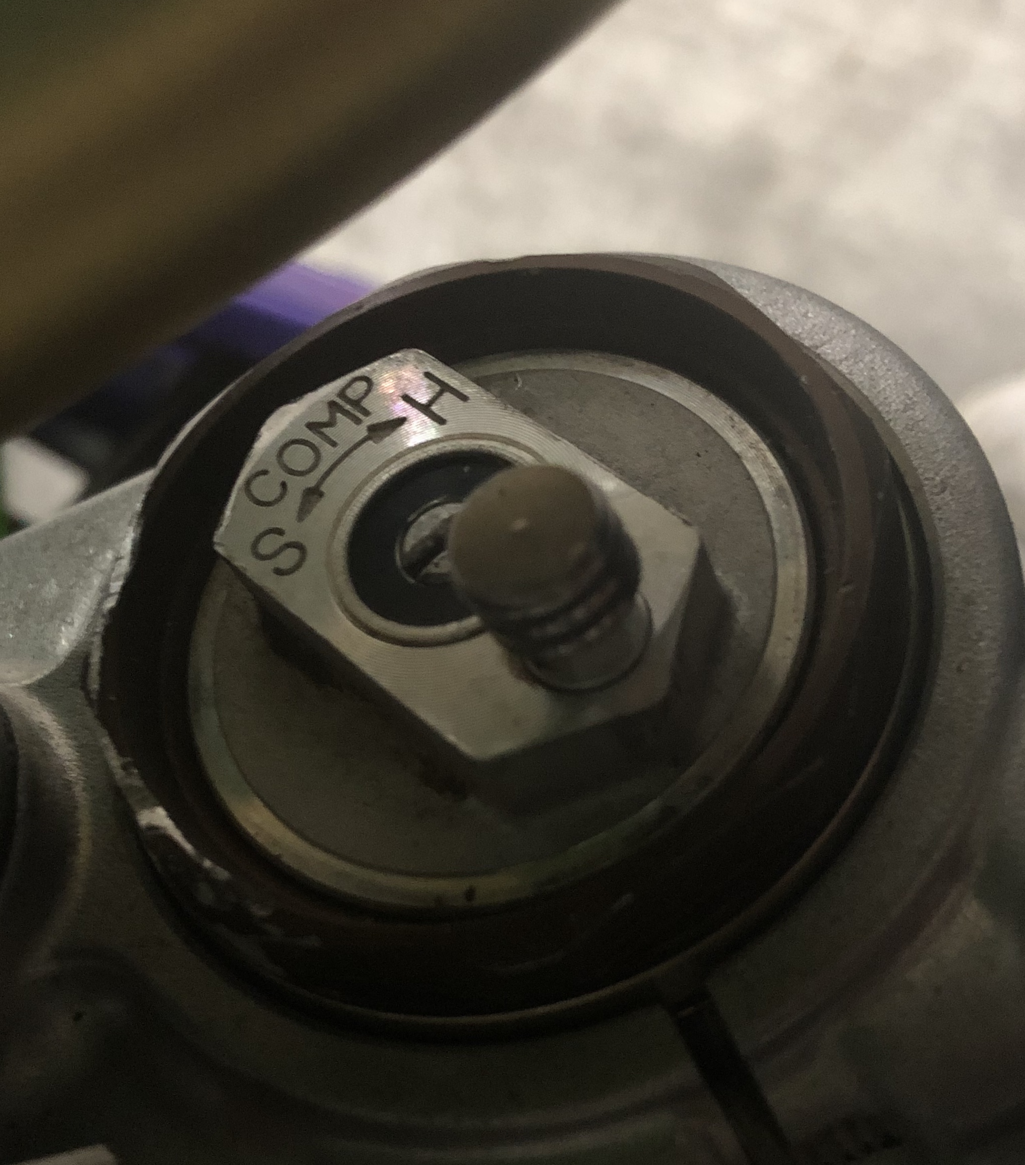

Here you go. From looking at bikes is this maybe off a kx450?

Re: KDX fork conversion
After a little research, that's not 1999.
After seeing the pic, those are Showa, not KYB. You might want to look at Honda or Suzuki models. NOT Honda, Kawasaki or Euro.
Well, not KX two-stroke anyway. Maybe 2006 KX250F and newer, but definitely Showa top.

What does it say underneath the upper clamp?

Does this help?

Those are twin chamber Showa forks. They are off an '08-'12 Suzuki RM250F/450F.

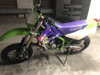

I finally finished the conversion. Pretty easy swap and it’s looking good. I do like the feel of the new forks.

Looks good!
