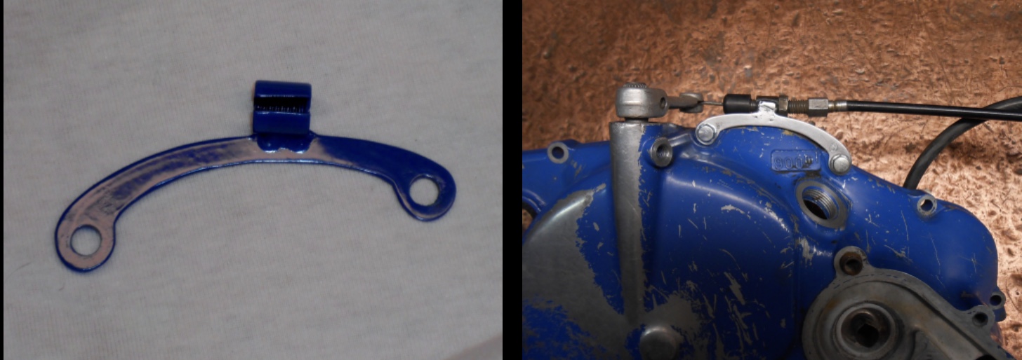

Suzuki quad racers had a similar problem. I don’t know what the side cover looks like but possibly a bracket like this maybe an option?
