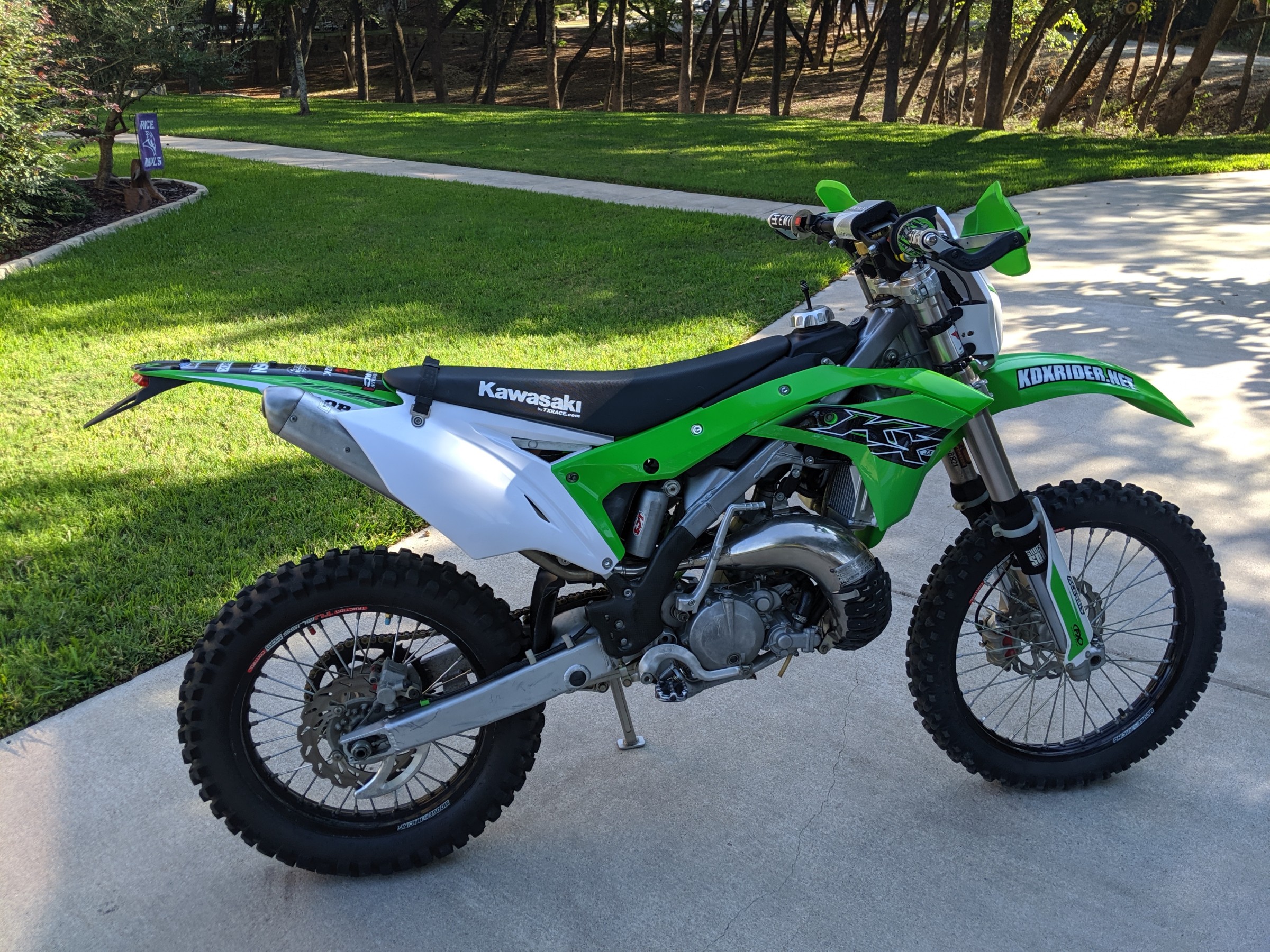

So summertime riding is miserable and borderline dangerous here in Texas. The heat and humidity are just too much at my age. Summer is my time to tear the bike down and give it a refresh...grease bearings, fork oil, etc, etc. all the stuff I neglect during my riding season (OCT-MAY).
This year I decided to do a refresh of the plastics after hearing about the TX Race kit. This is a bolt on kit designed for the '03 and up KX 125 and 250. The plastics are 2017-2019 KX 250f. The engineered brackets and other misc parts are what you're really paying for. Also included is a new seat which closely resembles the 250f seat. It actually has more padding than the OEM KX 125 seat :grin: Still not the la-z-boy KDX seat though...but much better.
The assembly is fairly straight forward and the instructions are adequate to make it happen. My only minor issues with the kit were the allen head bolts. Too many years of taking the plastics off with an 8mm socket. So I replaced the majority of the allen head bolts with 8mm bolts I had on hand.
I like the results.
IMG_20191002_163804 - Edited.jpg (792.53 KiB) Viewed 12895 times

Posts: 3557
Re: Updated look on the Hybrid
That looks nice! Been wanting to update my hybrids look, based on a 2001 KX unfortunately.
Posts: 6152
Has thanked: 10 times
Been thanked: 12 times
Sweet looking ride! How much did the kit set you back?
Posts: 14670
Has thanked: 52 times
Been thanked: 18 times
MAN, YEAH! That is really nice!! Congratulations.

Nice job.
Posts: 1690
That actually looks pretty good!
Post by TwistedRoot »
Whoa! Looks awesome. Why cant KAW release a production model like this!?! Great job!

Thx guys. It wasn’t cheap, but a lot cheaper than a new bike. Here is the link for it if anyone is interested.
https://www.txrace.com/shop/tx-race-res ... f18f422eef
Shipping and customs fees from Spain adds around $100 to the cost.

Post by VTMTcowboy »
B737driver wrote: 09:51 pm Oct 03 2019 IMG_20191002_163845 - Edited.jpg
Absolutely beautiful bike all around! I would think this is what a new KDX might look like.
