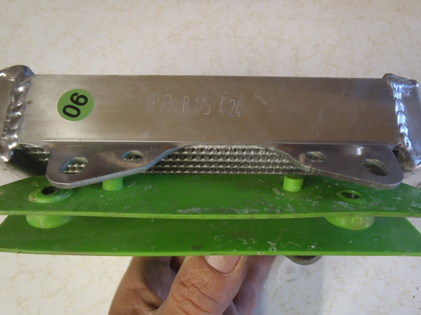

I tried GPI radiators for my 91 KDX200E and left side fit good. Right side... not at all.
P9200004 - Copy.JPG (139.05 KiB) Viewed 2556 times
Posts: 739
Joined: 08:28 am Apr 21 2019
Location: North Cackalack
Re: radiators
Post by kdxsully »
Maybe it was mislabeled and they sent you the wrong one somehow
