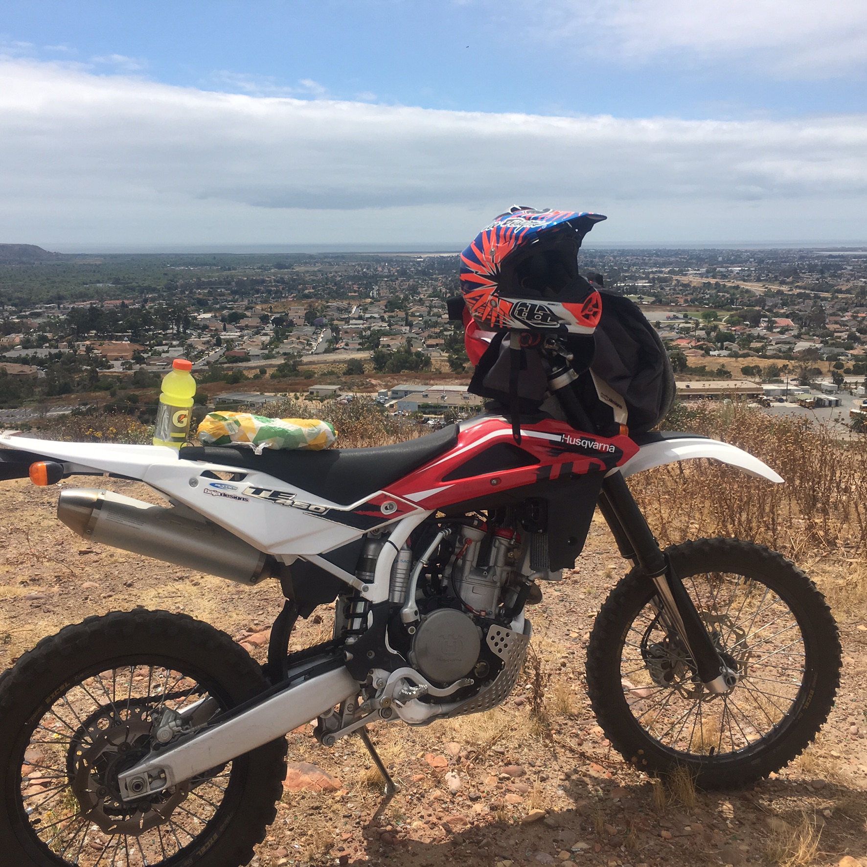

I also "cheated" on the KDX last week but I need a plate, so that is my excuse haha.

Shame! Messing around with those Italian trollops. SHAME!VTMTcowboy wrote: 10:29 am Aug 14 2019 I also "cheated" on the KDX last week but I need a plate, so that is my excuse haha.

I thought they were Swedish?SS109 wrote: 12:29 pm Aug 14 2019Shame! Messing around with those Italian trollops. SHAME!VTMTcowboy wrote: 10:29 am Aug 14 2019 I also "cheated" on the KDX last week but I need a plate, so that is my excuse haha.![]()

Sadly, Husqvarna bikes haven't been Swedish since 1987. They were bought out by Cagiva, which is Italian, and moved production there. Then in '07 they were sold to BMW, yet still built in Italy, until Pierer Industrie AG/KTM bought them. Now they're made in Austria.

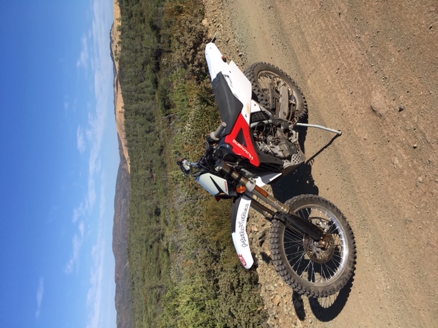

I believe this was a Cagiva built Husky. 2007, So the first year it came US 50 State street legal from the factory. In CA that is a big plus. I picked it up last year for pretty reasonable because I didn't want to take a loan out for a new Beta or Husky 350. It allows me to ride more often as I use it to commute to work 3 days a week. I've put a good chunk of change back into it on basic maintenance because the PO neglected it pretty good despite only having 1k miles when I bought it. Unfortunately I just keep adding more aftermarket parts to it haha. I've tracked all the purchases and paid labor through a spreadsheet and I am still at least half of a new bike, so that at least makes me feel ok about it haha. I'll never get back what I've put in, but oh well, that is part of the game. Sure has a ton of power and still feels reasonably light for a 510.SS109 wrote: 07:13 pm Aug 14 2019Sadly, Husqvarna bikes haven't been Swedish since 1987. They were bought out by Cagiva, which is Italian, and moved production there. Then in '07 they were sold to BMW, yet still built in Italy, until Pierer Industrie AG/KTM bought them. Now they're made in Austria.
