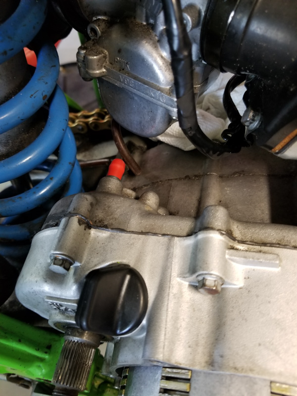

2) The attached pic: I stuck the red plug on the open nipple for now. Nothing was attached and I cant seem to find a diagram that says what it is. I am assuming its the trans case breather? What should go there? A hose dumping to the ground?

2. Usually a plastic 90 degree elbow and a hose going down. Try Lowe’s for one that will fit. Or eBay search the part number. Use the parts diagrams on partzilla.

2. p/n 92190-1007 tube, about 30$, or any rubber hose the correct diameter to fit, run it up to the airbox, theres a hole near the top it passes through

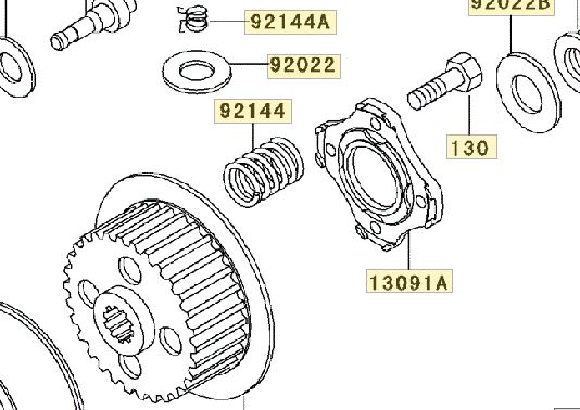

1. There's a couple ways to tighten the clutch nut. I remove the clutch spring holder (pn 13091A in the image) and then put fender washers on the clutch spring bolts. Just snug them down on the springs and you'll lock up the clutch. I then put a penny between the clutch gear and the crank gear and torque away. Another way is to use a piston lock up tool that threads into the spark plug hole. I use this when working with the flywheel.

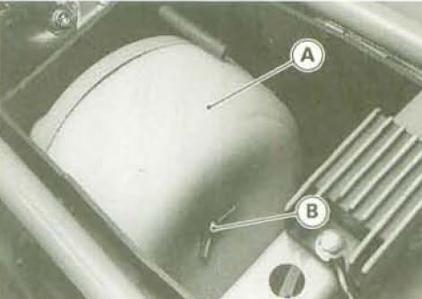

2. The transmission breather has a rubber hose leading to a hole in the airbox. In the photo below, you can see the location of the hose above the air filter.

I wondered what that hole was in the airbox! Great thanks.

Hose definitely goes up into the airbox on 1986 and newer.
