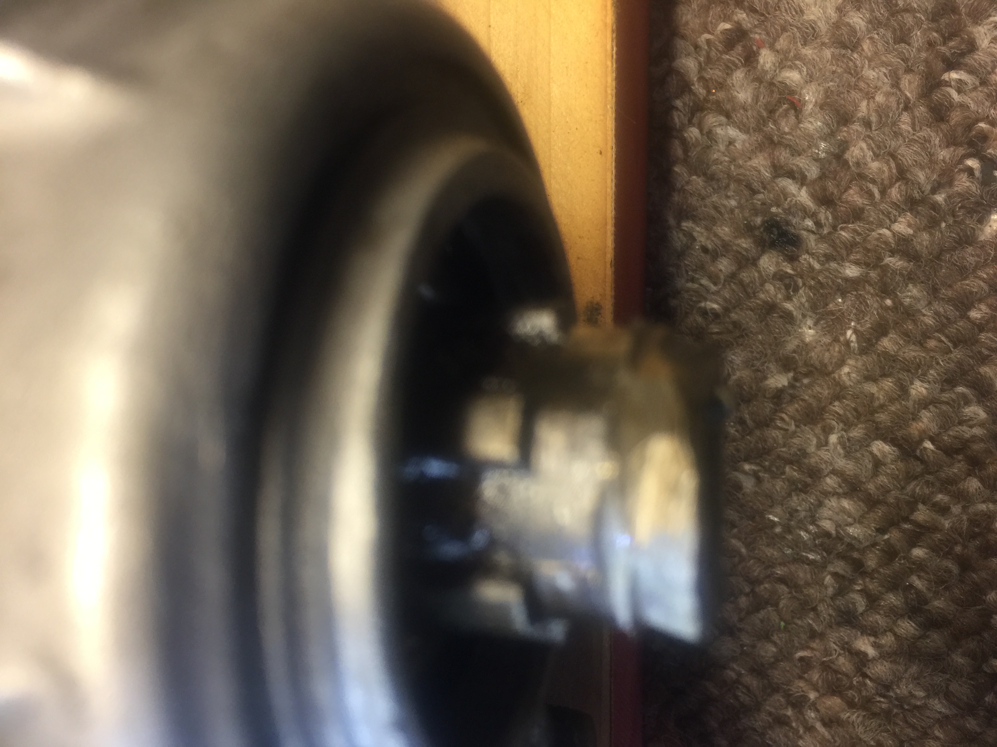

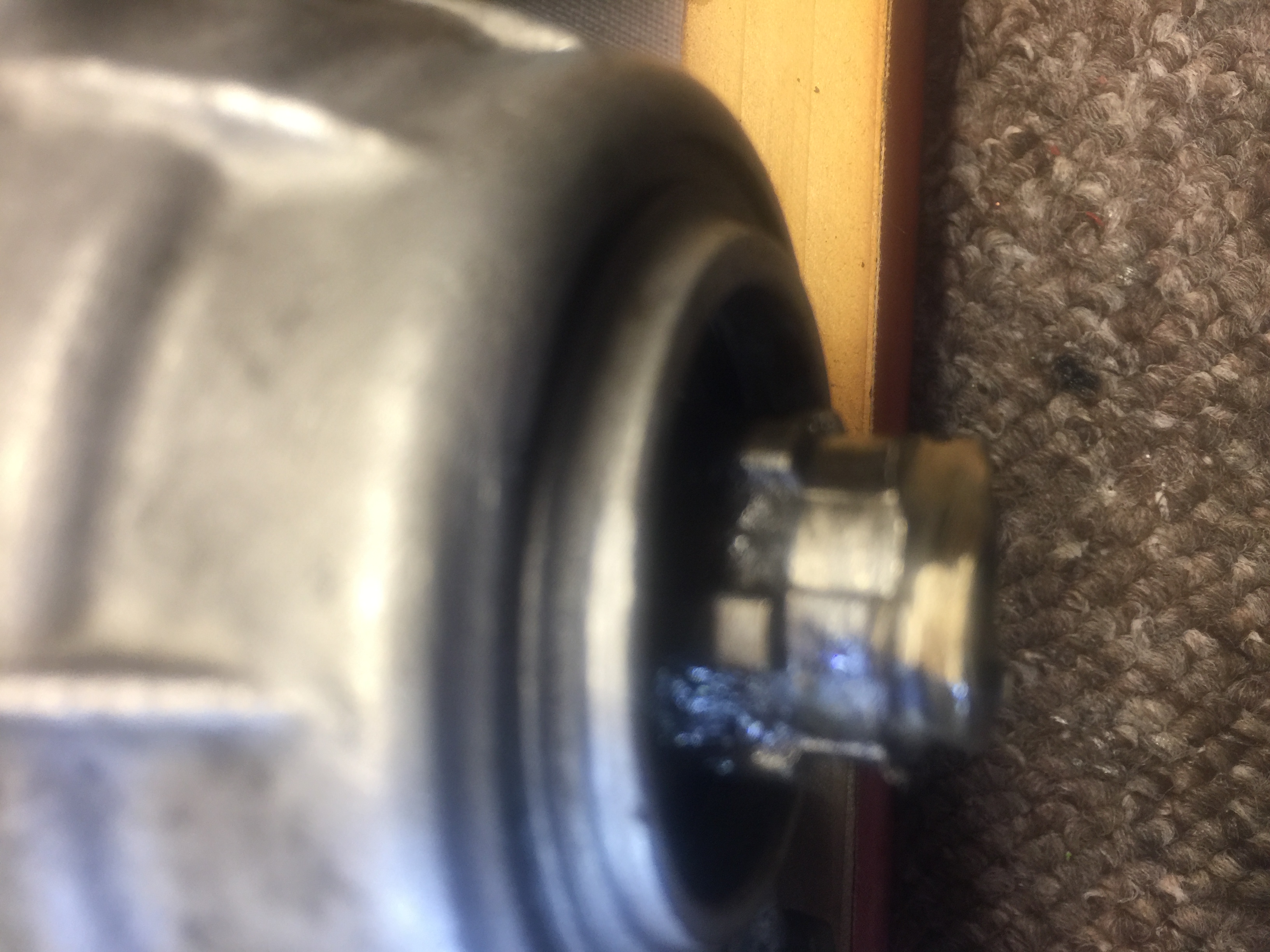

Re: Welded front sprocket
Where have my spines gone that’s why it was welded when I turn this shaft the input shaft does not turn straight away seems to turn a little bit first is this normal
Ouch! That parts got to go.
Dang. Wonder what the splines look like on the cs sprocket. Heat treating gone awry?
