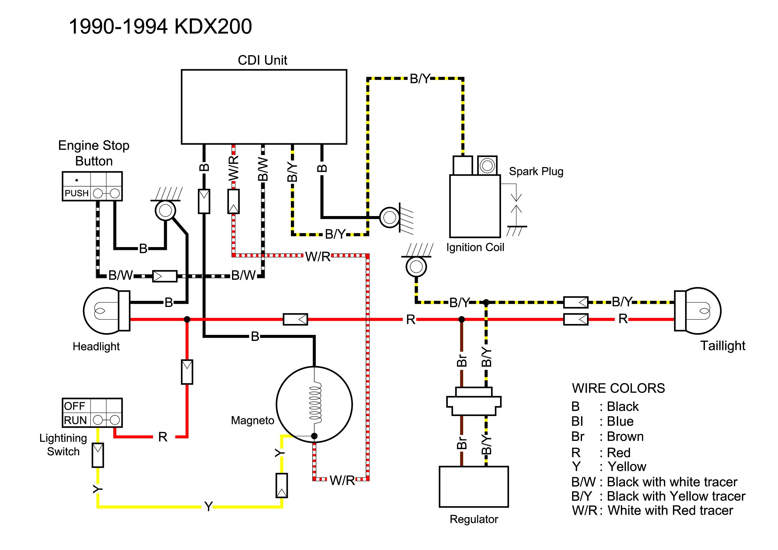

Kdxsully is correct, a meter won't tell you if the CDI is good or not, if it was running prior to pulling the cover then it didn't magically die. What else did he take off? Just the cover won't cause the bike to stop running. As mentioned, clean all your grounds well, new plug. Your secondary coil should be 5,000 - 6700 ohms, the primary winding should be 0.8-1.2 ohms, and your plug wire lead (plug cap) should be in the 4,000- 6,000 ohm range. You can also check your exciter coil (the one on the stator plate under the flywheel that feeds the CDI the firing pulse) by checking between the White/red wire and the black wire coming out of the case, should be 300-450 ohms, though if its reading 19VAC it's likely good. You can check the CDI by pulling the Black/yellow wire of the coil and hold it while you kick, it will shock you if working like kdxsully said. There should only be one wire from the CDI to the coil, black/yellow. The other black wire is a ground that often gets connected to the ground post of the coil, but you can connect it to any good ground, Double check and make sure if its attached to the coil that it's in the right place.
- 1990-1994_KDX200.jpg (254.78 KiB) Viewed 7280 times
