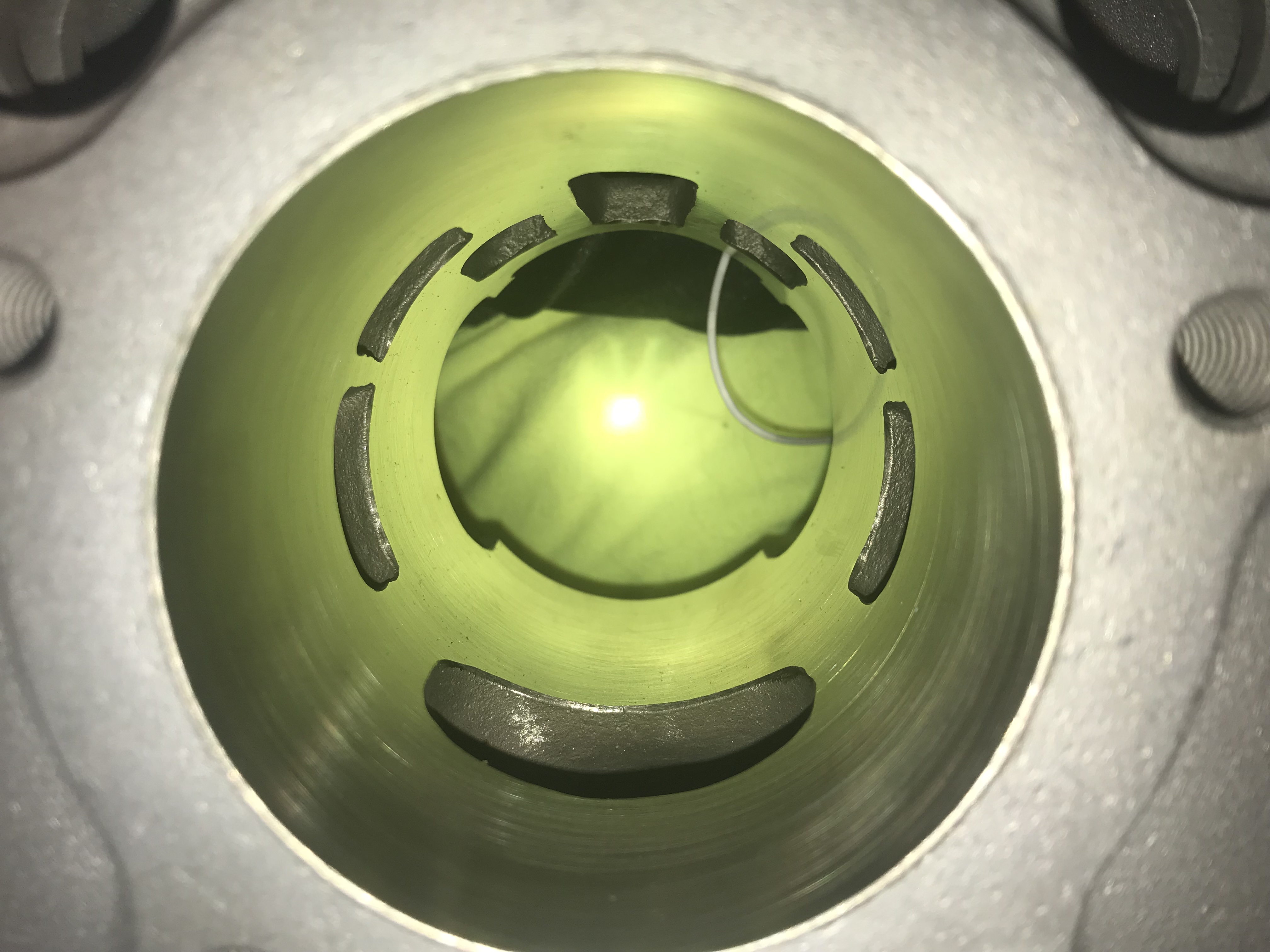

Guess we’re gonna be rolling up our sleeves!
What do you guys think, bore this out or buy a virgin cylinder and send it to be plated??

I'd send it to a motorcycle shop for boring and honing and go with the oversize.
The sleeve does not look 100% lined up. What does it look like to you?

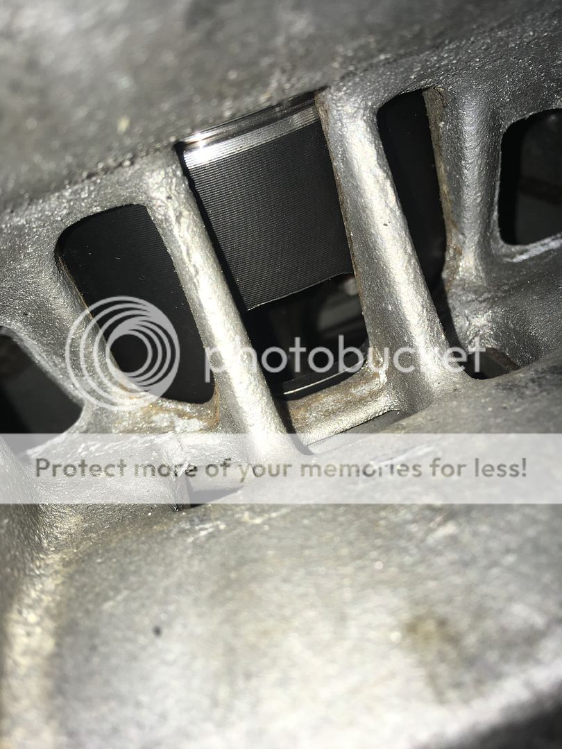

1988 crankshaft side to side play standard is .5mm, service limit is .7mm. I’m at .55mm, so we’re okay in bottom.
To address the sleeve, I’d have to say this sleeve was probably made for 86-88, because there’s two small ports just above each side of the exhaust port that I’m assuming would be for the power valve. I’ve never seen a powervalver cylinder so I wouldn’t know for sure. All the ports line up well except the exhaust port. It looks like some trimming was done. Not too bad. One of the transfer ports has some sharp edges on the intake side (unrelated to the sleeve). Should these be cleaned up before I go with an oversized piston?? Can I even get an oversized piston to fit this bike? Being that all oversized pistons are 86 and up, I’m assuming. I was gonna put a wossner in this for the higher chance of not needing any modification.

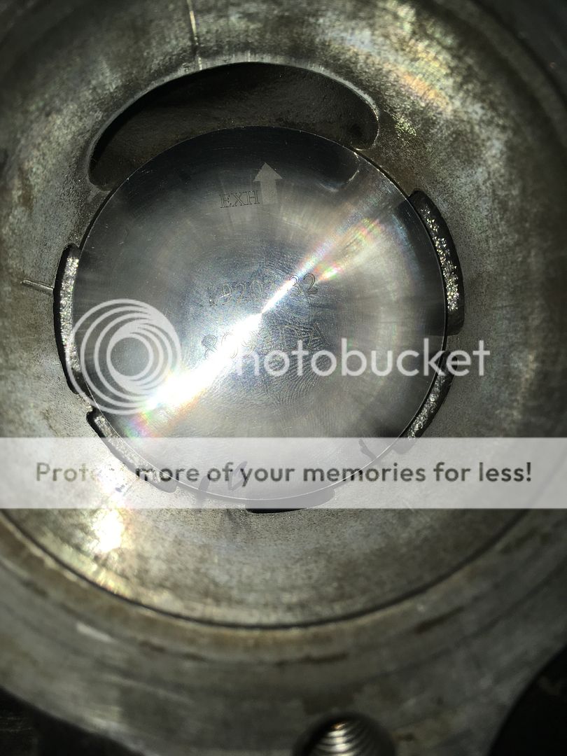

Hmm! With it being the '84, that is bad on the piston.
How do the piston pins align with that sleeve?
A motorcycle shop may be able to handle that sleeve better than a general machine shop.

I’m looking into getting an unsleeved cylinder.
You mean the ring pins right? I’ll just take a photo later

I can get actual angles and stuff at work tomorrow. They have a digital protractor. I also tried to do my best to measure from the bottom on the pin hole to the bottom of the skirt. I saw somewhere a guy had to cut 3mm off of his skirt, so I figured having that measurement could be helpful. I can measure to the crown later too, that’s probably a better measurement anyways (don’t know why I did it this way, that was awkward). That thick line on the piston is the exhaust arrow. ‘B’ is the bottom ring, ‘T’ is top.
Also, these aren't super exact. I'd have to rig up the piston on te crank and slide the cylinder over to get a perfect one. But these sre pretty dsng close.

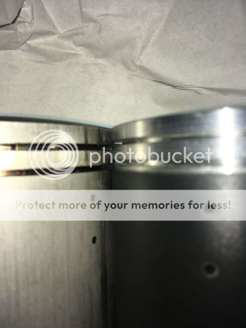

Some of you already know, I bought a virgin '85 cylinder on feeBay. I sent it off to PowerSeal for replating. I did do some piston tests with it before sending it off.
The 86-06 Wossner piston does indeed fit, and the ring grooves are located higher on the piston than the others. I marked the pin locations and the one with the 'B' is the bottom pin. Thanks, KDXGeoff.
These aren't perfect because they were in my lap. Basically, the bottom of the Wossner grooves are lined up with the top of the grooves on the Chinese piston.
Disclaimer to 83-85 owners. Try a Wossner, but check everything. Pretend I'm lying first.

Thanks for the pictures.
Thanks again to KDX Geoff

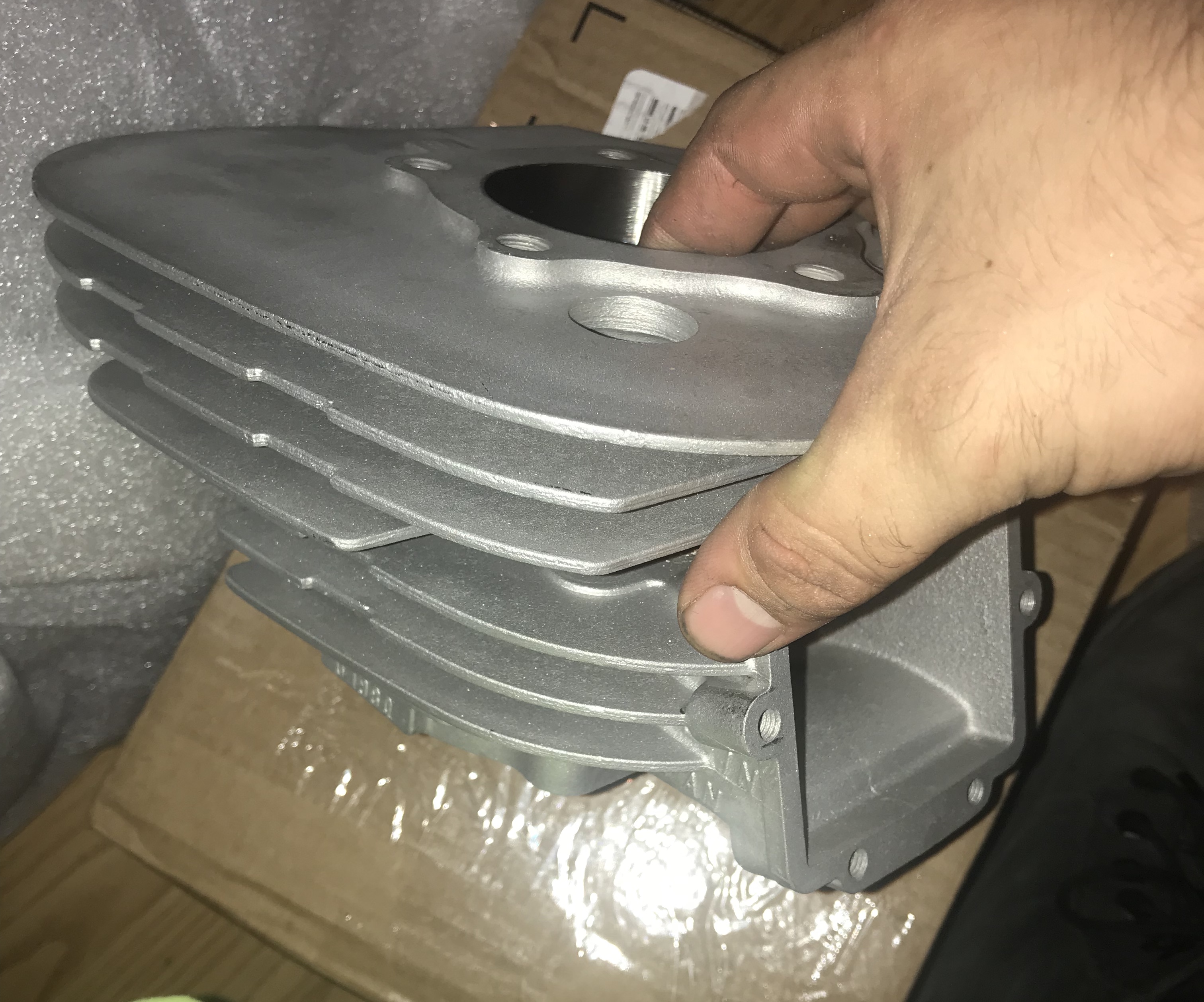

Got the cylinder back from PowerSeal. Beautiful. I’m a bit disappointed in the chamfering. I’d correct it, but this being my first time I REALLY don’t wanna damage it.
Hmm, something isn’t quite right...
Posts: 14676
Has thanked: 67 times
Been thanked: 20 times
Re: Yet another rebuild thread
Looks great to me! What am a I missing, no paint?
Posts: 739
Joined: 08:28 am Apr 21 2019
Location: North Cackalack
Post by kdxsully »
KDXGarage wrote: 04:57 pm Aug 03 2019 Looks great to me! What am a I missing, no paint?
It’s supposed to be black!!

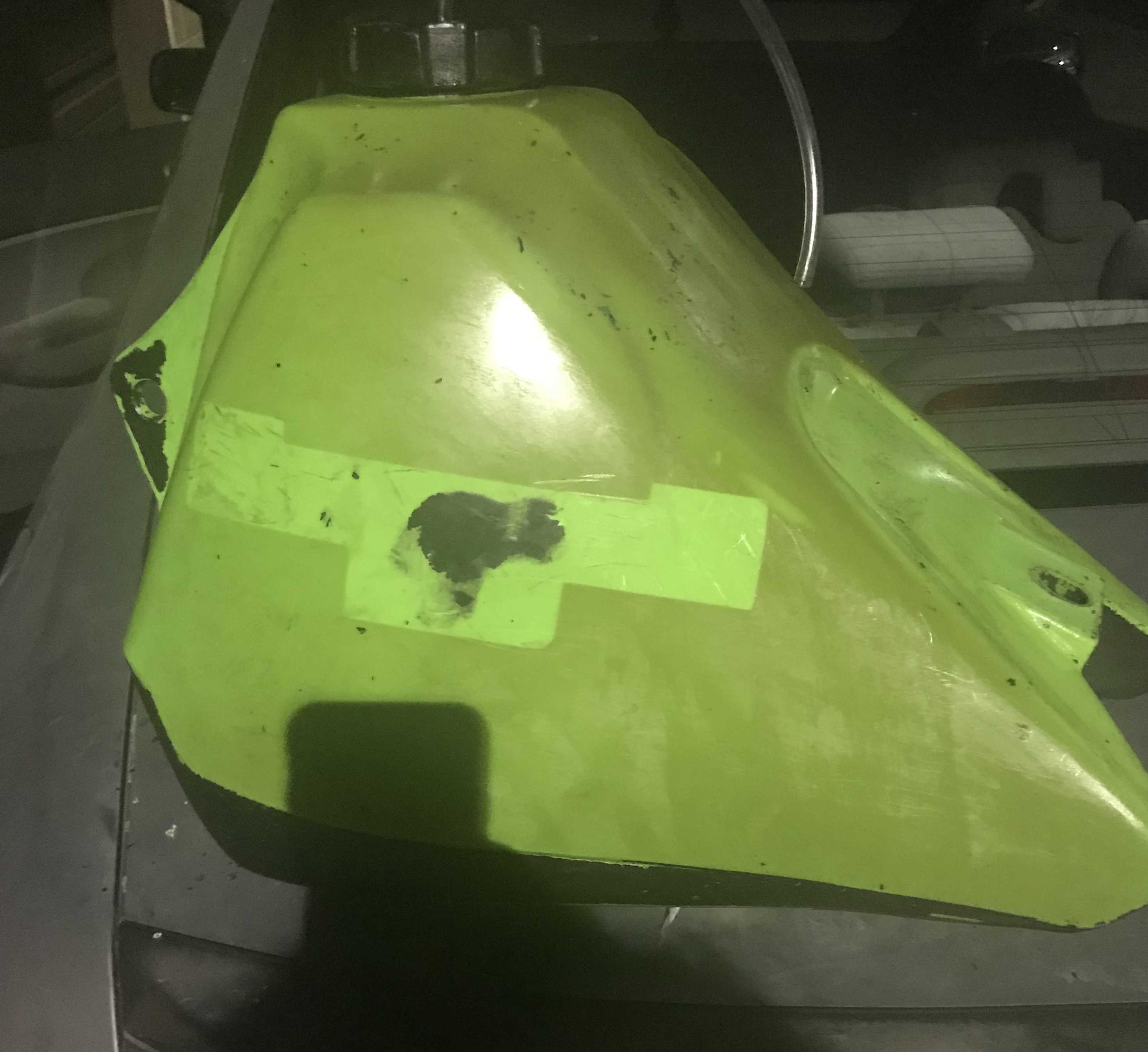

Well, at least I know where the stickers go.
