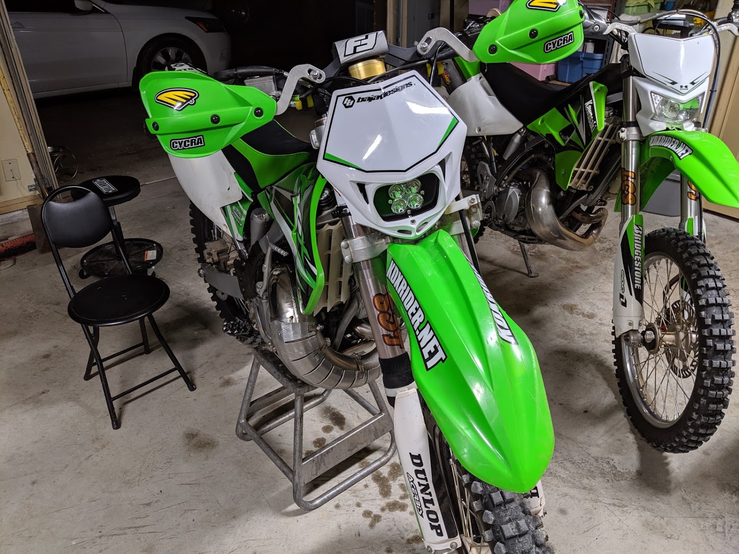

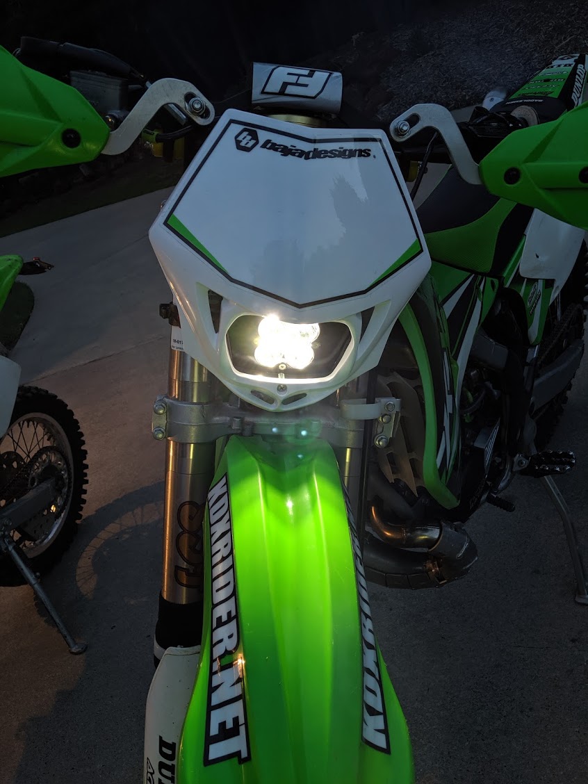

I decided to go this route. Baja designs with a built in rectifier converting AC to DC for the LED lights. Ran into a situation a few months back where I actually need a headlight and found that my light was inadequate. This LED works great.
The GOOD...It's really bright and you do NOT have to rewind the factory stator
The BAD...It's way too expensive.
https://www.rockymountainatvmc.com/part ... ight-kit-p

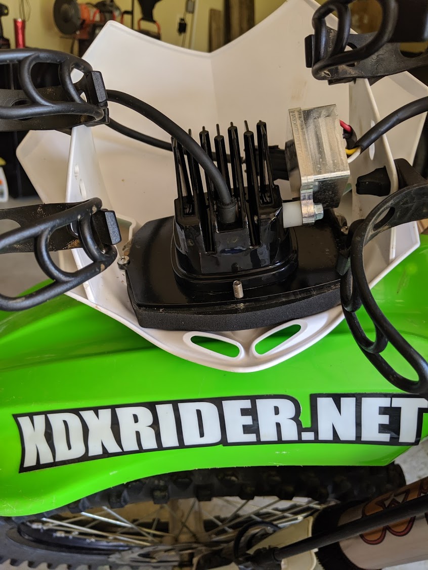

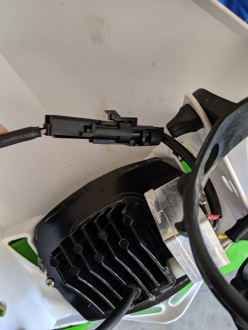

I was all set to do the rewind thinking that it was required. The BD website indicated that it was needed.
https://www.bajadesigns.com/tech-info/S ... -Chart.asp
I then ran across this...
https://thumpertalk.com/forums/topic/12 ... -any-bike/
After much confusion :hmm: I decided to call them directly. They said that the headlight had been upgraded over time and that I would not need the rewind. EDIT>>> I did verify that this was for the Squadron Pro not the Sport>>>I ordered it, installed a waterproof 2 way connector plug, and I'm good with the results. Here is the back side of the light and the plug I got off of amazon...

Re: Headlight upgrade
Holy heatsink, Batman!
NICE setup!
Thanks for the additional info.
EDIT! 4,900 LUMENS!!! :shock: :boogie: :drinkers: :bravo: :partyman:
