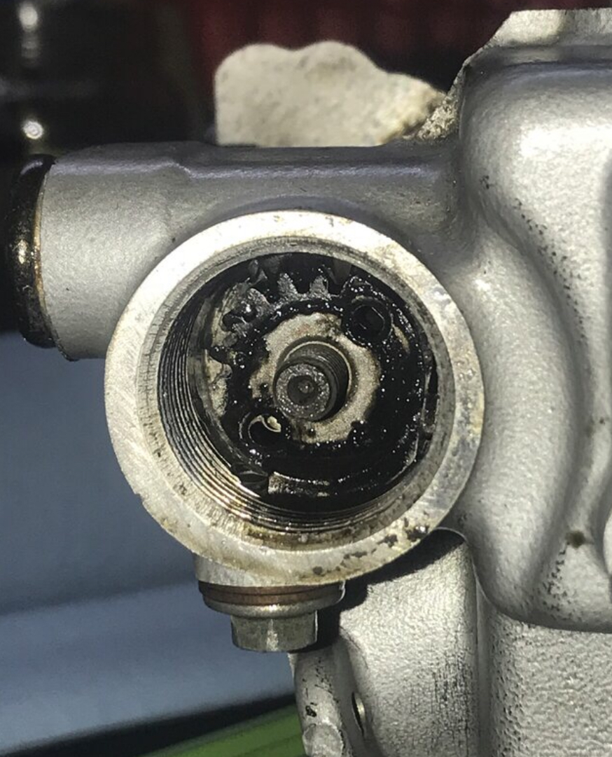

Before I go 800lb gorilla on this poor 10mm nut and break teeth off my KIPS gear/shaft - does anyone have any tips to getting this off or bracing the assembly? This is NOT the outside LH paw that people always discuss, but the one underneath the side plug after removing the 3mm Allen screw. Both my service manual, and the cycle Pedia manual, say to remove that 10 mm nut before taking out the ball bearing and spring that’s located underneath it so I haven’t touched those yet.
The inside is totally caked with build up, and looks like it’s never been serviced it’s entire life so I did my best to clean it and try to get penetrating lube and heat to the nut to no avail.
What worries me the most is In the specific other thread where the guy had it stuck but then magically got it free, noted that once he got everything out he just discovered he broke a tooth off the gear which is what I’m trying to avoid.
Well I continue to go at it with a gentle heat, pressure, and penetrating lube, feel free to chime in if you run into this issue and what you did to alleviate it without destroying your KIPS gears.

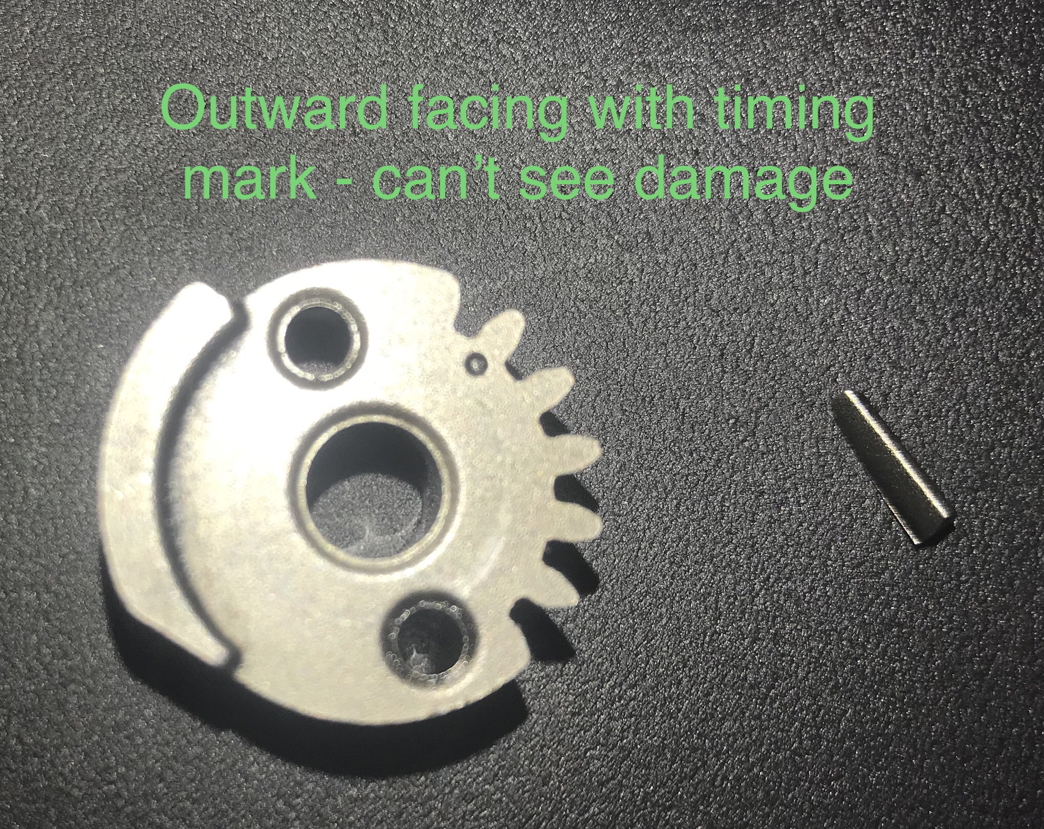

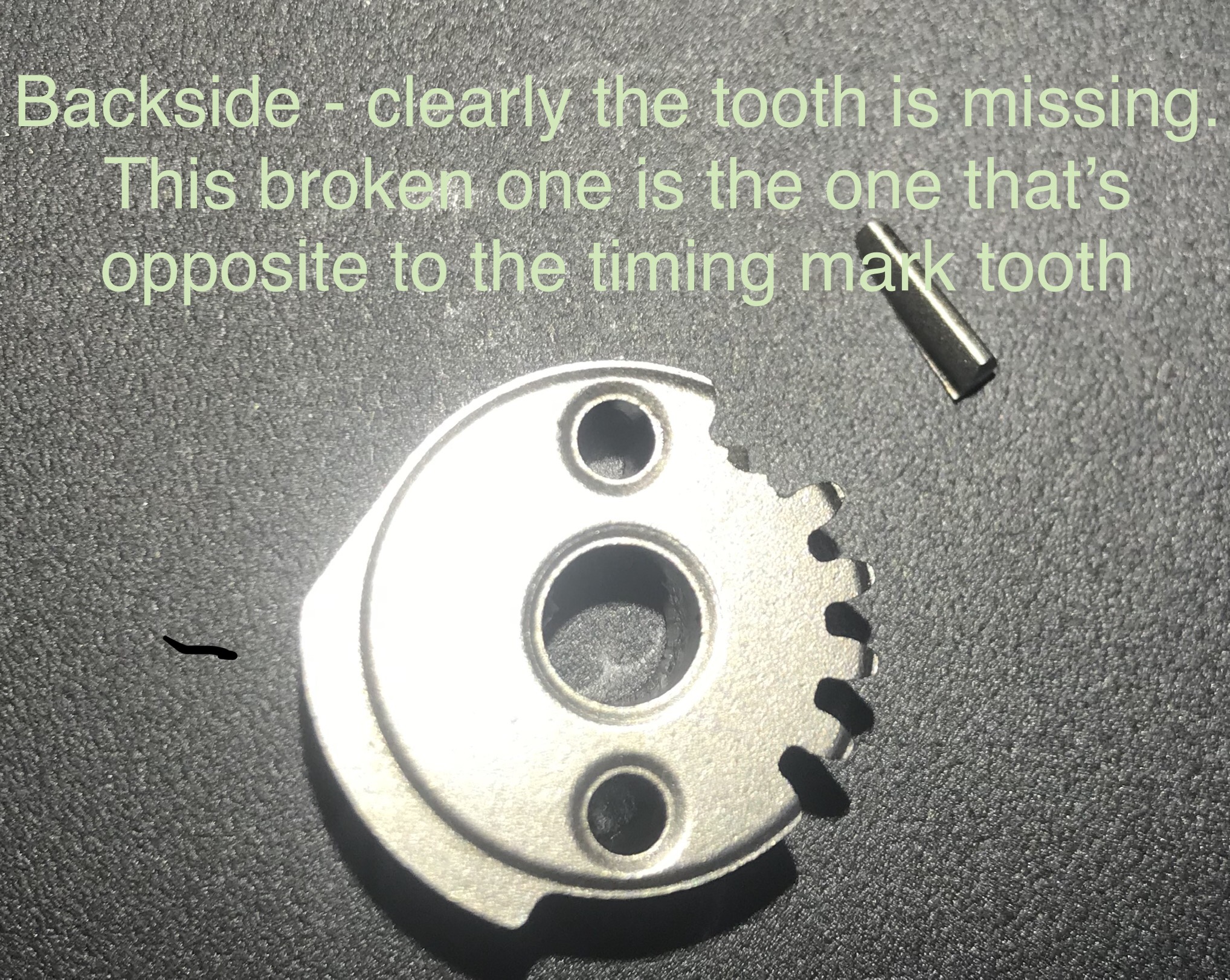

After pulling the gear... sure as **** just like the other dude who posted the gear broke a tooth off! You can’t see it from the outside as it broke at an angle but once you got it out you can see it’s clearly missing one and had the extra tooth in there as I was fishing out the ball bearing and spring.
I will say that looking into the tooth that broke, you can see the grain structure of the metal and it’s very saturated with buildup and goop in there which leaves me to believe it was done BEFORE I started wrenching on it and could have been why I had such a hard time after the PO cranked on it to hella torque mixing up ft-lbs and inch-lbs... but whatever god only knows what truly happened.
Broken KIPS Main Shaft Gear - Outward Facing View
Broken KIPS Main Shaft Gear - Backside View
Oh well, time to get ahold of the parts guy and get another order placed!! Tonight I’ll strip it the rest of the way and double check all the other shafts and see if I have anything else cracked... but man what a bummer haha.
