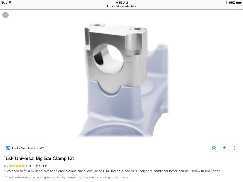

I run a Pro Taper Contour on my MX bikes and a Renthal 7/8” CR High bend on the KDX. The extra flex on the 7/8ths bar is way less fatiguing for those long trail rides. Not to mention it allows me to use 7/8 clamps, those who are running KLX forks are stuck without an adapter because the lower bar clamp is cast into the top triple.

You have the stock KLX clamp, so 7/8" is stock.
Re: Handlebar Choices (cross bar or not?)
Posted: 06:00 am May 03 2019
by John_S
You'd have to run something like this if you want the 1 1/8" bars on the KLX triple clamp.

John_S wrote: 06:00 am May 03 2019 You'd have to run something like this if you want the 1 1/8" bars on the KLX triple clamp.
Yes sir. I ordered those and I ended up going with the Renthal Fat Bars. Also ordered some lock on grips. I have never used them before but read enough positive reviews, so figured they were worth a go.
