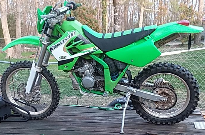

KDXGarage wrote: 03:28 pm Apr 09 2019 treelimb.png
Great looking KDX! Digging the green side panels.

VTMTcowboy wrote: 11:29 pm Apr 09 2019
Thank you sir! I am quite proud of her. Maybe G can get a picture to work of the right side. I will have Kris at Kawasaki of Rome look into the springs again. He has truly been great on finding lots of OEM parts for me when Kawasaki says it is no longer produced and others when they can't be located by me and my computer illiteracy. I have high hopes of finding stiffer springs.
