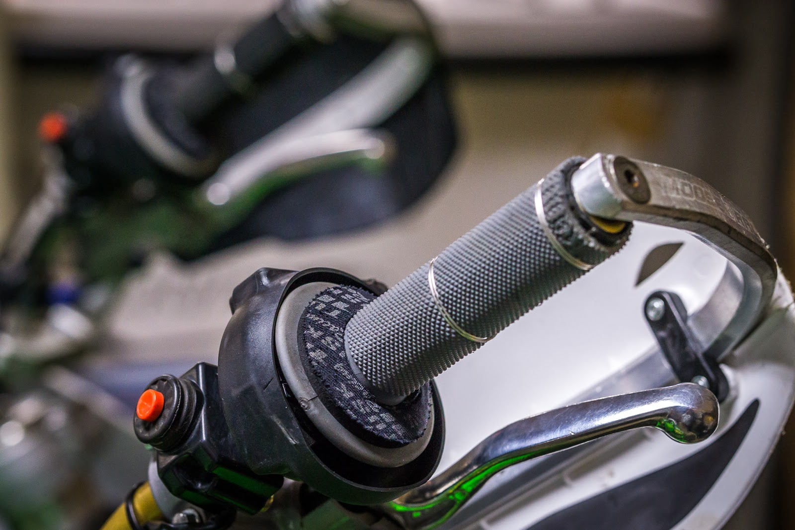

I have 2 KDX's. One has Renthal diamond pattern grips in medium rubber. I've liked the soft ones in the past, but they wear out fast. I like small diameter, but at times, my hands do cramp up. This last time I installed them, I used spray paint inside the grips as glue and then safety wired them on. I bent the ends of the safety wire away from the pull of my fingertips.

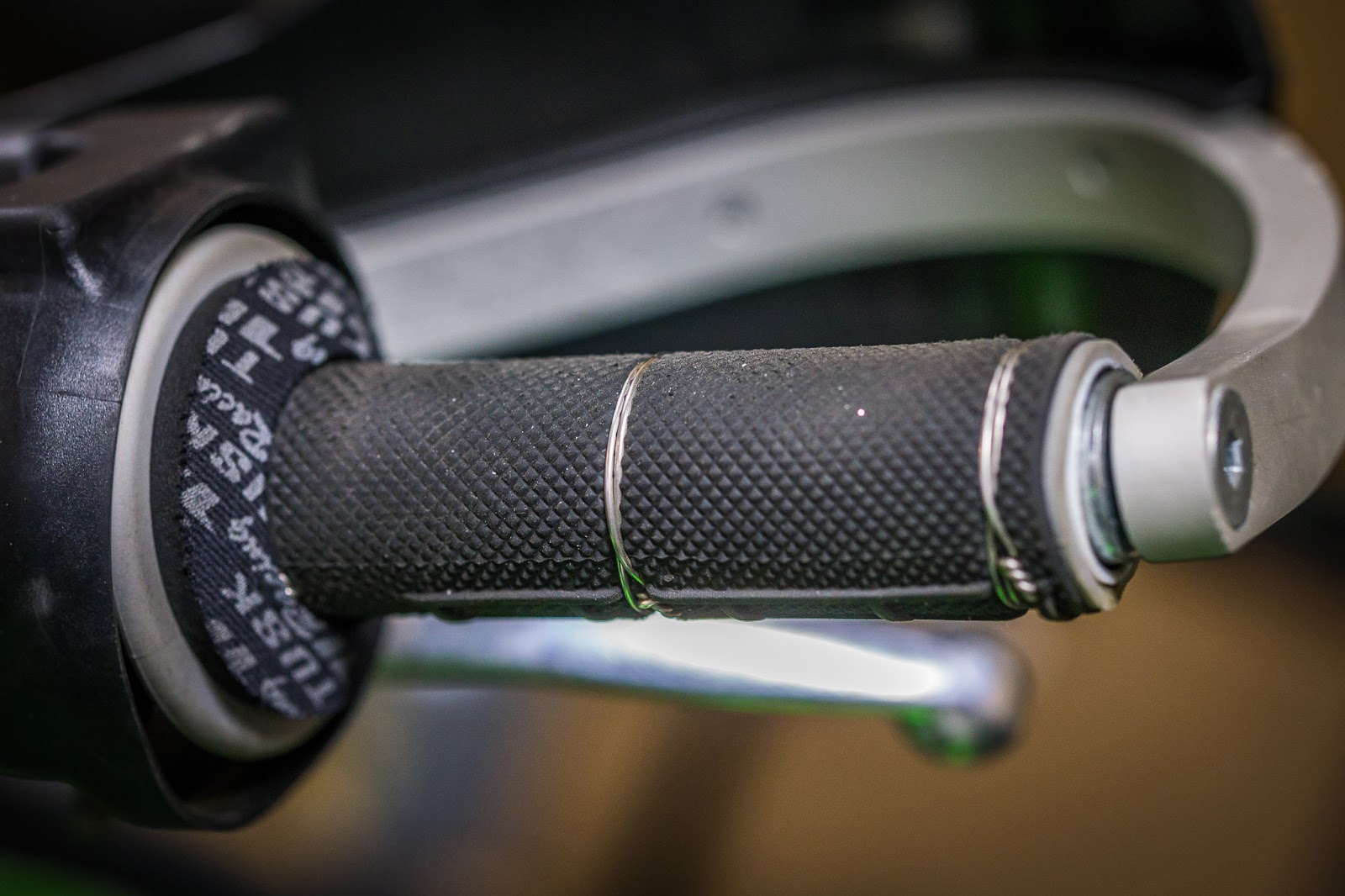

Our other KDX has cheap Tusk dual density grips. They seem to be even better than the Renthals. Soft on the grip area and firmer inside and on the ends. They have both diamond and waffle pasterns under the fingers. I think I'll buy these again. They're good for me and cheap.
Renthals
Tusk
