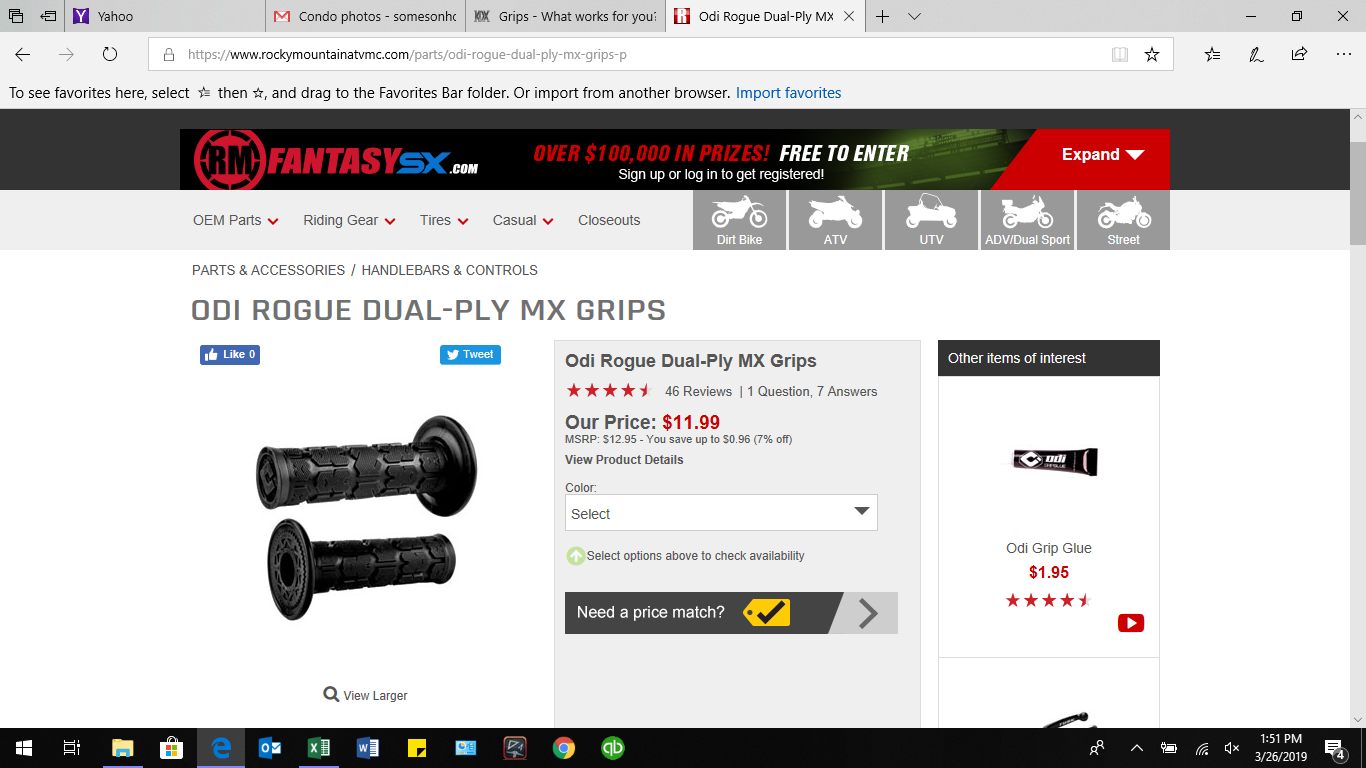

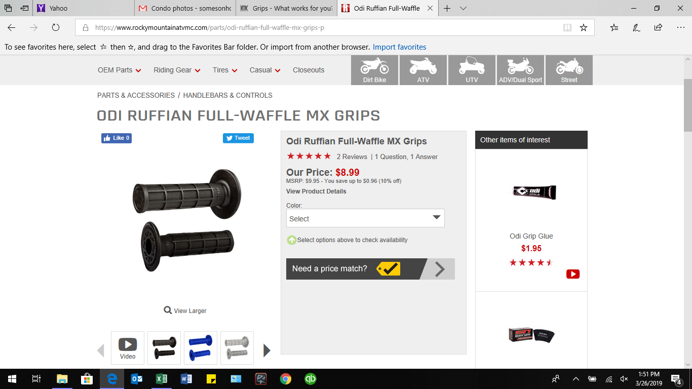

My favorite grips are ODI Rogue MX. They're on the larger side and really soft, but last a long time. Currently I have ODI full waffle and was surprised at how much more I like them than the half waffle. Both of those ODI's are non locking. I shoot brake cleaner in the grip to install them and use tie wire although I don't think they'd twist without it. If you want to save the grips and just change styles, you can pinch the grip and get the brake cleaner straw in there, shoot some in and they slide right off with no residue. Wear safety glasses if you shoot brake cleaner into a grip to remove it.

From the feedback, I think my next grips will be ODI Rogue MX or Pro Taper Pillowtops. I'll definitely try the brake cleaner to install them. Thanks for the input! I'm curious too about lock-on grips. If anyone's tried them, what do you think?
