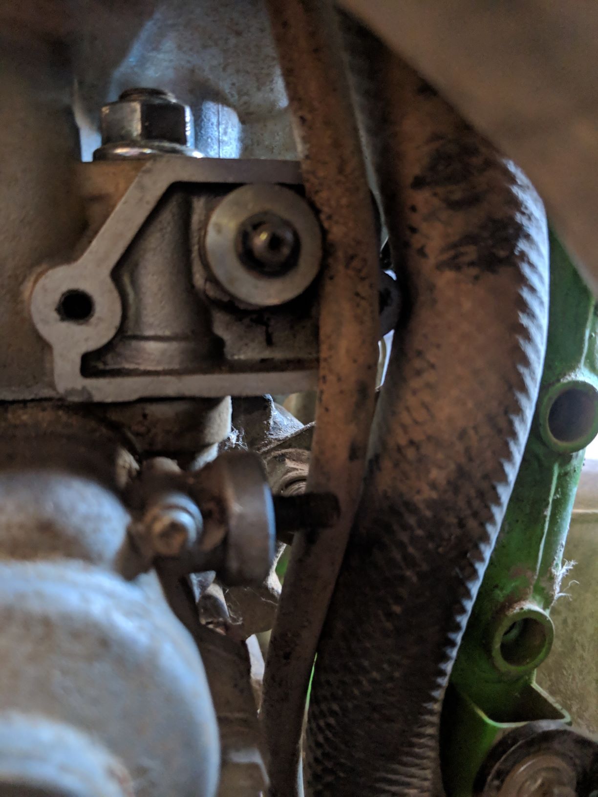

hey all! :supz: new to the site due to needing help :evil: ! got this basket case 1991 kdx250. got it put together after finding all the missing parts and gaskets and all. never had luck finding the governor lever. everywhere shows unavailable. part number 13168 https://www.kawasakipartshouse.com/oemp ... ine-covers in the attatched pic I believe it goes from the governor down to the stud sticking out from the water pump area but this is the only kdx I have experience with. im a general motors tech. small motors especially oil burners like this or my stihl give me a lotta hell!
kick kick ect and no start not even a hint. desperation sent me to try starting fluid. little at first and tried more than I was comfortable with and still nothing. haven't went thru the carb yet. was hoping I wouldn't have to for a season at least. its getting fuel to the carb- vp pre-mix 40:1. spark to the plug. older plug but didn't look dead. wife verified it was sparking so I don't know what quality of spark but it has something. if it wasn't for not having this governor (power valve?) lever I would look more into spark or already have a carb kit on its way. but will this governor lever issue cause a no start? anyone have a lever and maby that lower cover they wanna sell? as far as I can see that's all that I need to go have some fun!

Welcome to kdxrider.net.
13168 is only a reference number. The part number is 13168-1442.
It is not related to a start / no-start situation.

1988 kx 250 use same arm

1988 kx 250 has same governor arm

Hello no sorry, there are some on ebay. Just be careful as some are wielded onto shaft. If you take casing of your be able to make wielded one work..

There's one bolt on arm on ebay for kx 1988. Then later one's seem to be wielded straight onto shaft. So your have to split clutch case to fit . Or grind wielding off and re drill hole .. your notice shaft is tapperd where arm mounts on, and arm mount hole is tapperd to .

1988 .1991 kx 250 cover is the same and rubber boot is same

From Partzilla:
This Kawasaki 13168-1442 LEVER,GOVERNOR Not Available fits the following models and components:
Kawasaki Motorcycle 1990 KX250 - KX250-H1 Engine Cover
Kawasaki Motorcycle 1991 KX250 - KX250-H2 Engine Cover
Kawasaki Motorcycle 1991 KDX250 - KDX250-D1 Engine Covers
Kawasaki Motorcycle 1992 KDX250 - KDX250-D2 Engine Covers
Kawasaki Motorcycle 1993 KDX250 - KDX250-D3 Engine Covers
Kawasaki Motorcycle 1994 KDX250 - KDX250-D4 Engine Covers
