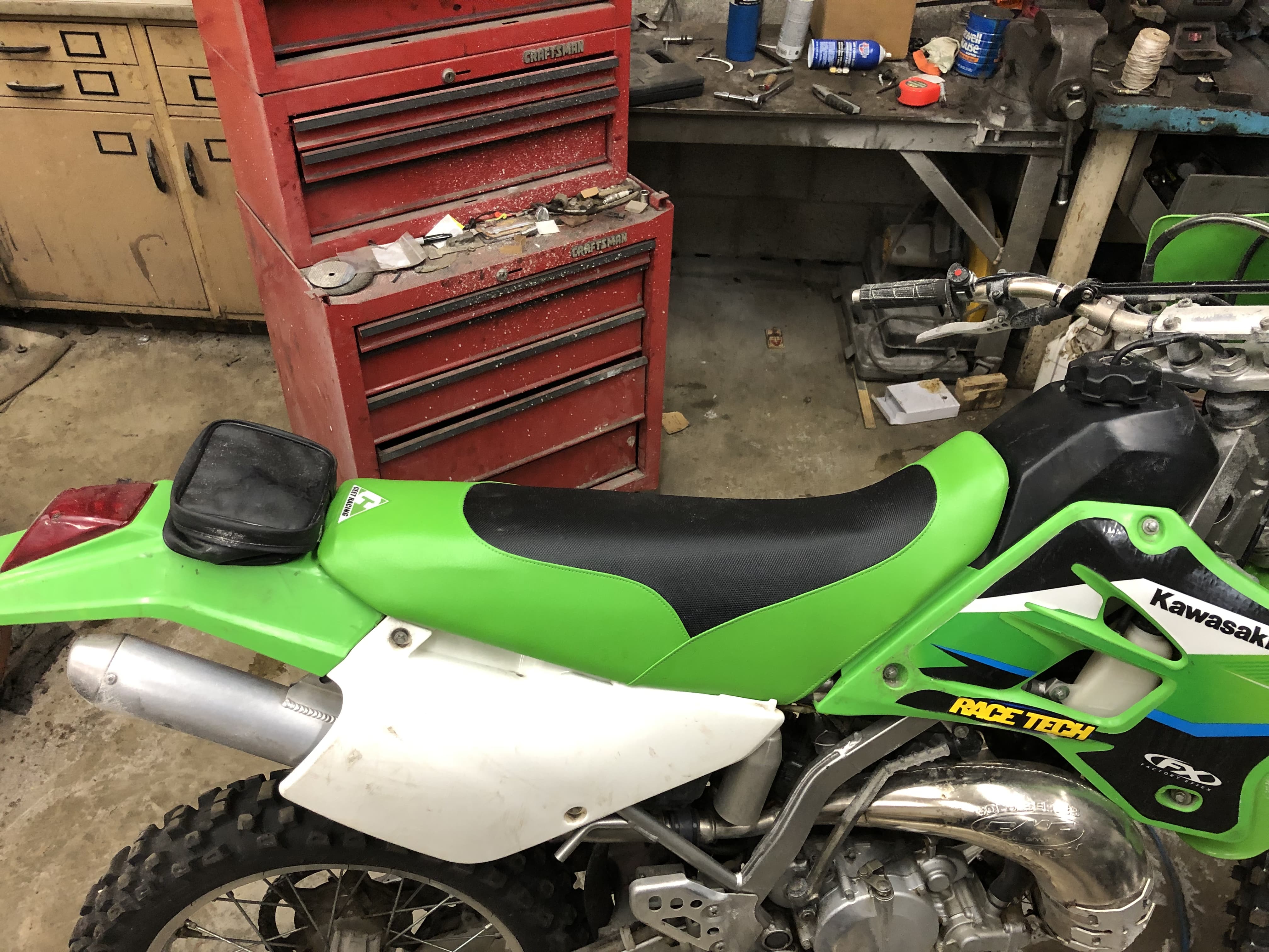

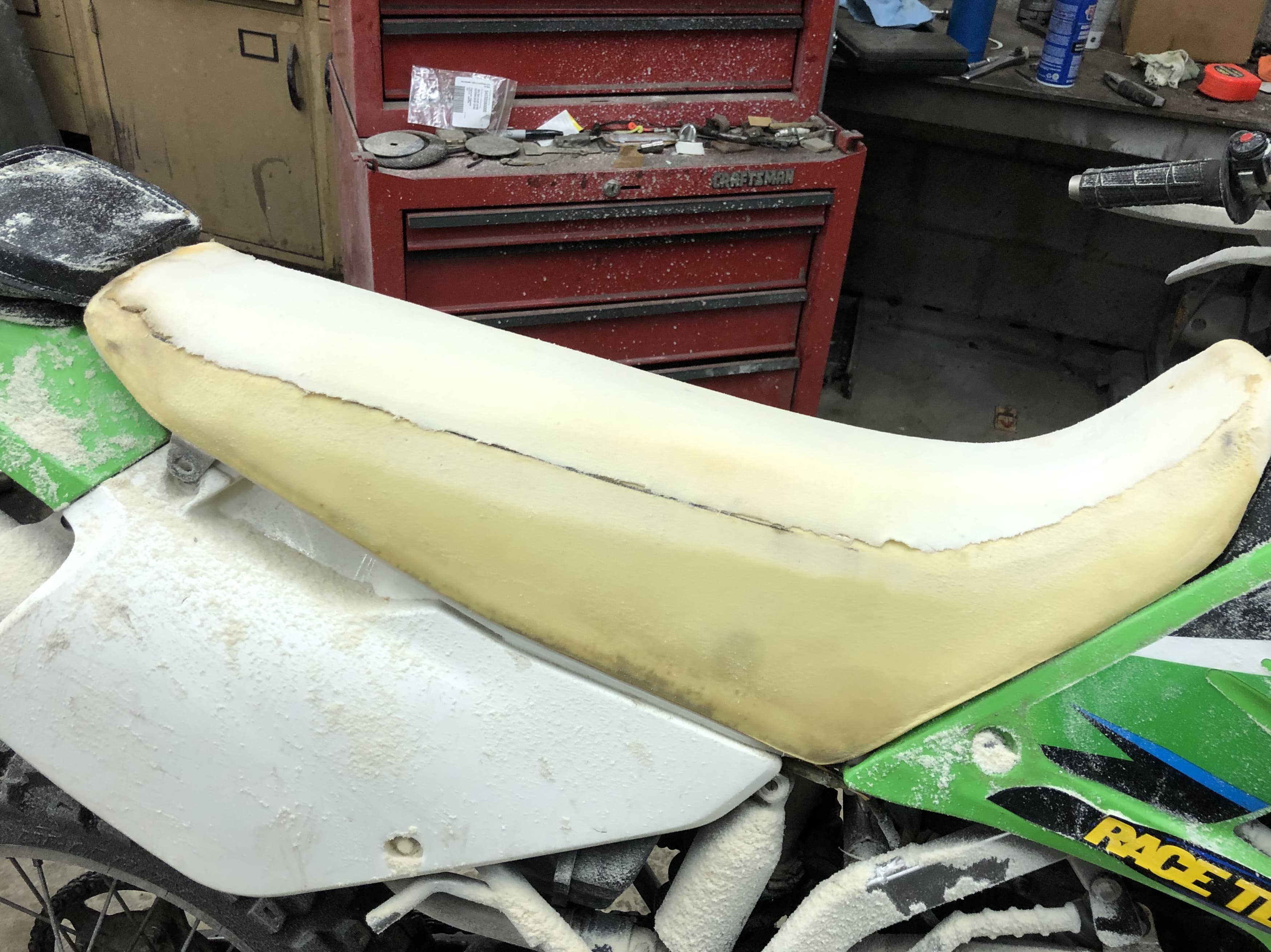

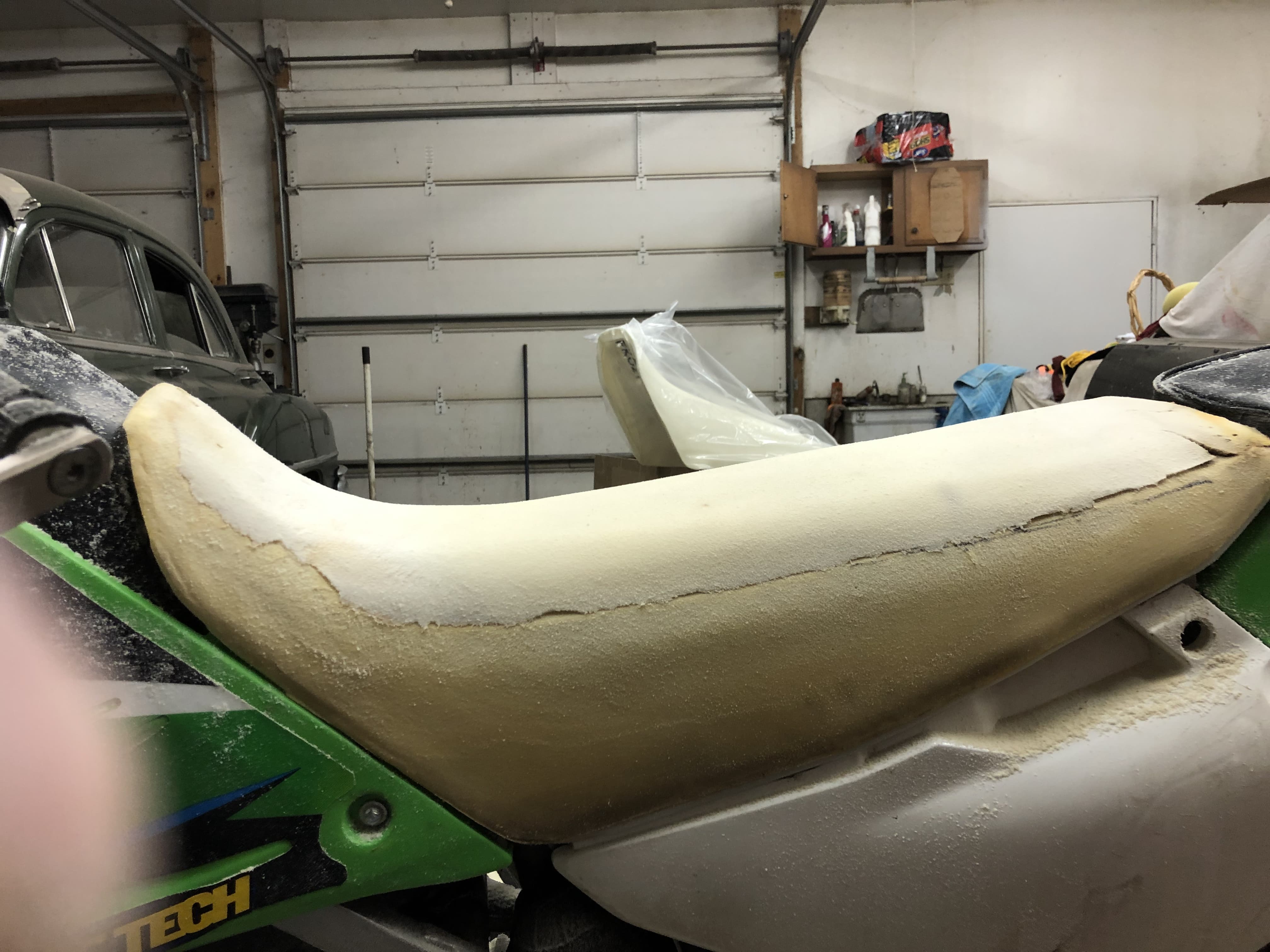

But, I made one myself by cutting the top off my old ktm seat, I traced and trimmed so it was 3/8” higher in the back, and 1 inch in the saddle. I formed the underside after slicing it off with a sharp long knife. I used a 6 inch DASander to fit the two foams together, leaving some stock around it for final shaping. Glued the two together with 3m spray adhesive. I then sanded it down to the contour I wanted.
I found out why ktm seats are so hard. There is a full length plastic plate buried in the foam about 3/4” below the seating surface. This was great because it essentually short circuit the soft kdx foam. Now the seat is perfect, not as hard as the ktm, but higher and way stiffer than kdx. Here are pics.
