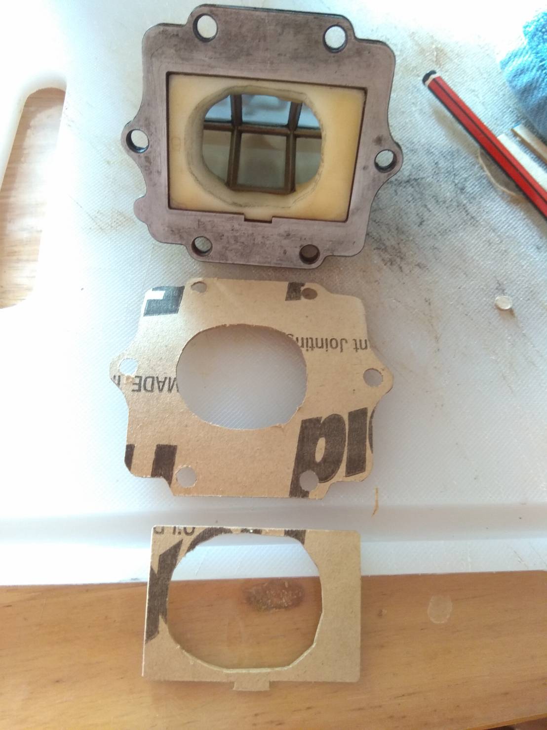

here is the butchered reed cage

Do you think the huge hole has something to do with the jetting being off?

thats what i am trying to determine but i have no way of testing
Posts: 6121
Re: rich at idle my final theory
I don't think the hole would be the problem. Also, why are you running two gaskets? You only need the outer larger one. Are you sure on your float height? Don't run the factory float height as it can contribute to a rich idle condition. Have you done a leak down test?

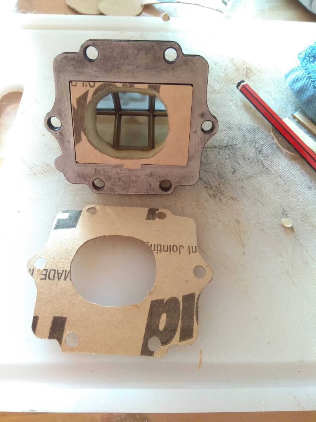

the smaller gasket is to allow the sealing hole in the airboot something to sit against, the surface of the plastic cage was damaged so i had to shave it down a milimetre or so,the small gasket brings it back to flush. float height is set using the clear tube method level with the fuel bowl mating surface and the needle and seat are vacuum tested to check sealing perfectly. engine is completely rebuilt with new crank seals, vaccum test was hard to do given i couldn't replace the packing seal on the power valve shaft but i did do a leak down test to make sure no leaks around the carb boot. 99 percent sure crank seals aren't the issue as the first 10 seconds that the bike is started after being cold it runs perfect at idle then runs worse as the engine heats up

correction on the plastic cage being shaved down,i should have said there were bits and pieces of what looked like a clear expoxy on the surface which i sanded/shaved down

So here is what I learnt today. Yesterday I used a die grinder to try smooth out the curves on the plastic cage, I used to port heads when I was younger so not so difficult, riding the bike now and it runs slightly worse at idle and lost 30 percent of power at 1/2 to full throttle. That plastic cage design is everything. Feeling p...ssed off
Posts: 3553
If you're making the hole bigger then you are changing the incoming charge velocity which will definitely impact the operation of the motor. If you can find someone with an unaltered cage that is off the bike they could measure the stock diameter of the hole and you could easily build a restrictor plate to try and compensate.
