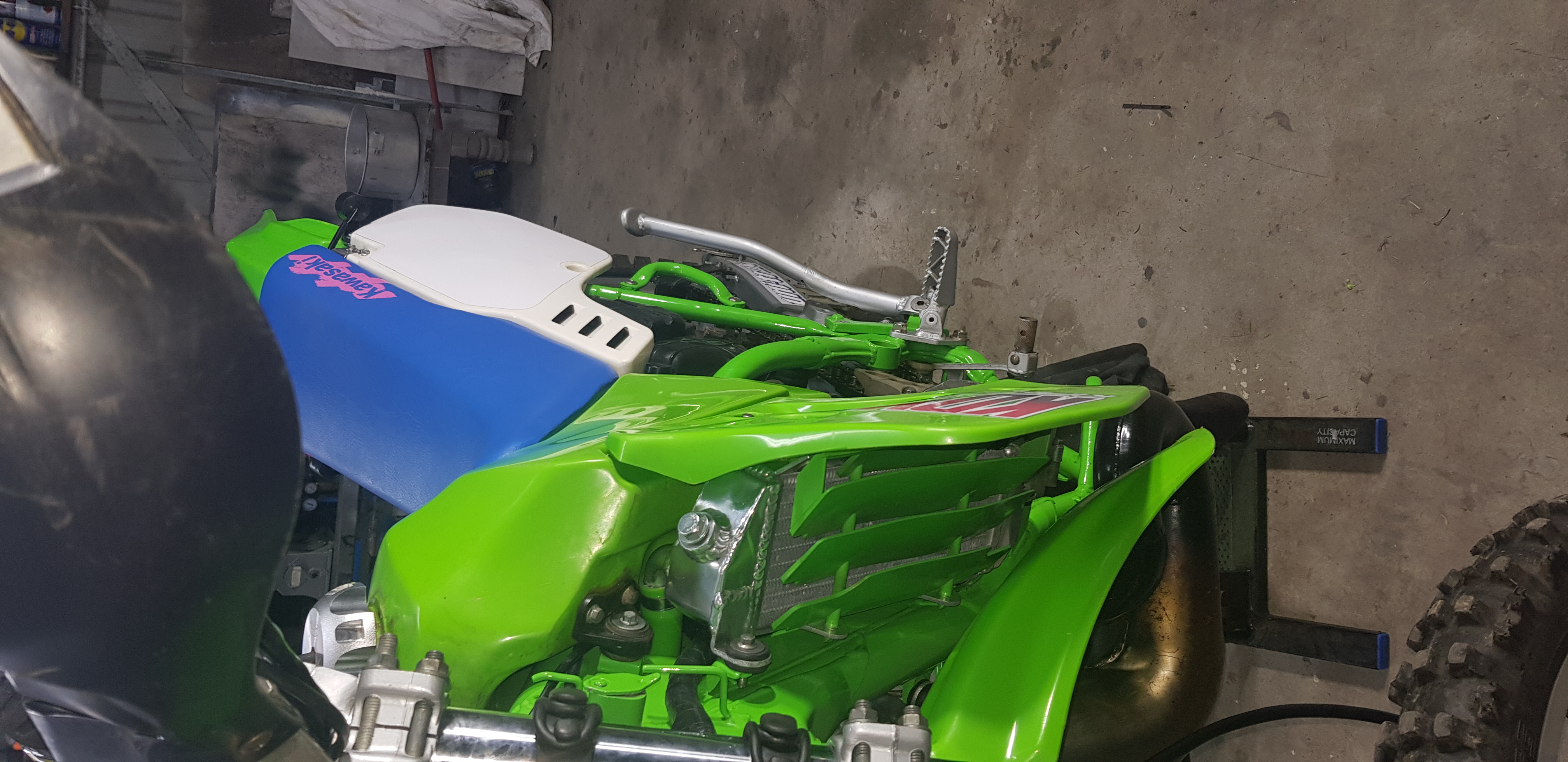

Re: E series Fuel Tanks
Need to make brackets for fairings to fit radiator, use kx500 seat and fill the seat back with more foam so it sits lower on the rear kdx200 guard
1990 kx500 tank on 1990 kdx200

- Posts: 6053
Great info! Thanks for sharing this as I'm sure it will help some people out.
SLEEK! Thanks for sharing the proper setup. It looks really nice.

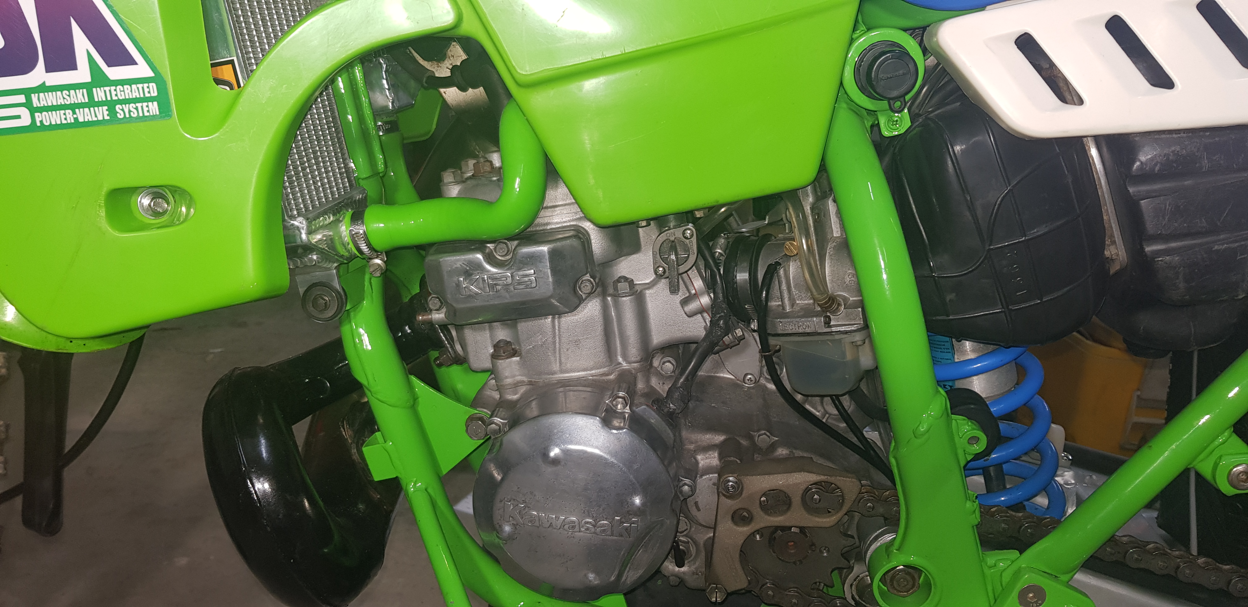

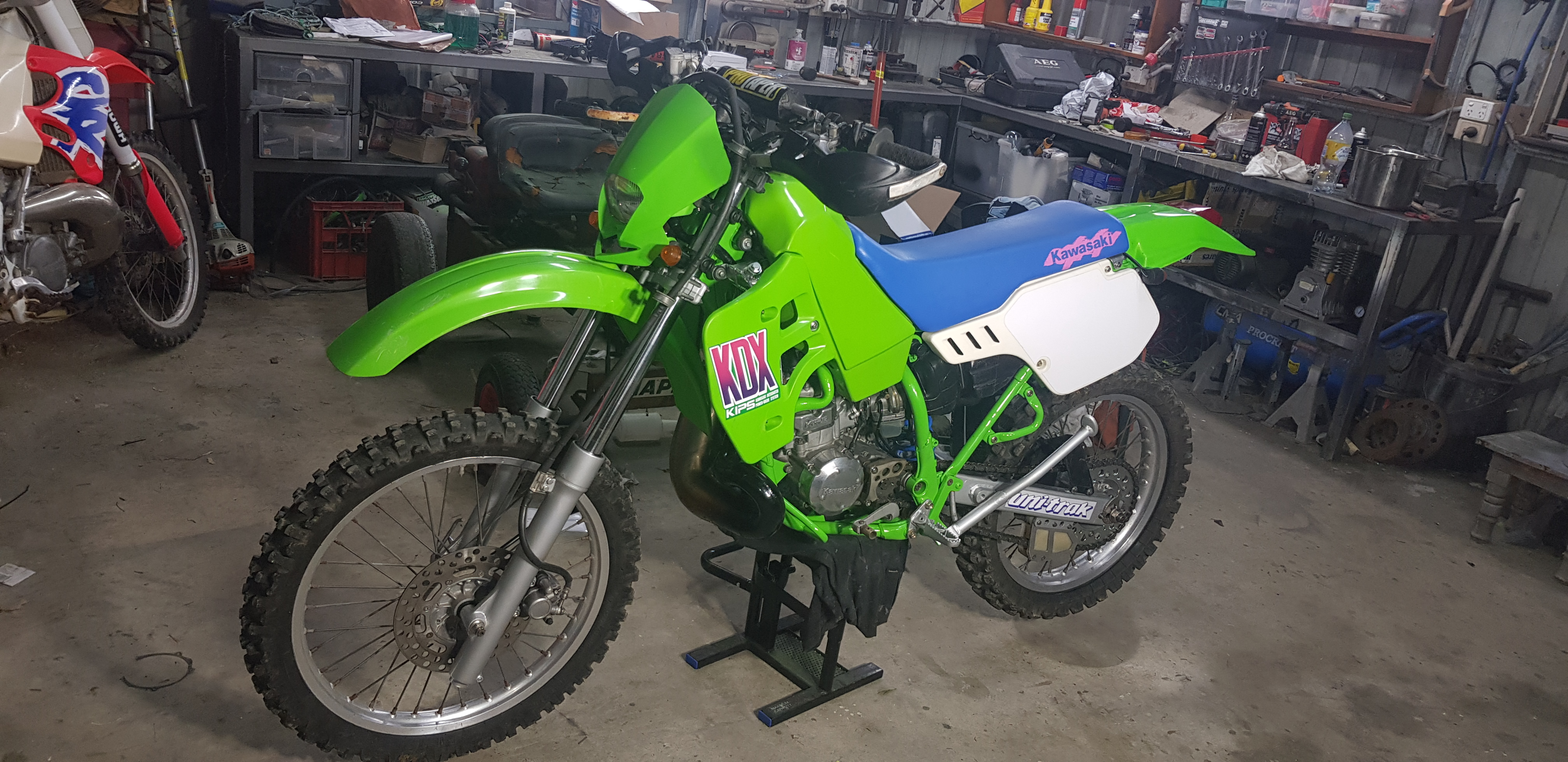

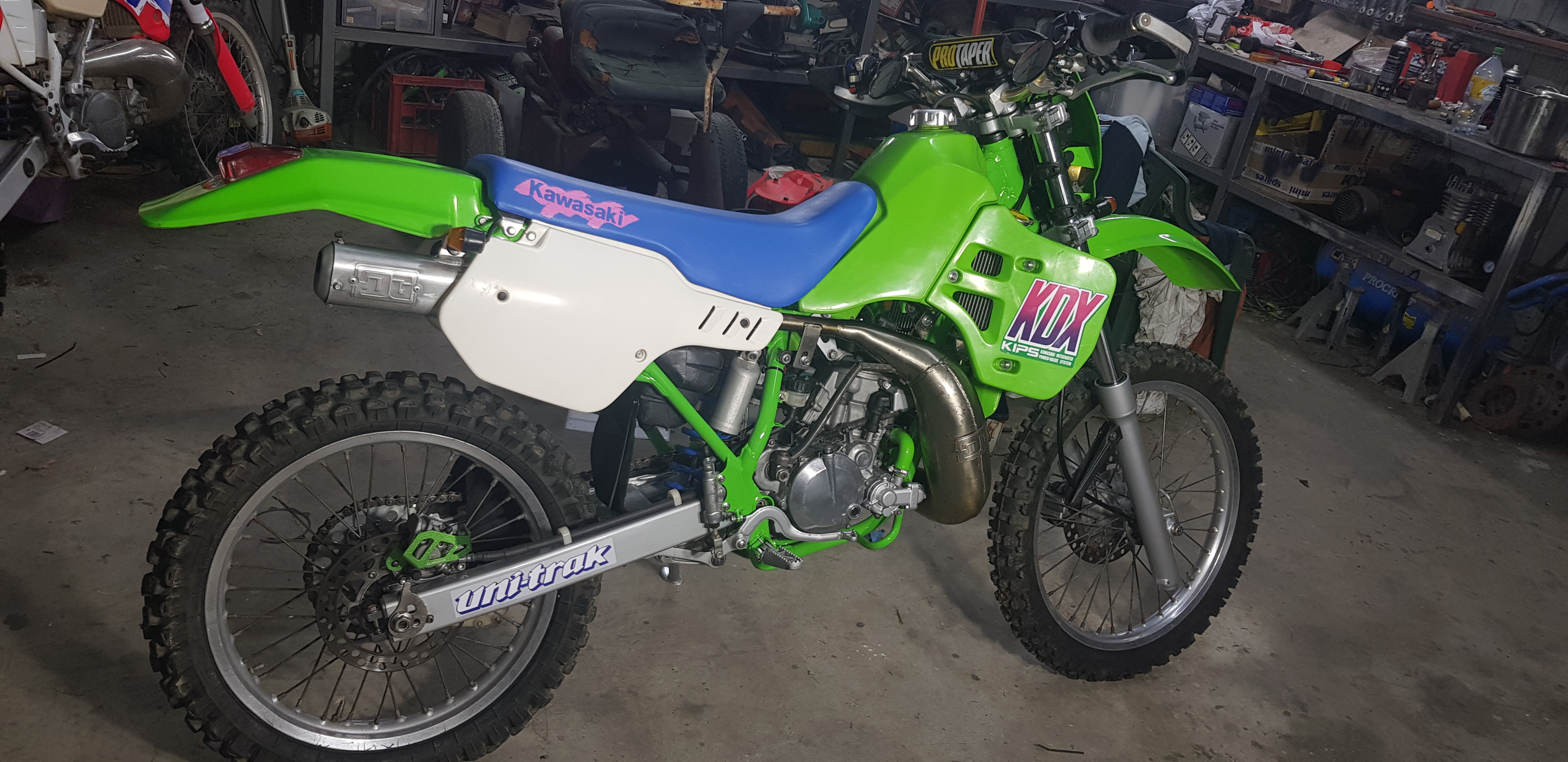

Thanks. No worries. A few more pics
Forgot to mention, need to use acerabis fuel tap with single stalk so that you have a reserve. Got to drill the tap hole out a smidge for it to fit
Thanks.
What is the black circle between the tank and side panel?
Ignition key hole? It's an SR version I think.
Yeah that's the key mate. Its oddly shaped like a mushroom. It's is a 1990 F model (or SR as you call it). Road reg model with 19inch rear wheel.
You can see in the pics that I upgraded to the single core chinese raditors for $125AUD (stock ones are twin core). They look awesome and weld quality is good. I have also settled on a sprocket ratio of 13/43 (Stock being 14/45 on the SR).
