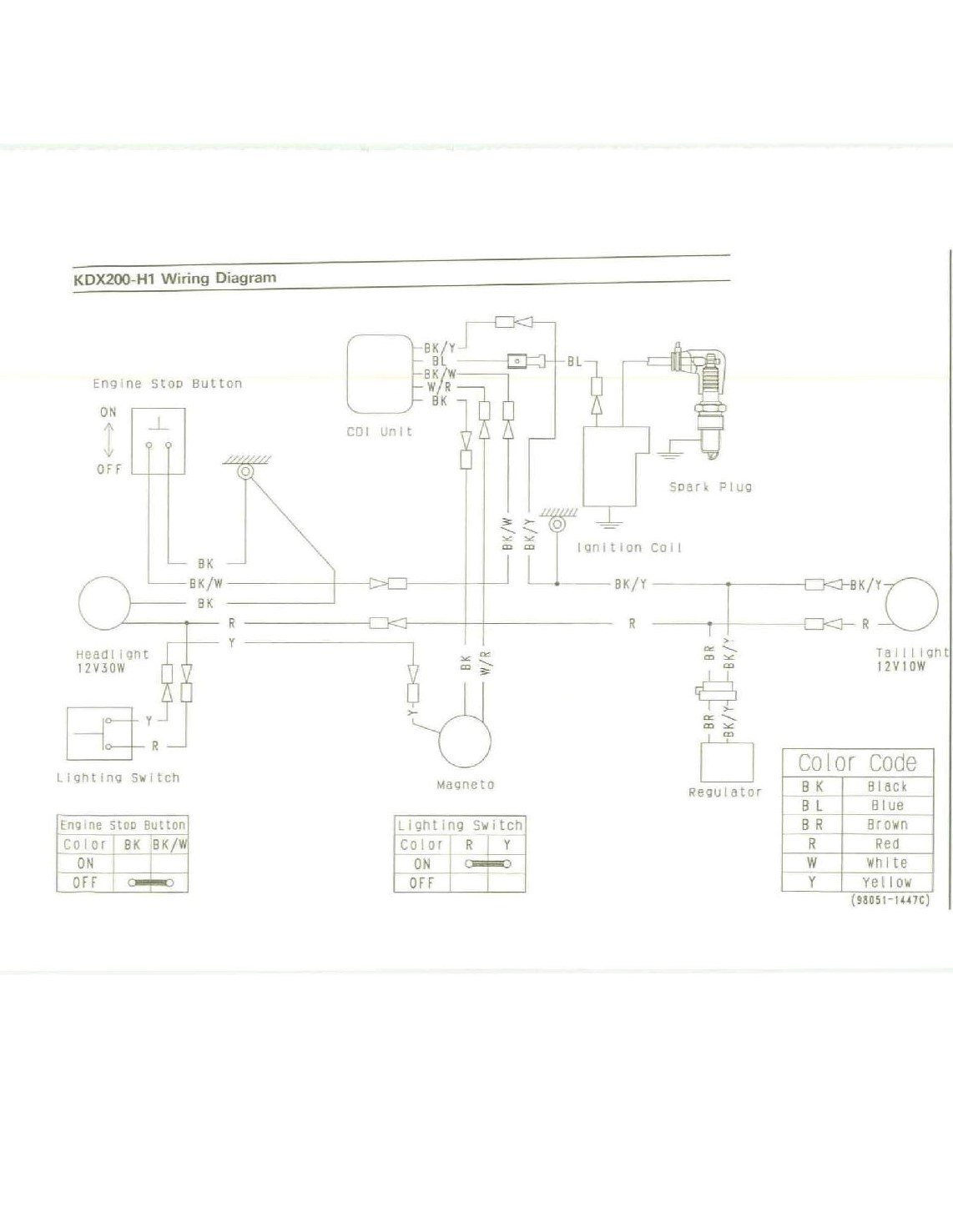

Here's the wiring diagram. 2003 and 2005 H series should be wired the same. Yellow is AC positive from the magneto. It goes to the headlight switch and becomes Red positive for the headlight and taillight. Black is ground. I don't know how you got positive power without using the yellow wire.
