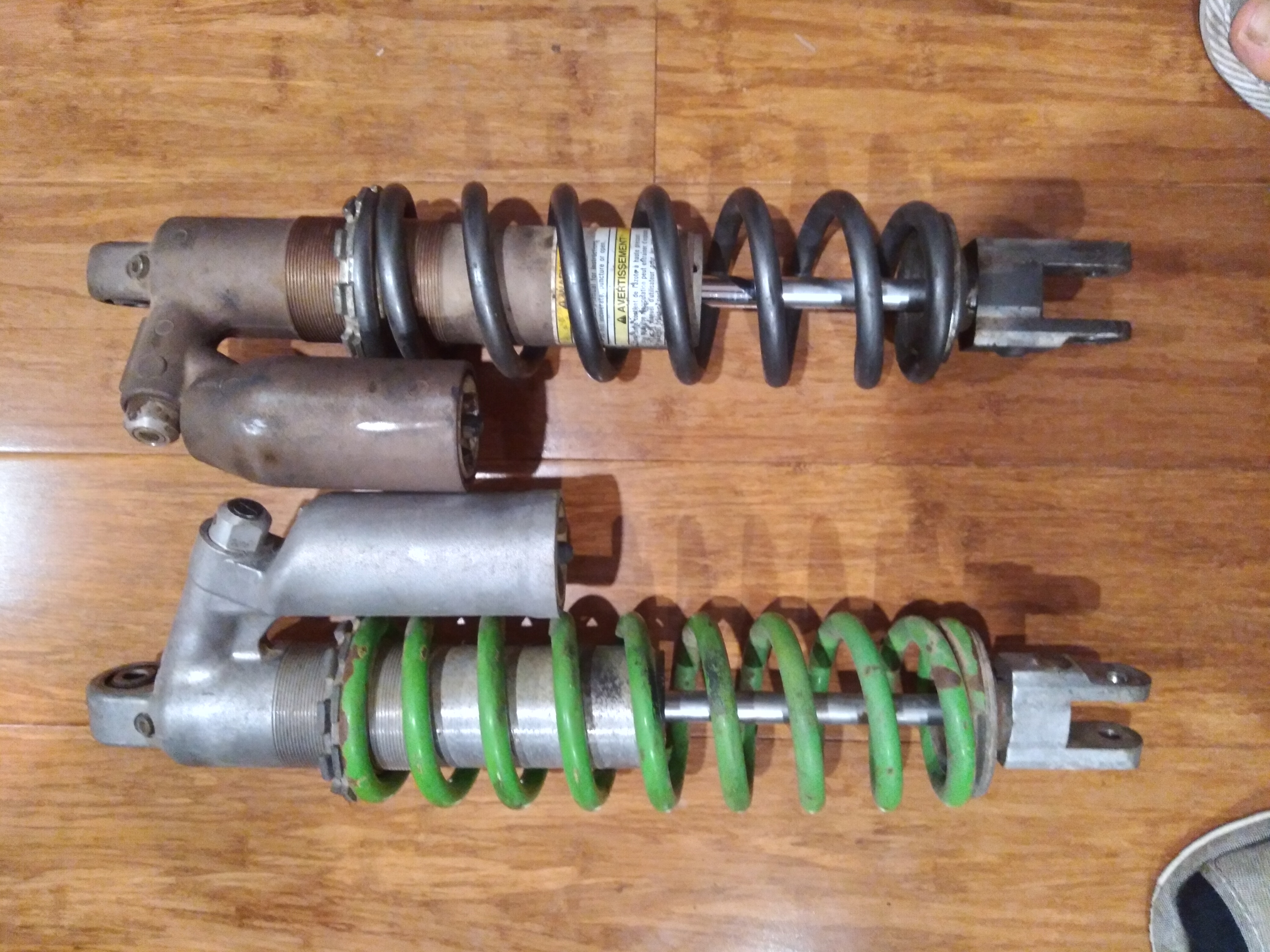

For future reference the klx250 shock will not work as the reservoir is too far forward causing it to hit the frame.

Yup time to rebuild the stocker. Also after looking at. It closer looks like it's not the same. Length shock rod less travel.

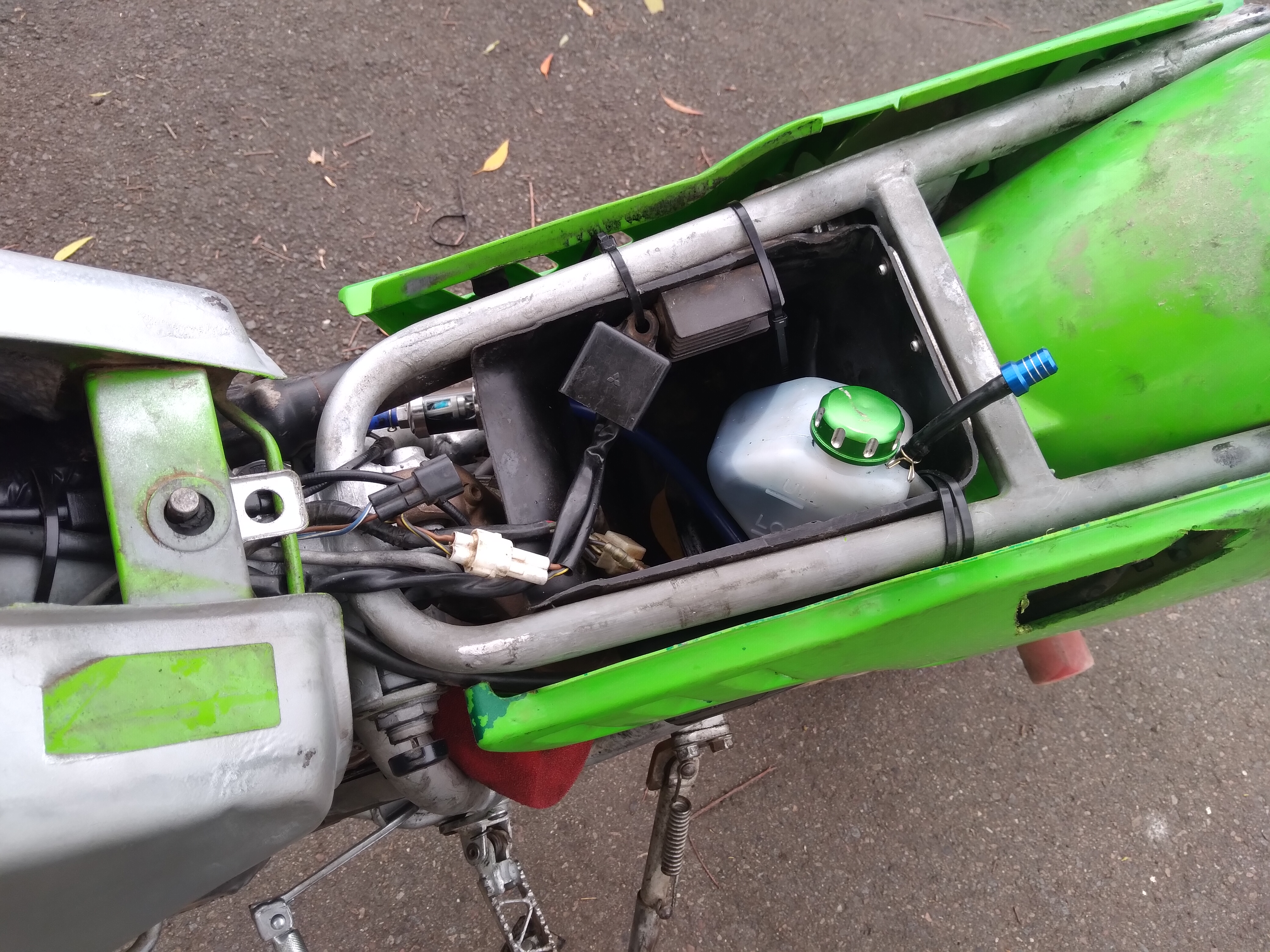

I ended up needing a kdx200 shock rebuild and while waiting, blew the klx250s piston and shrapnel dropped into crank. Needed to ride so last minute figured that a swap might be worth a try.
It kind of works but not recommended unless in a real pinch.
The klx shock has the reservoir on the otherside and seems to be ever so slightly shorter.
The connection from carb to airbox will not fit so the carb can be connected to a bent pitbike air filter that is exposed to the open air as can kind of be seen below
While this did not strictly need rejetting, halfway through a ride, the airfilter simply got too dirty and the bike started bogging. If riding in a clean environment it might work better but woUld still need more frequent cleaning.
Also the bike sat lower and the suspension felt like it had trouble getting traction compared to stock even after fiddling with preload and damping, could not get it working as well as stock.
The biggest problem for me was that the springs have less coils that are thicker and these seem to resonate with the engine and shoot all sorts of vibes throughout the frame. Even with loctite, I ended losing an engine mount bolt, the chamber rattled lose and leaked and ended up losing the kick lever as it simply rattled off! My feet also got numb after about two hours.
