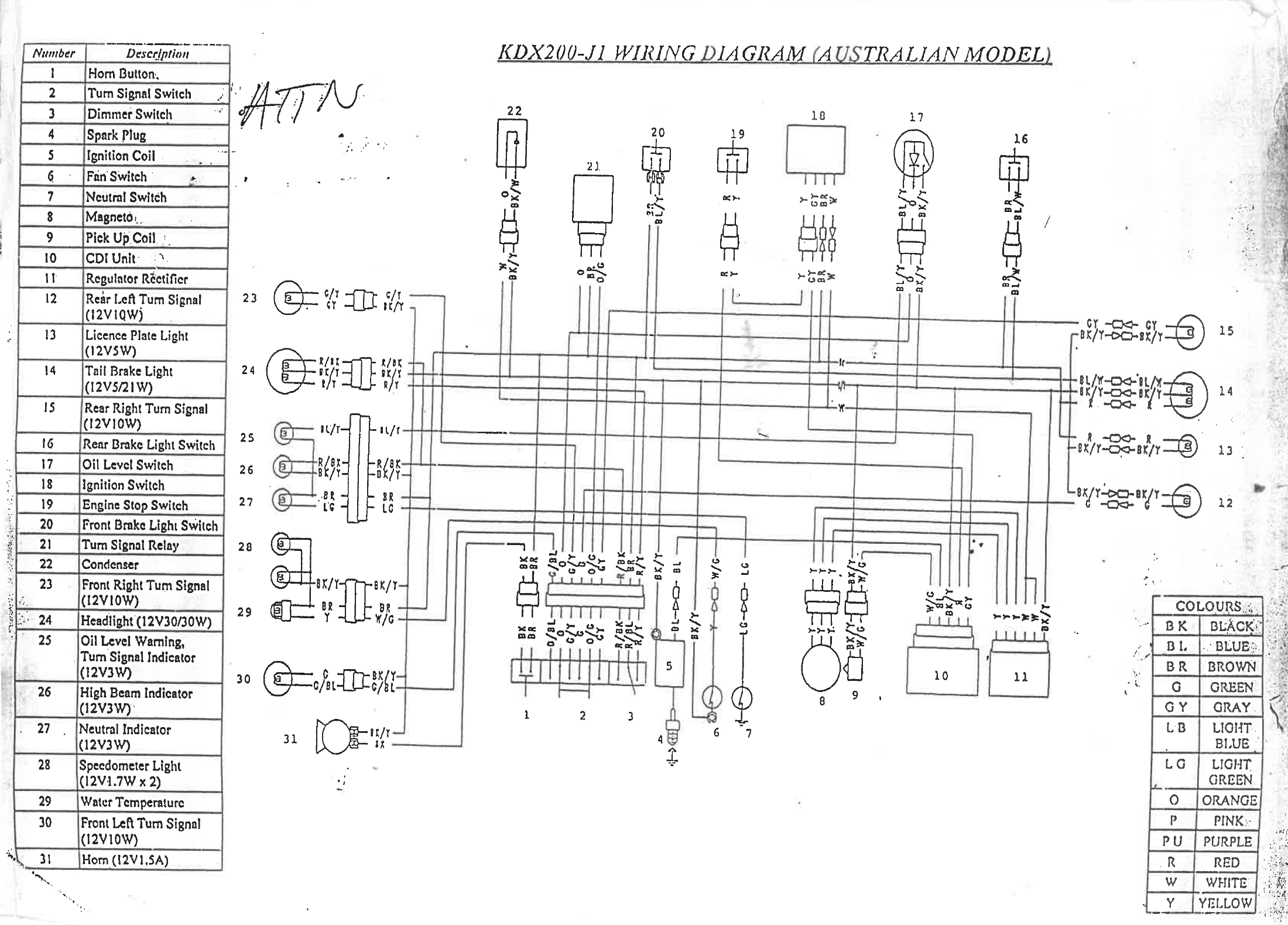

He has the same model as the Australian J Series. An H series with a different wiring system for enduros like this one.
Wiring Diagram KDX 200 J.png (1.24 MiB) Viewed 2634 times
