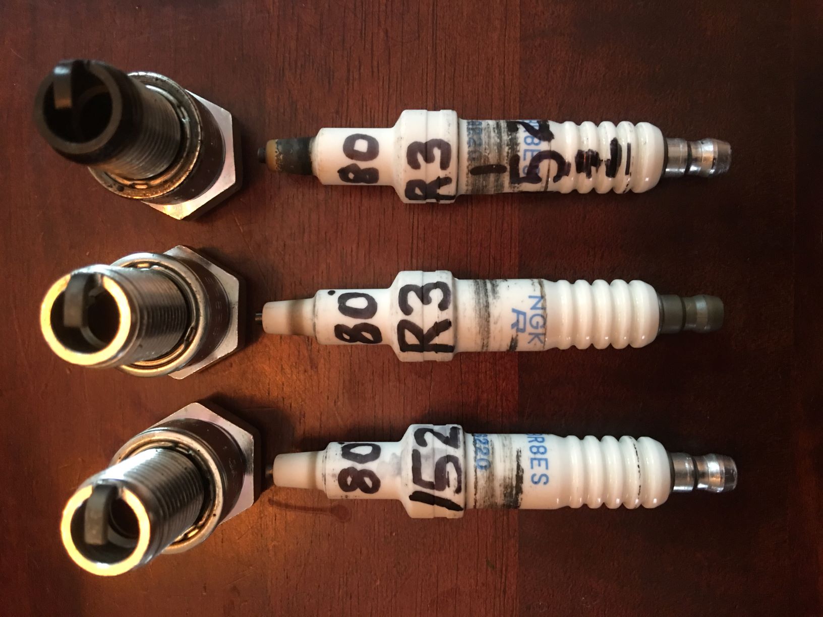

The plug on the left side is a main jet chop 1st - 6th, the middle plug is a needle chop about 30 seconds long in 4th gear hovering around 1/2 throttle, and the right plug had 20 hours on it. I think its interesting that you can clearly see the 3 different circuits on the right plug. Main jet (152) was too rich, needle (R3) was slightly rich, and the pilot jet (40) was a perfect tan. R3 refers to a JD Red needle in the 3rd clip. Those were all done with it being around 80 degrees. Its now really hot in Florida 95 degrees, 95% humidity and it took a 145 main, the needle in the 2nd clip, and the pilot jet, still at 40, before the porcelain was tan all the way down on a plug that had at least 5 hours on it. I'm going back up to a 148 to be on the safe side. I finally have year round baseline jetting figured out for this bike. All the settings below are give or take a little bit in that range depending on the humidity.

Thank you SS I really appreciate that coming from someone I've taken much advice from on here. I have a picture that goes with my long post above showing the 3 plugs cut up (main, needle, and a 20 hour plug. I have another pic I'll snap of a plug I have at work and I'll add those also. Its main jet chops with a 160, 155, 150, and a 148 with the max rpm's that went with each of those runs.

I added the pic to the long post

I love that pic. It clearly shows how to tell the difference between your main jetting and being on the needle. Armed with that pic, and knowing how to tell if you have the proper pilot jet, you are equipped to dial in any bike's ideal jetting.
