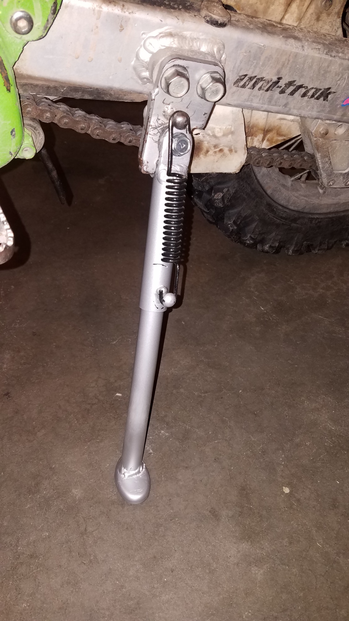

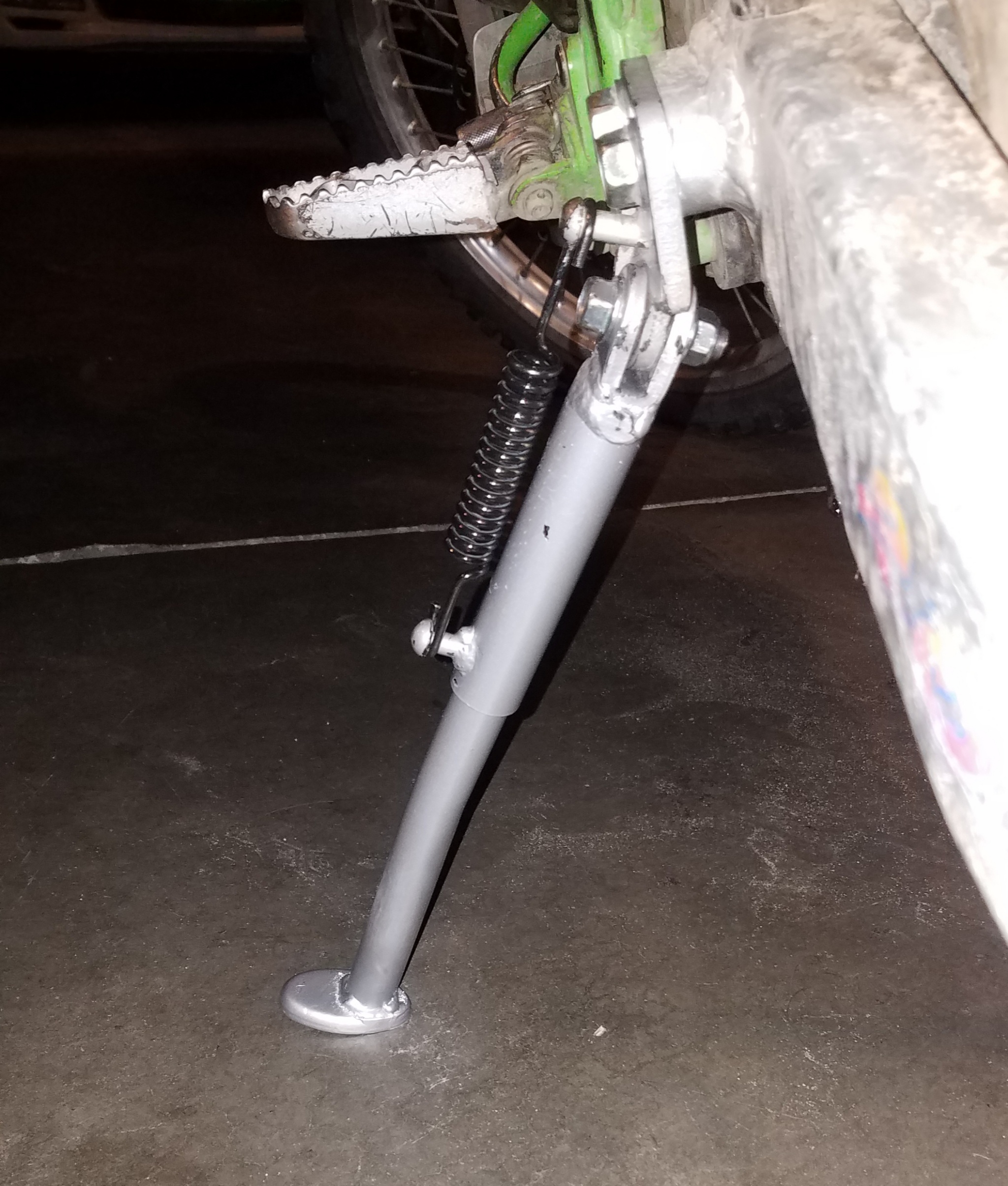

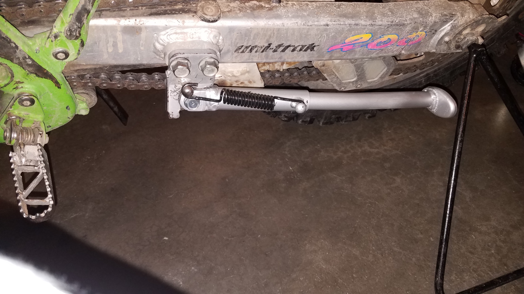

I have a 91 kdx200 that I bought missing the kickstand. I know this thread is old and dead but I kept seeing it while searching for a kickstand that would fit since they are discontinued from Kawasaki and none of the aftermarket options are offered for this year (that I could find). I hope this info helps someone else.
I bought the kickstand from the h series 1995-2006 kdx200 and put it on the e series 1989-1994. The stand part numbers are different, but the bracket part numbers are the same.
When I put it on the bike it was straight up and down. I didnt trust it not to fall over, so I ended up cutting out approx 3/4 inch off the bottom of the stand and welding the base back on.
I had to get someone at a local shop to weld it for me since I don't own a welder, but it looks great. A $4 can of spray paint later and it looks like it was ment to be.
The spring is a pain in the butt. I ended up putting pennies in between every spring coil (youtube "kickstand instal") and when that wasnt enough I put in a couple thicker nickels instead of the pennies and pryed it the rest of the way with a flathead screwdriver.
Heres pics of the finished result:
Good luck everyone!
Good luck everyone!

Yes, my dad is running my old H model kickstand on his E as well. Rumors that a RMX250 stand will also work, but they are just as rare as a KDX one lol

I was all over looking to see what other bikes would work. Decided this would be the easier route to go.
Many people complain about swingarm mounted stands but I bought a new spring with the stand so hopefully it wont be an issue.

That's a great alternative to trying to find an E model stand. Just curious - is the spring you used an aftermarket one, or is that OEM? The reason I ask is that my spring is pretty easy to take on and off, but then again, that could be because it has been used for almost 20 y/o now.

It was a brand new oem spring. I actually got frustrated with it the first day after putting pennies in between each coil and still not being able to get it onto both sides, so I left it alone. I came back the next day and it went on without too much trouble... so I am going to guess that the spring loosened up just enough to get it put on by having the pennies in it overnight.
So a 20 year old spring is probably stretched out a decent amount in comparison.
