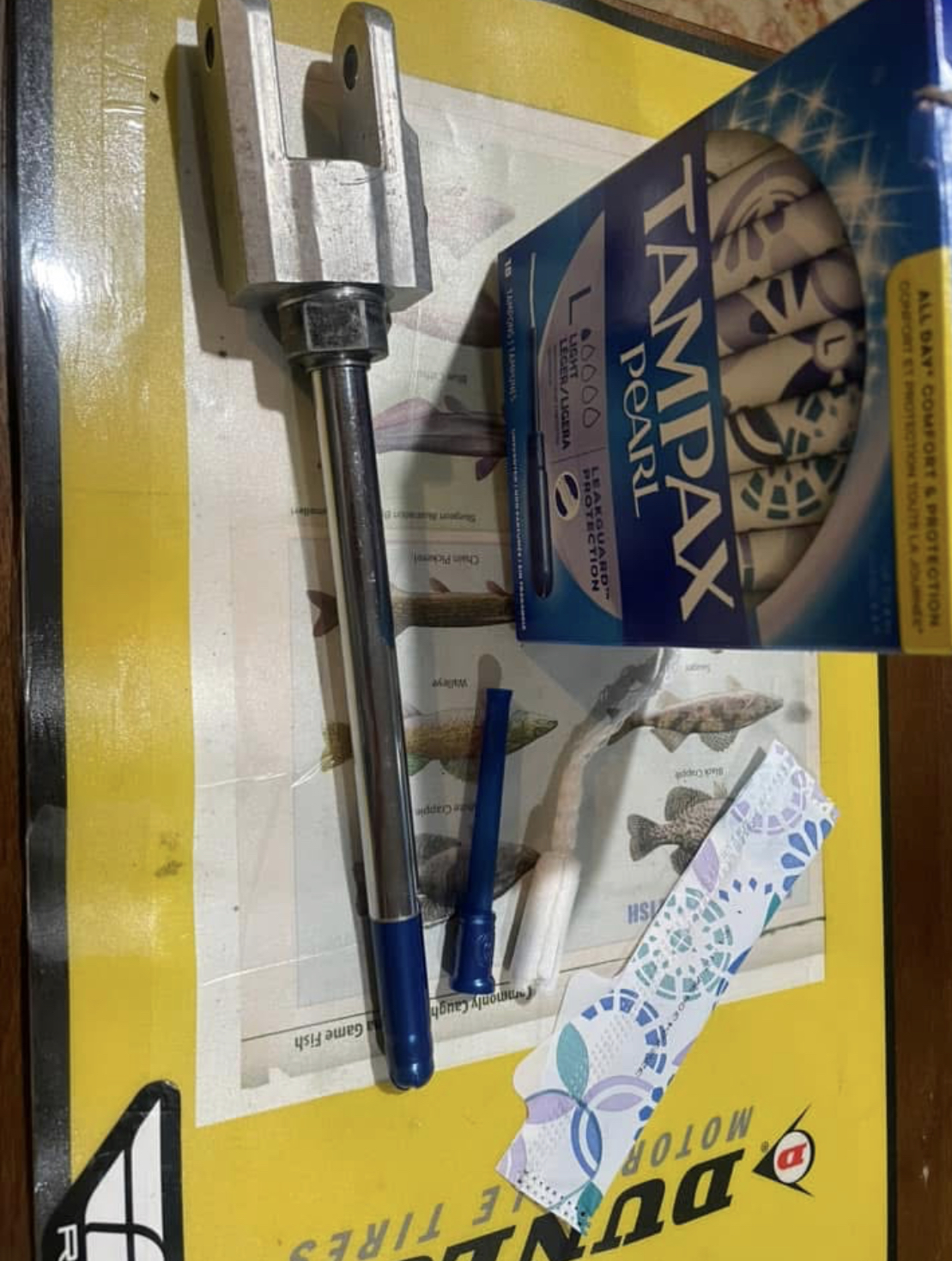

Easy diy seal bullet
Just putting this here for the next guy
Tampon worked perfectly. I heated up the end with a heat gun and threaded it on while soft. I’m proud of the discovery because I haven’t seen many improvised bullets.
