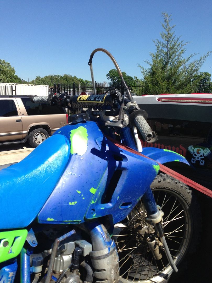

I got the bike back home and after fortifying my chain and lock situation on the fence to the backyard where the thief gained entrance I added another motion light and alarms for the garage doors.

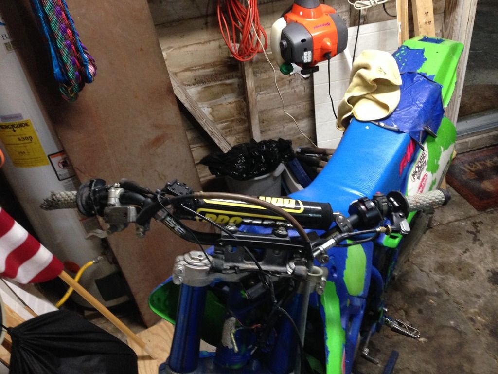

I surveyed the damage:
bent and twisted FMF pipe
broken fork leg
missing fork guard
bent handlebar
broken throttle assembly
missing Acerbis hand guard
missing aftermarket LED headlight
bent foot peg
road rashed FMF silencer
bent radiator
broken water pump cover
bent bolt on plastic governor housing
blue Plastidip on everything
assumed that they ran the 1/4 tank of premix and then refilled with regular gas (an assumption, but I guess that's worst case scenario)

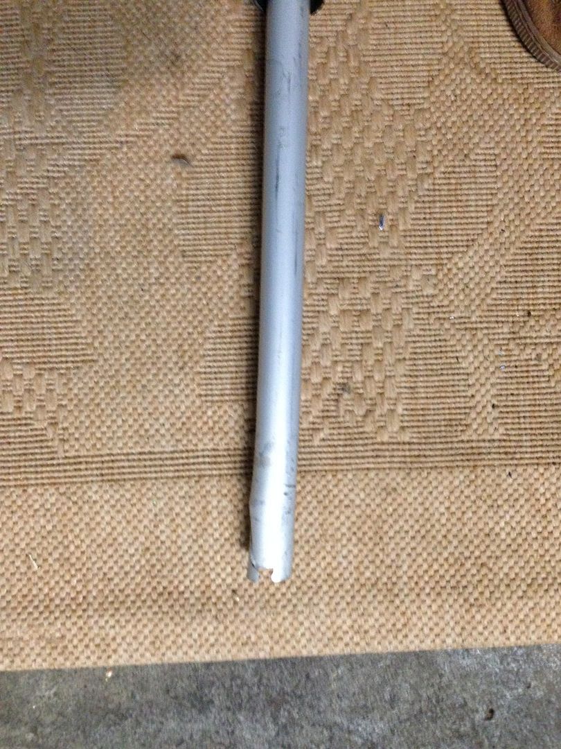

What exactly is going on with the fork leg? I've never seen a fork leg come apart like that. Is it a botched disassembly attempt or crash damage?

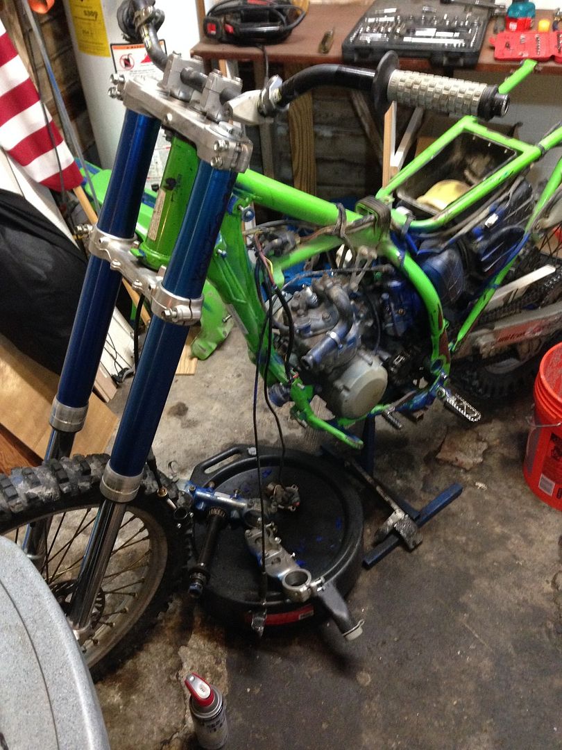

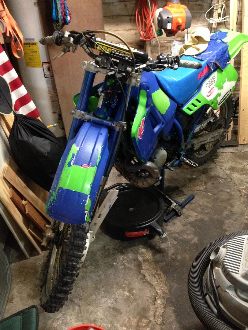

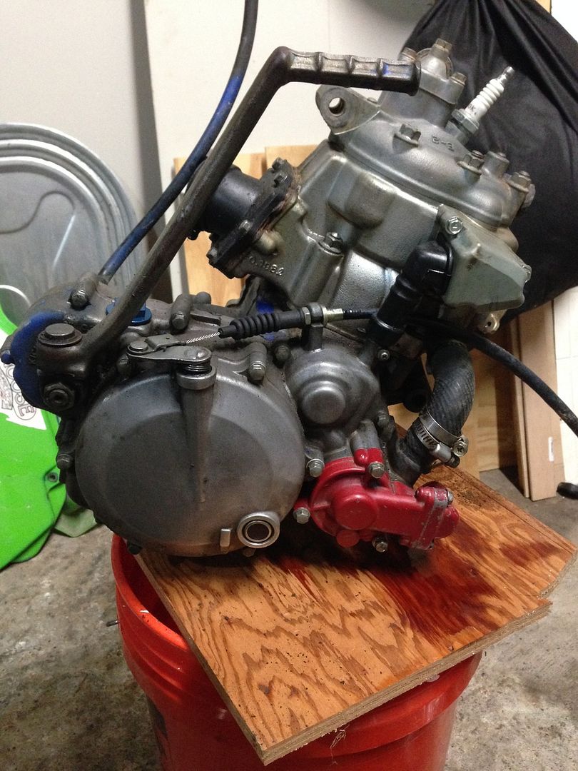

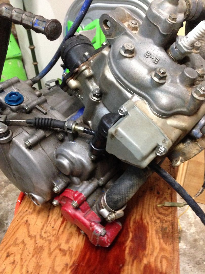

In my free time I started peeling the plastidip off and dismantling the bike.
I found a set of KDX250 forks and a new front axle bolt on ebay and ordered them.
I realized that the kdx250 forks are a larger diameter than the kdx 200 forks. I ordered a kdx250 triple tree from ebay also.
I replaced the dx200 triple and forks with the 250 forks and the front wheel bolted right in.
I also ordered a used water pump housing from ebay.
I ordered a gasket for the water pump housing and the governor housing, a new clutch handle and perch, new bars as well as some replacement bolts from Rocky Mountain ATV MC.
And I continued the tear down and cleaning process. I hate rubbing plastidip off, but I'm glad they didn't spray the bike with actual paint; that would definitely be harder to clean!

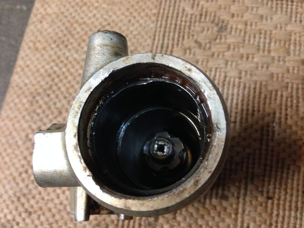

sarrant wrote:horrible.
The bottom of the fork tube broke where it was attached to the bottom casting. Moderate speed impact with a moving car did it!
You can sort of see how it tore out.

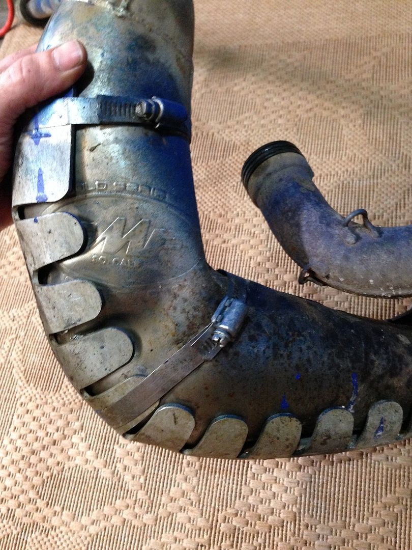

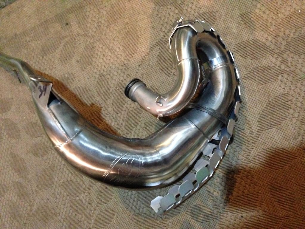

Post by jaywylie »

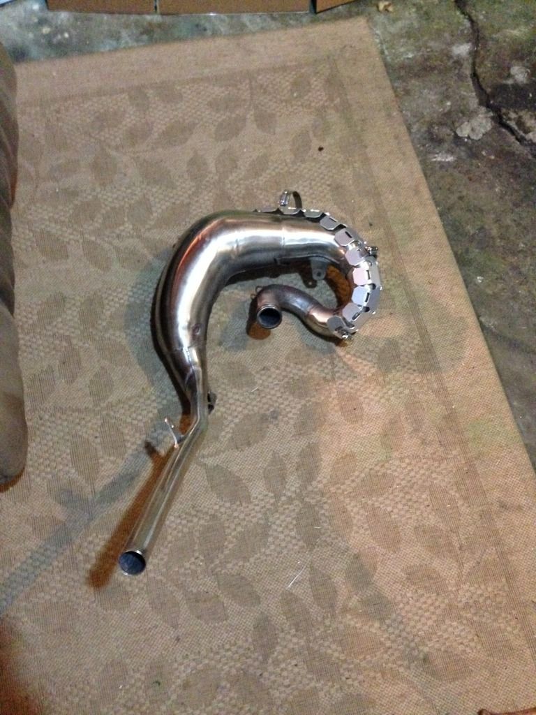

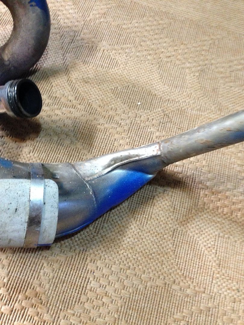

While browsing for parts online I started searching for a replacement pipe. Along the way I found a company that offers pipe repair. It was something I was interested in, so I emailed them to get an estimate. They responded promptly and quoted me $120 plus shipping to fix my pipe. This was definitely better than buying a new FMF at ~$200.
I saw on their web page that they did a contest on Instagram for free pipe repair. Post a photo and use #wreckedpipewednesday and you're entered for a free repair. What the heck, I'll give that a shot; it never hurts to try right?
I won!
http://www.piperepair.com/
Check out the pic of my instagram post near the bottom of their page!
I mailed the pipe to them last week and hopefully soon I'll have a freshly repaired pipe.
If anyone has a pipe that needs repair work done, shoot them an email and some pics. The two people I have spoken with are very helpful and friendly. From what I see on their site, they can fix some things that I would have assumed most people would consider a lost cause.

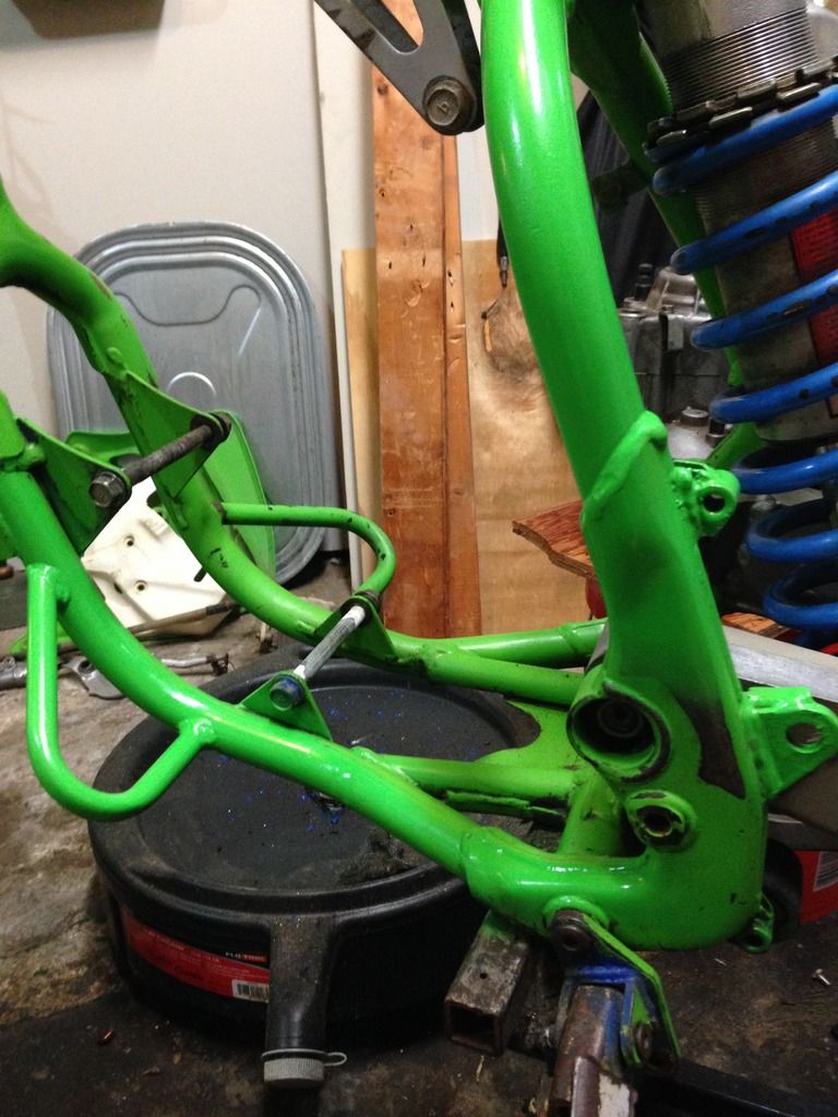

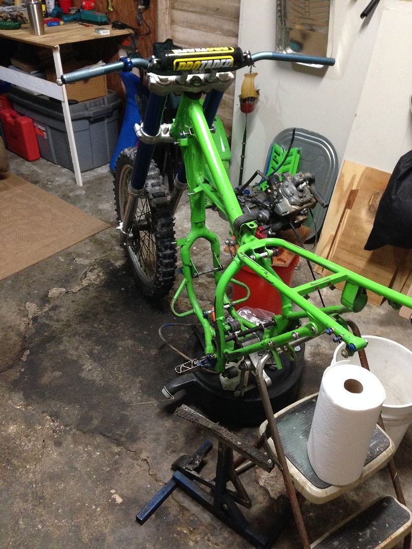

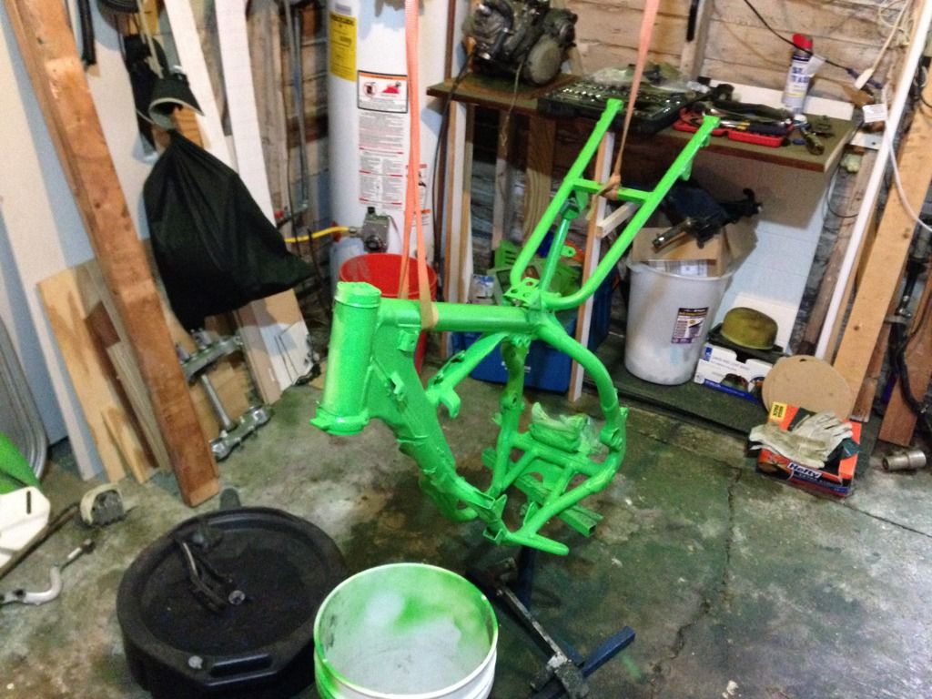

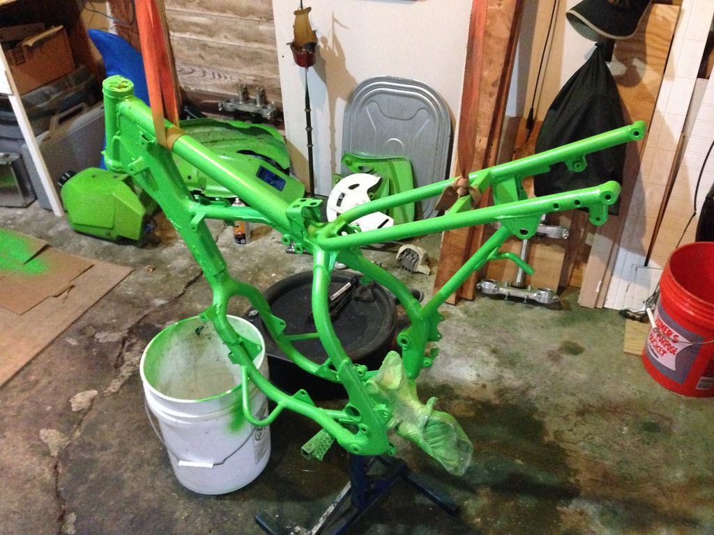

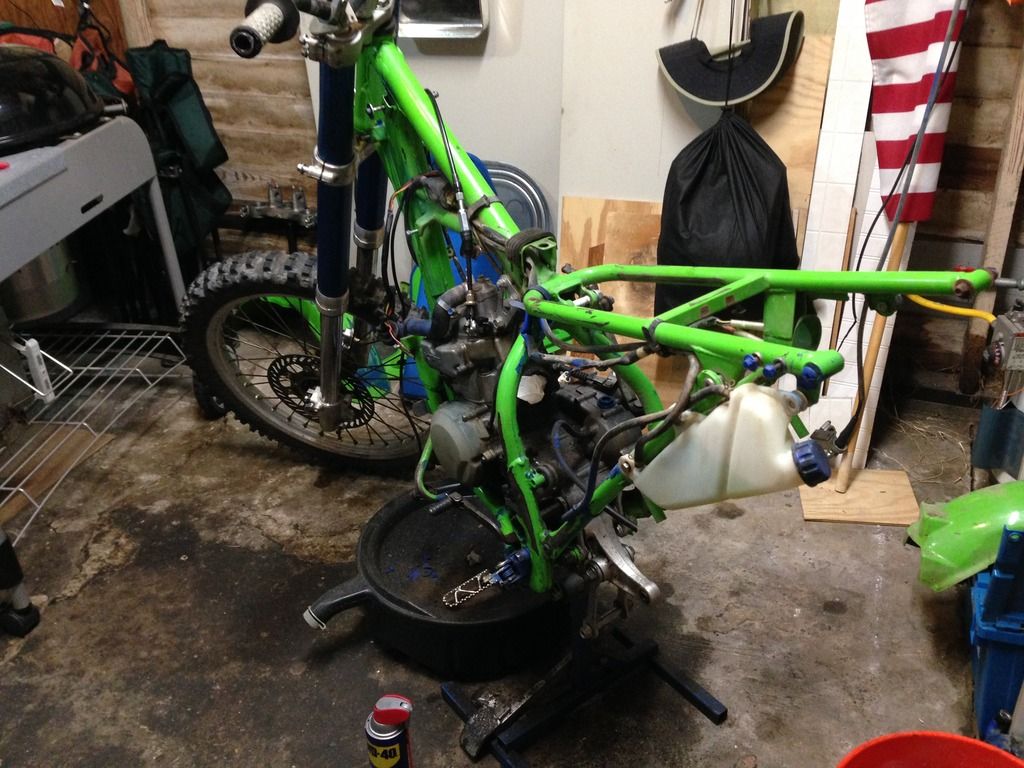

it's been a while since I updated this thread so here goes...
It's been super hot and I've been busy at work and just haven't wanted to be outside in the garage after work unless I needed to be.

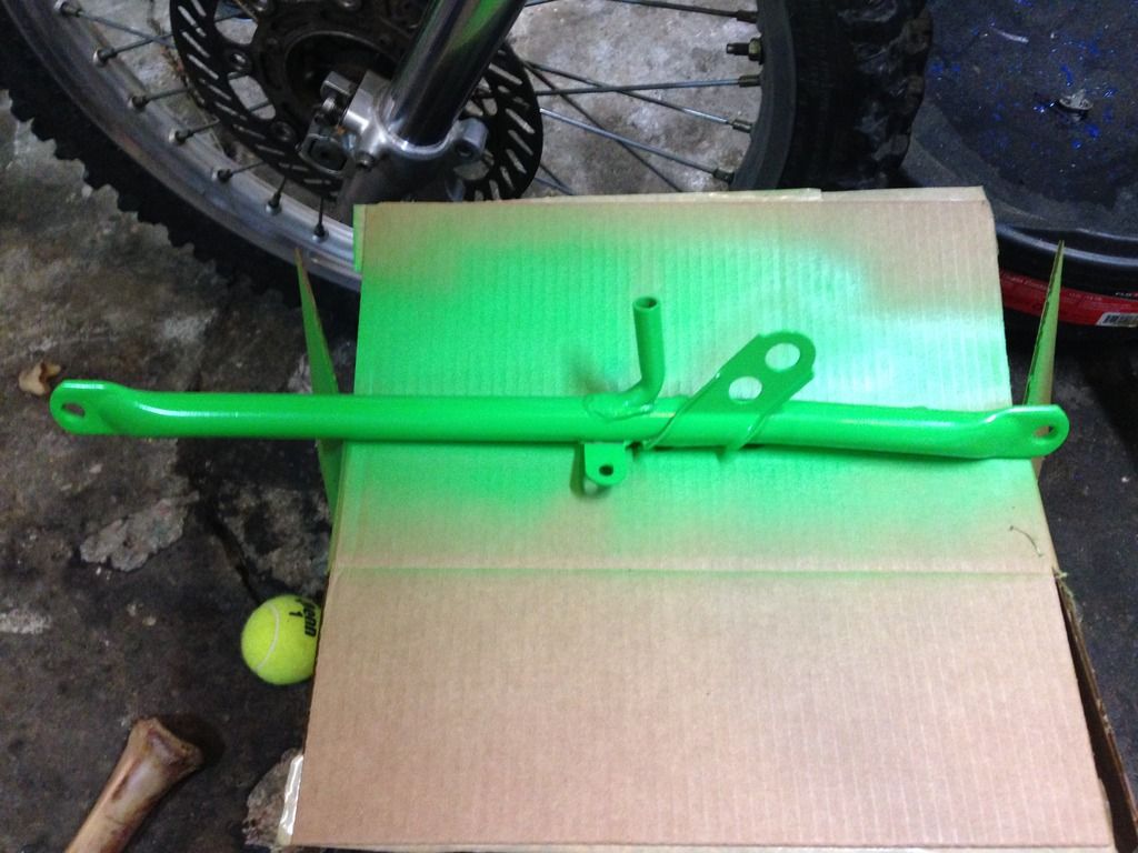

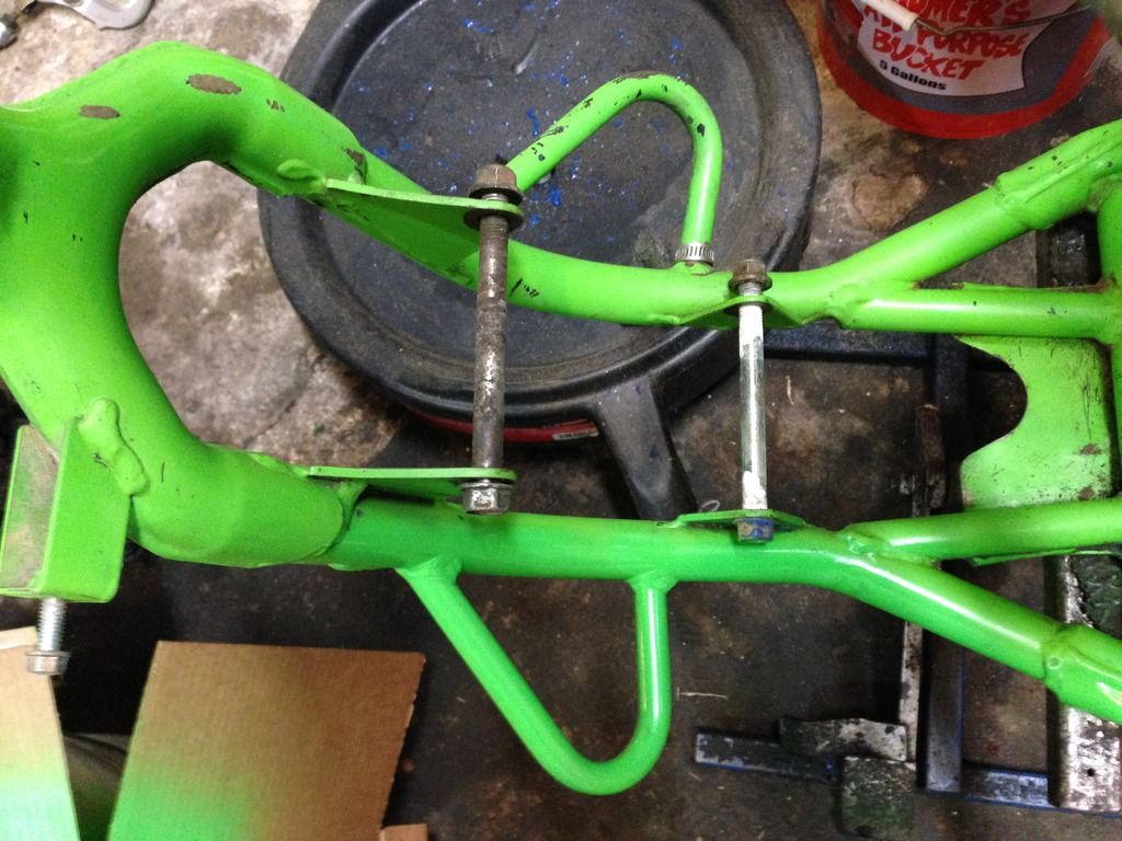

I've stripped the bike down to the frame and repainted it using VHT "grabber green" paint. Color match is close. Not perfect, but it's the best I was able to find off the shelf for a reasonable price. 1 spray can seems to have been enough to spray the entire frame and hide the areas where the paint had worn through - particularly near the footrests.

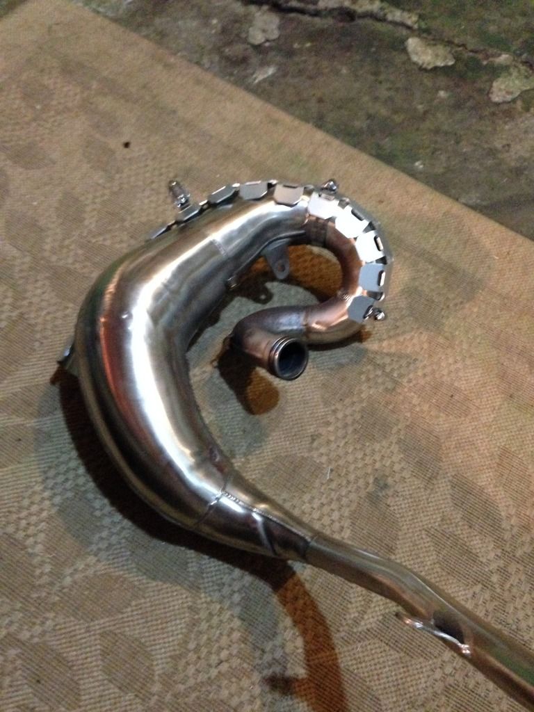

I got my FMF pipe back from piperepair.com. They did an excellent job! It took a couple of weeks from the time I shipped to them from New Orleans, LA to Oregon. They stayed in contact to keep me aware of the progress and I am truly amazed at the finished result! 10 of 10 would recommend.
I've bought some new parts - OEM and aftermarket - to throw at the bike.
new handlebars
new throttle tube
kx throttle
new handguards
new clutch lever
kdx250 forks, triples, axle
new headlight housing
new front and rear wheel bearings
new front and rear brake pads
new air filter
new chain
water pump housing
gaskets, hardware, etc...
So I'm letting the paint dry and plan to order a few more parts, like new tires and tubes, refinish the swingarm, decide on a graphics kit, re clean everything well, reassemble, and FINALLY RIDE AGAIN!
I've missed out on this summer, but the weather hasn't been great on my days off, so I'm looking forward to riding when the temps drop just a little and it doesn't rain for weeks on end!
