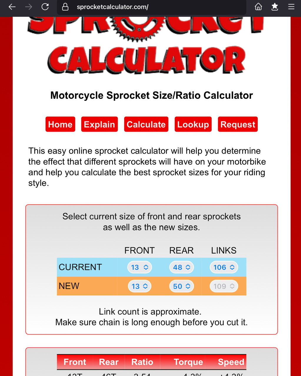

Well, while we’re on the topic here’s a great sprocket calculator resource for figuring out what you want gearing wise…
https://sprocketcalculator.com/
