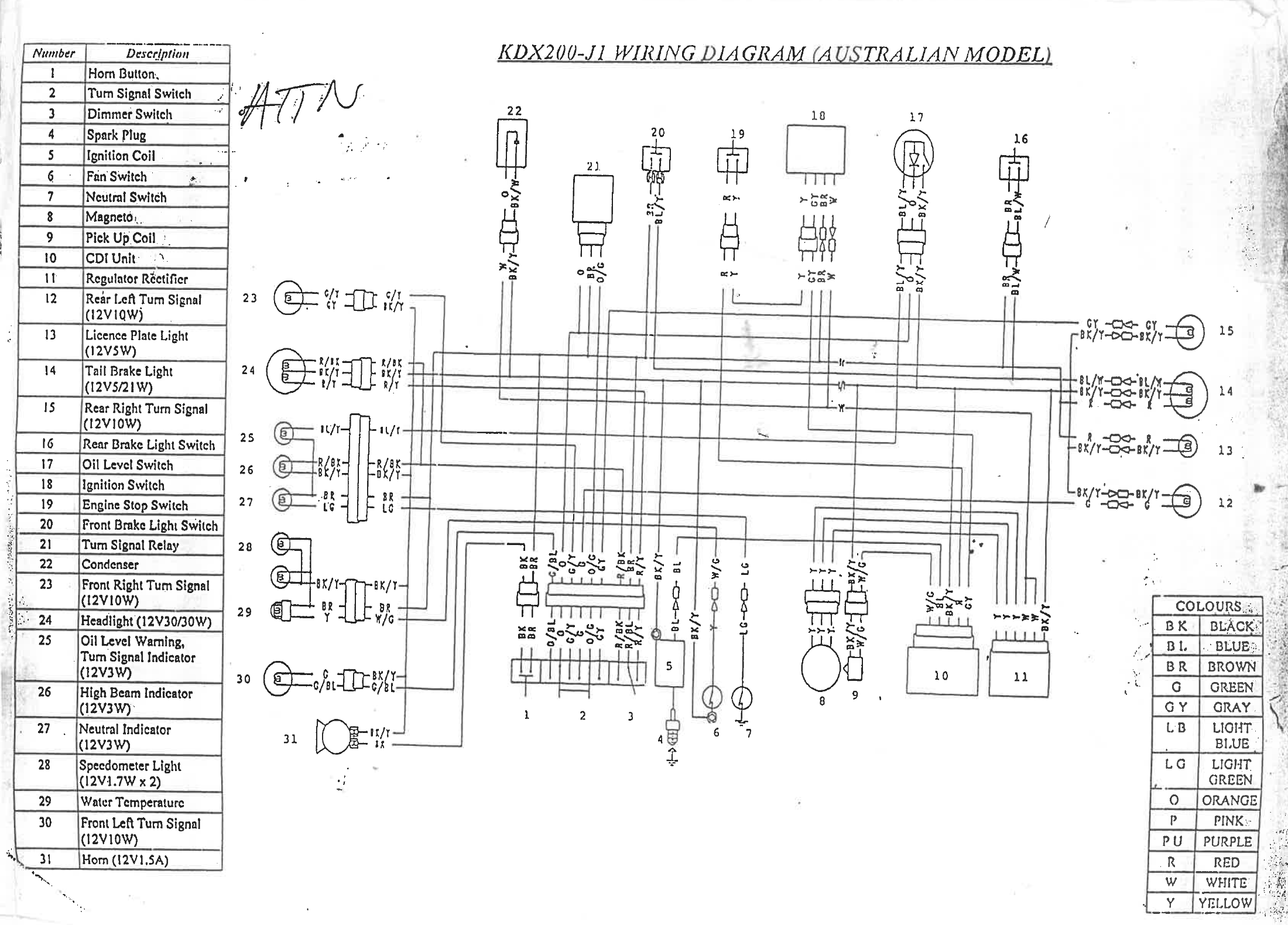

This is what I have atm, I had to change all the white wires to pink so they'd show up. From what I can tell this is similar to factory set up as all the wire colours are matching. I'm still unsure about the two white (pink ones coming out of the reg though).
If I connect the two white wires together without connecting to the key I lose spark.

OK, so there are 2 magnetos in the KDX, one for the CDI and one for lighting ("the lighting coil") From the drawing that you have there, somehow they are connecting together...I don't think that is correct at all. Seems the Green wire should go to the Key switch, then to the CDI. It seems as though those Pink wires are powering your CDI instead of the (intended) Green wire.

old thread but just to keep all relevant AU road legal wiring stuff together, the rectifier/regulator in an sh548-12 unit and its used across the kawasaki range using the oem numbers 21066-0027, 21066-1052 and 21066-1038. the 3 versions appear to be interchangeable and are used on these models -
the klr600 is prolly the best reference to compare to the AU models that i have been able to find,
the internal wirhing of the R/R os below and consistant with the kdx and klr schemes.
consistant with sammys comments there does need to be 12v wired to the sensing terminal for the regulator to run, here is the internal circuitry of the r/r.

The correct wiring diagram for the Australian models is here for future reference. I am currently having a few issues with mine also.
