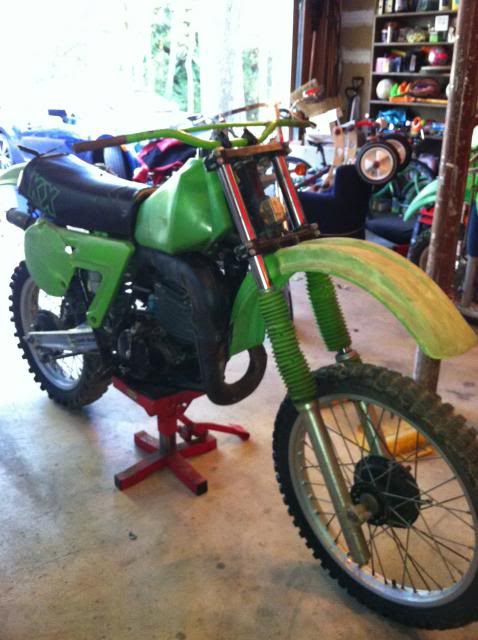

I parked the bike near some club members and made it two tables into the swap meet before dropping $10 on a Kawasaki C-series KDX service manual. Sweet. I moved one more table in and saw this.
Oh, boy.
The seller said that it belongs to his buddy, who rode it up until a few years ago. He had been meaning to reassemble it, but was just never going to get around to it. It's mostly intact, with a tub of the removed parts included. It also had a nice seat up until that morning, when it blew out of the trailer and got run over. It was surprisingly clean, appeared to have been stored out of the elements, and the bin of parts really did include everything (except a front number plate) All in all, it's about a 1000% better starting point than my '83 was.

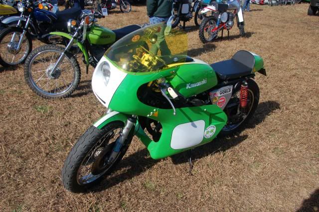

I lingered for a few minutes and then wandered the rest of the swap meet. Lots of cool stuff to see.

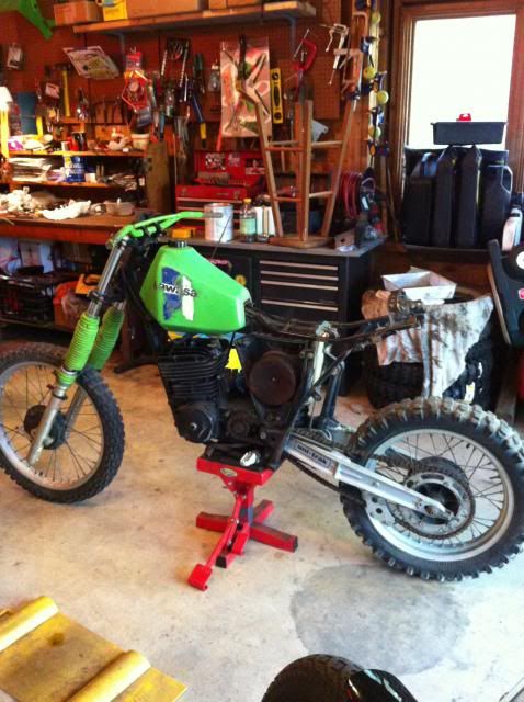

First things first. Time for a detailed survey.

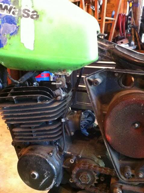

We have an intact air box with a good usable air filter. This is a plus. The intake boot on the box is not cracked, but the manifold on the cylinder is a little dry. Not too bad, however.
Hard to tell in the pic, but the piston is pretty scuffed. Good feeling compression, though.

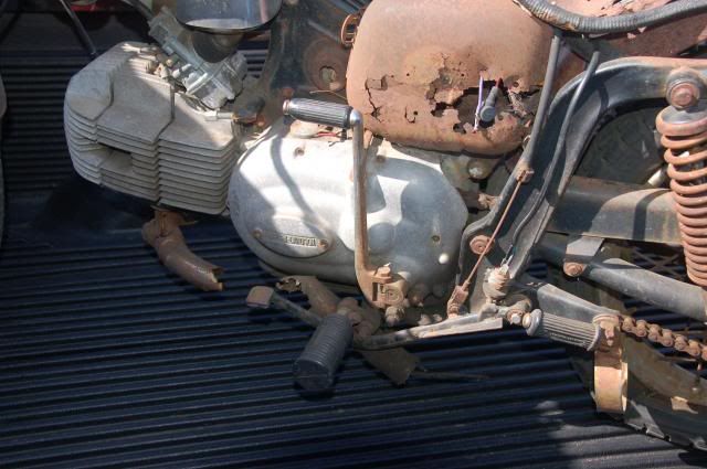

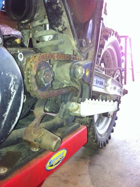

Neato aluminum peg on the shifter side.

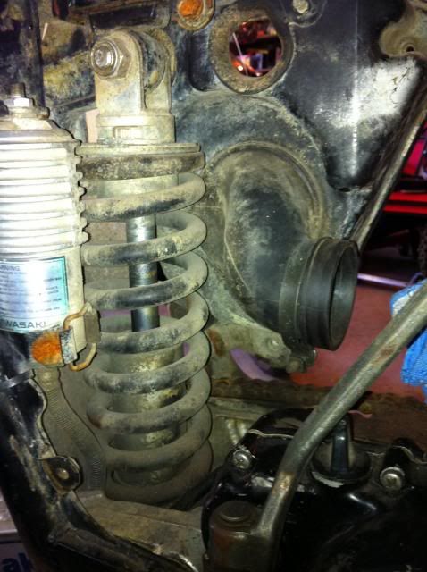

Dirty shock with oil on the shaft. Will need a rebuild. Beefy shock, though.

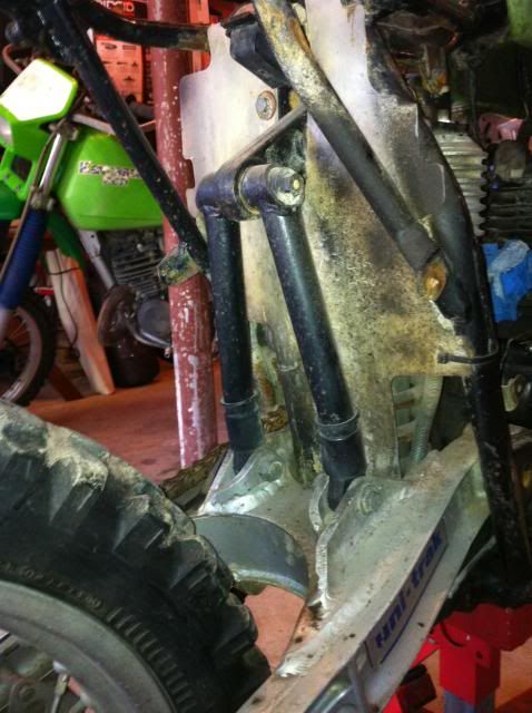

Linkage has no vertical play (woot!

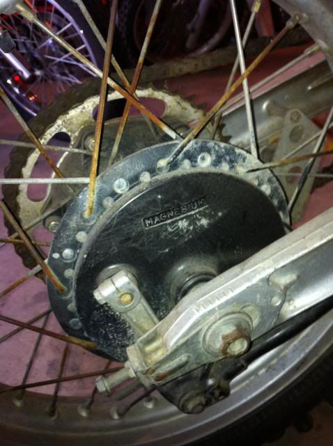

Functional rear brake. Lots of slop in the pedal, so we'll have to see what's up with that.
The right peg is droopy, so we'll have to either get a better peg or build up some metal to get it sitting level again.

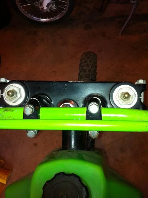

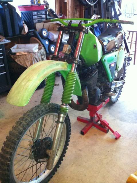

The non-original bars are bent, but the triples, fork tubes, and caps are all pristine.
The tires are toasty. Loving my new neon sign, too!

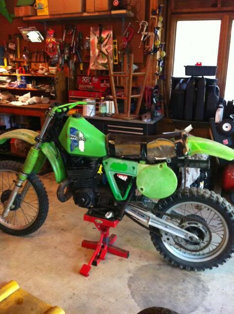

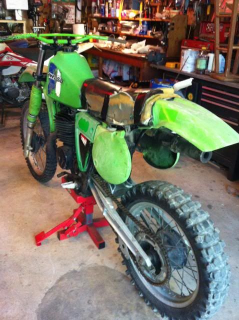

I positioned the included plastics and pipe to get a feel for the bike.
Non-original silencer.

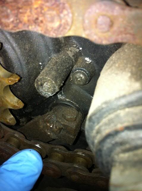

Here's trouble. The shifter is welded to the shift shaft. The bike shifts okay when rolling it around, so hopefully I can get away with this for a while. At least until the cases need splitting.

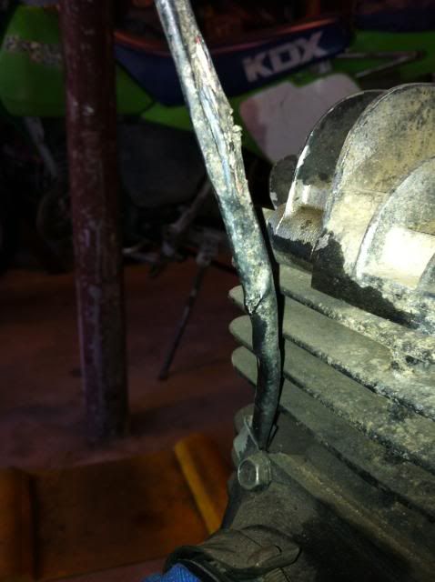

The wires from the stator are a little crispy from contact with the pipe.

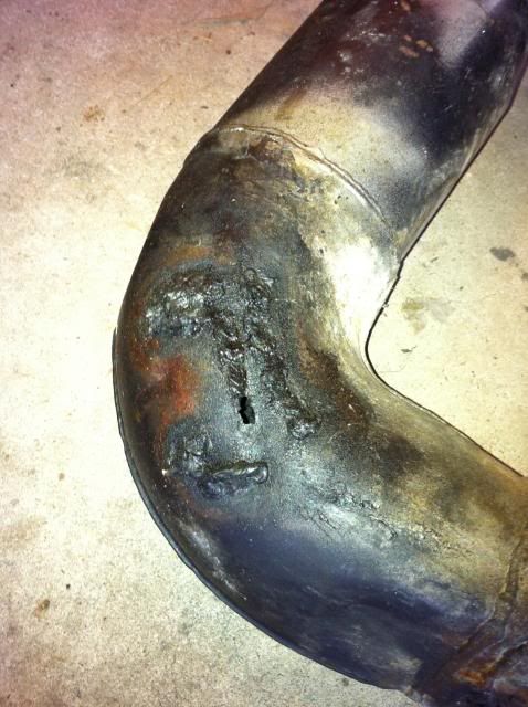

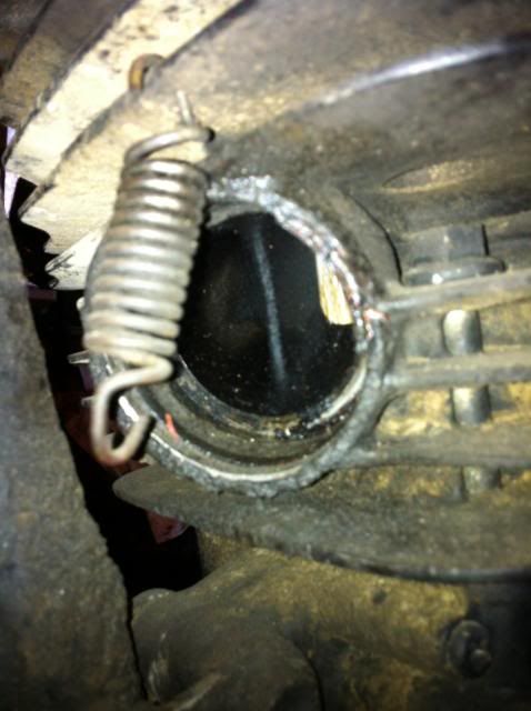

And here's the most pressing immediate problem with the bike, and probably the reason it was disassembled. The mount bracket for the pipe has broken off multiple times, and there's a hole. The bike was obviously run with this hole for a while, as evidenced by the burn mark on the front fender. Also, the hole where the pipe mounts to the frame is all ovalled out. I'll need to do a little welding to get the pipe mounting sorted out.
I tested the spark, and got a good blue zap. More good news.
So what do we have here? It's my first open classer, and it's a bike that kawasaki sold for only two years ('80-'81). There is not very much info on the web about these bikes. It was Kawi's very first Uni Trak setup. I'm reading mixed reviews on its performance--some say that it has a decreasing rate built into the linkage, which results in not great action. Others have said it works well. The motor is supposedly not particularly strong, and the frame is supposedly prone to cracking. I read a horror story from an ex-pro racer who received two of these bikes in '80 and had nothing but trouble from parts breaking. I'm hoping that a slow recreational rider won't result in broken parts. There are some parts available, like used shift shafts and reproduction plastics, but not too much.
I plan to repair the pipe situation, disassemble and lube the linkage, rebuild the shock, slap on some tires and see what it's like to ride. This will be a winter project, like the '83 was, so stay tuned for infrequent updates!

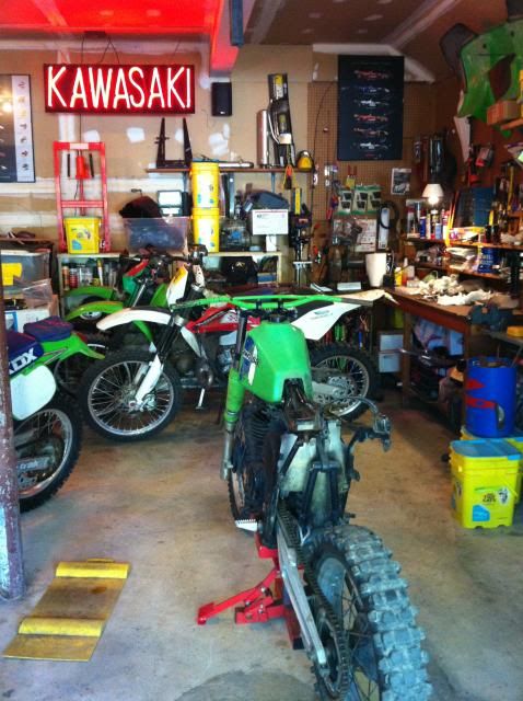

Yes, the garage is starting to look a lot like a Kawi dealer from the '80s.

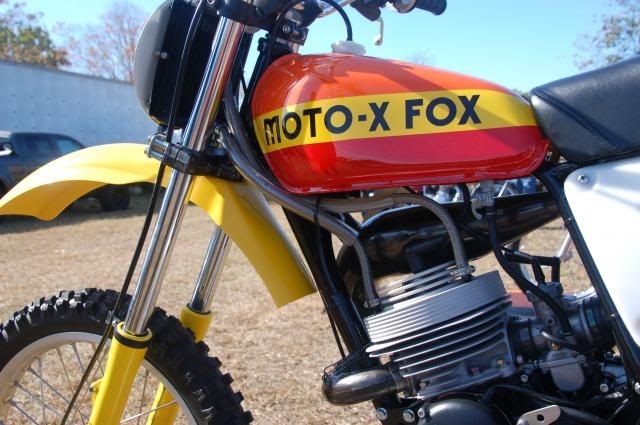

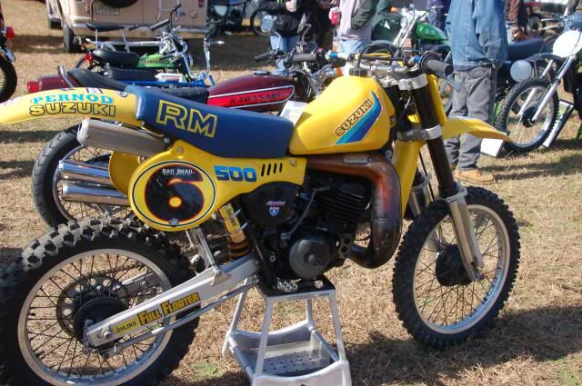

Man,some sweet stuff there!!! The full Ohlins RM500 is pretty rad. Nice pristine H-Bomb as well!!! :supz:

Not too much happening with the 420 build. I've tried burning all the spooge out of the pipe with our gas grill and chiminea, but couldn't get it hot enough. I also tried a propane torch blowing through the stinger, but again not hot enough. I can't build a bonfire in our neighborhood, so I'm waiting until my club's enduro. We always have a big bonfire. Once the pipe is thoroughly degreased, I'll patch the holes and redo the mounting.

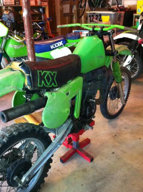

I also snagged a nice seat on fleeBay. It's for an '80, so the KX on the side is white instead of green. (Don't tell the concours judges!!)
Honestly, there's not a lot the bike needs to be ridable. Once the pipe situation is fixed, I'll piece it together and get it started. With video, of course! After that, I'm thinking a tear down to paint the frame and motor, new shock head seal, new plastics, new tank graphics, fork boots (or seal savers), tires, grease up all the bearings, and I'll have a pretty sweet vintage open classer! I also found an OEM NOS silencer on the Bay. That would look nice...
