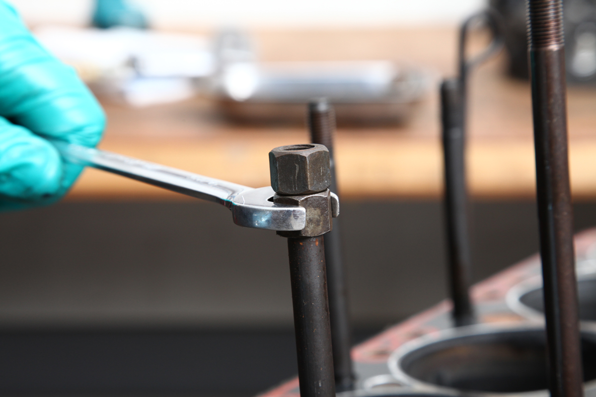

And one other thing, what the best way to remove the studs from the cylinder?

I use the double nut method to pull the studs or you can purchase a stud remover from Snap-on or one of the better tool suppliers out there. If you use the double nut method I suggest going to the hardware store to get some Grade 8 nuts to use instead of the ones used on the bike. This way if you end up damaging them it isn't a big deal. If you damage the factory head nuts then you would have to order new ones from Kawasaki.
